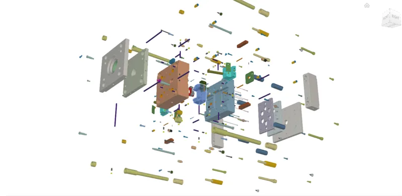

The banner image above is the mold for the smaller bottom part of our new portable monitor, AirGradient Go. Yes, it’s all for that very small blue part in the middle of the exploded view! Every plate, pin, spacer, and screw is pulled apart so you can see how the tool is built. I think this view really shows what exactly makes injection molding both fascinating and unforgiving.

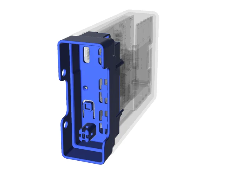

In case the blue part is too tiny in above view, here is the actual plastic part that this mold produces.
The bottom part of the AirGradient Go Portable AQ Monitor.

Exploded view of the AirGradient Go Mold (bottom part)
Most molds have two main halves. The A-side is the fixed half mounted to the stationary side of the injection machine. It’s on the left side of the exploded view above. The B-side is the moving half that opens and closes every cycle.
Inside those halves are the two surfaces that form our part of the AirGradient Go. The cavity typically forms the outside (the cosmetic surfaces you touch and see). The core typically forms the inside features (ribs, screw bosses, and all the hidden geometry).
Where A and B meet is the parting line - the seam you sometimes see on plastic parts. Parting line placement affects appearance, flash risk, and how complicated the tool needs to be.
If you look at the AirGradient Go exploded view, you can already read some of this structure even without labels. The larger grey plates at the outer ends are part of the A-side/B-side stack that bolts into the injection machine. The more intricate blue-grey block in the center is where the core/cavity plates and inserts live - the region that actually creates the bottom shell’s shape.

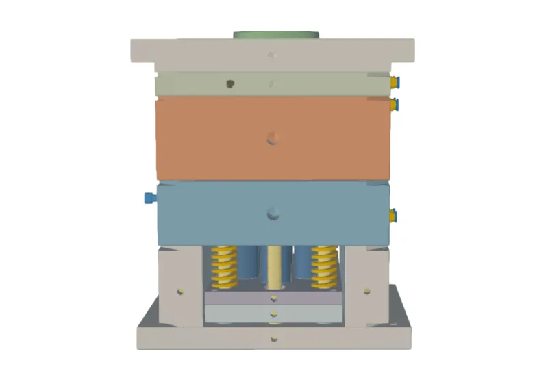

The mold is a stack of plates
A common beginner assumption is that a mold is just two chunky blocks of steel. In reality, it is a stack of plates, each doing a specific job.
There are plates that clamp the tool into the machine. There are plates where the part geometry is machined. There are support plates whose job is simply to keep everything stiff and flat under pressure. There are spacer blocks that create room for mechanisms to move. There are plates that carry the ejector system.
The mold from the outside. Easy to see the different layers.
In the AirGradient Go tool, you can see that “layering” very clearly: big grey plates acting as the structural backbone, the central blue-grey assembly where the part-forming surfaces and inserts sit, and the “cloud” of hardware around it that makes the whole machine repeatable.

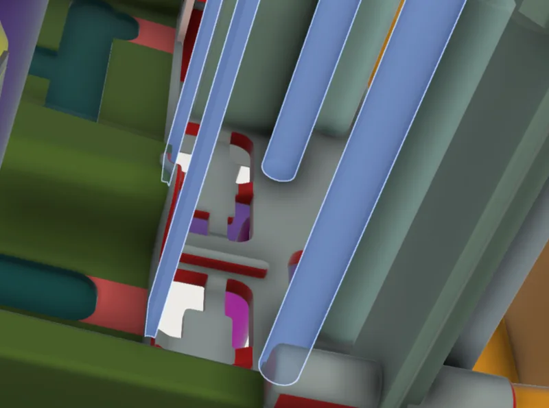

What are all the pins for?
In the AirGradient Go exploded view, the most eye-catching components are the many long, thin rods scattered around the assembly. Those are primarily ejector pins.
When the tool opens, the part usually sticks to the B-side (core side). That is normal - the plastic shrinks onto the core as it cools. Ejector pins push the part off the core so it can fall out cleanly.
This is one of the places where “simple part” becomes “complicated mold” very quickly. Every pin leaves a tiny circular witness mark. You cannot eliminate them - you can only choose where they are acceptable. That turns ejection into both engineering and industrial design. You try to hide pin marks on the inside, on ribs, or in areas the user never notices. And you need enough pins to eject without bending the part, creating stress marks, or damaging delicate features. For the AirGradient Go we placed the pins on the inside of the enclosure. So you should not be able to see them.
Here you see in blue marked some of the ejector pins. And in grey the actual plastic part of the AirGradient Go.
Ejection also needs to reset perfectly. That is why molds include return systems so the ejectors retract before the next shot. In an exploded view like ours, that whole ejector system shows up as a set of plates plus a surprising number of pins, spacers, and fasteners - all in service of reliably releasing a single plastic part.

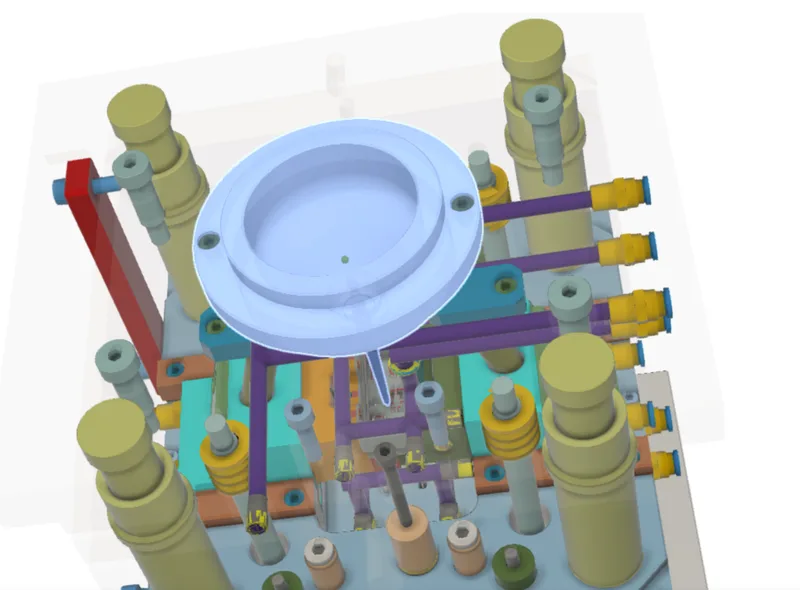

How the plastic gets into the part
Somewhere in the A-side (left side on the exploded view) there is a green sprue bushing, the entry point where the injection machine nozzle pushes molten plastic into the tool. From there, plastic flows through runners and then through a gate, which is the final narrow passage into the part.
Gate placement is one of those decisions that affects almost everything. It influences aesthetics (a small gate vestige), strength, how well the cavity fills, and where you might get weld lines or flow marks. In our “lessons learned” post, we talk about why reviewing the complete mold 3D is so important - gating is one of the things you want to see clearly before steel is cut.
Marked in blue the plastic injection bushing and gate.
For AirGradient Go’s bottom shell, the goal is straightforward: fill consistently, avoid cosmetic trouble on the outside surfaces, and keep the part stable so it fits the rest of the enclosure precisely.
