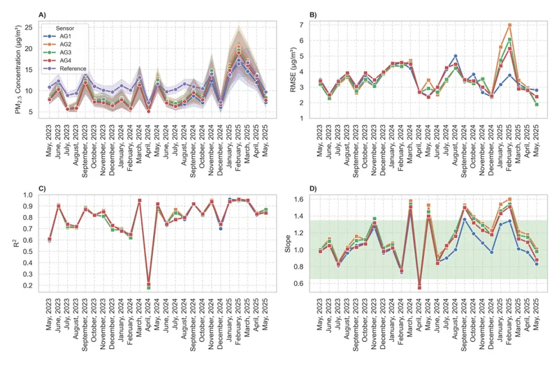

London, UK.
In London, the average reference concentration for the two-year study period was 11.3 ug/m3 (Fig. 2), with 52% of measurements below 10 ug/m3. The precision among the four AG sensors was excellent, with a coefficient of variation of 6.1%.
Fig. 2\. Performance of AirGradient sensors in London from June 2023 to June 2025\. (A) Monthly average concentrations, (B) RMSE stability, (C) R2 stability, (D) Slope stability.
Fig. 2. Performance of AirGradient sensors in London from June 2023 to June 2025. (A) Monthly average concentrations, (B) RMSE stability, (C) R2 stability, (D) Slope stability.
The RMSE values stayed below the EPA target value (7 ug/m3) throughout the entire study, ranging from 1.9 to 7.0 ug/m3, indicating high accuracy. R2 values averaged 0.80 across all sensors without systematic drop or grow. The average slopes for AG1-AG4 were 1.2, 1.1, 1.1, and 1.1, respectively, with nearly all values falling within the EPA recommended range (Fig. 2).

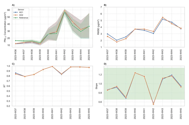

Chennai, India.
In contrast to London, Chennai exhibited substantially higher PM2.5 concentrations, averaging 26.8 ug/m3, with no measurement below the detection limit (Fig. 3). The AG sensors demonstrated excellent precision (CV = 1.1%), high accuracy (average RMSE = 3.5 ug/m3), and strong correlations with the reference (R2 = 0.91). The average slopes averaged 0.96 for both sensors, with only one week dipping slightly below the EPA limit (Fig. 3). No temporal trends were observed for all of the performance metrics, indicating absence of systematic drift even at high concentrations.
Fig. 3\. Performance of AirGradient sensors in Chennai from September to November, 2023\. (A) Monthly average concentrations, (B) RMSE stability, (C) R2 stability, (D) Slope stability.
**Fig. 3. Performance of AirGradient sensors in Chennai from September to November, 2023. (A) Monthly average concentrations, (B) RMSE stability, (C) R2 stability, (D) Slope stability.
