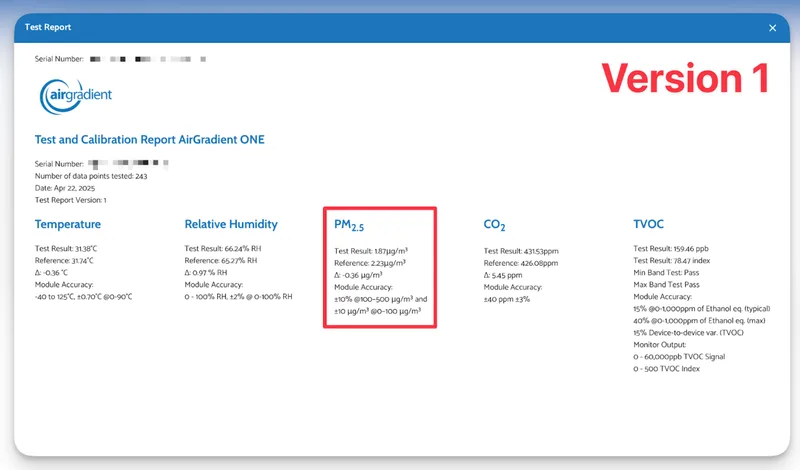

Alongside this individual testing, we’ve also rolled out a new version of our test reports. If you’ve purchased a pre-built AirGradient monitor before, you’ll be familiar with the older reports, which looked something like this:
Those reports included a PM2.5 section showing how the monitor performed during testing compared to the reference. While this confirmed the sensor was functioning correctly, we didn’t apply device-specific calibrations. Instead, we verified the sensor, applied the batch-specific calibration, and shipped the monitor after confirming that it was performing within spec.

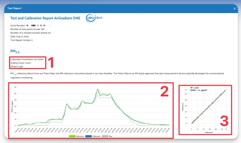

From this month, all pre-built monitors now ship with a more detailed V2 test report. This updated version shows exactly how the raw readings from your monitor correlated with the Palas Fidas reference. Using that data, we calculate a unique scaling factor for each sensor, which brings its accuracy in line with the reference. To make the improvement clear, the report also plots the calibrated data on the same graph.
In addition, we now include a scatterplot comparing the calibrated AirGradient readings with the Palas Fidas. Because the calibration is derived directly from the reference, the two sets of data align very closely — typically with a low average error (RMSE). Once those correction parameters are defined, they’re applied to the device before it leaves our factory. This means that every pre-built AirGradient monitor arrives pre-calibrated and is ready for installation.
So far, we’ve seen no evidence of drift in the Plantower PM2.5 sensors we use, which means this calibration should remain valid over the sensor’s lifespan. Note, however, that the calibration parameters might well change depending on the aerosol characteristics (size distribution, chemical composition; see also here). Therefore, the gold standard for sensor calibration is with a reference instrument at the deployment site under local conditions.
