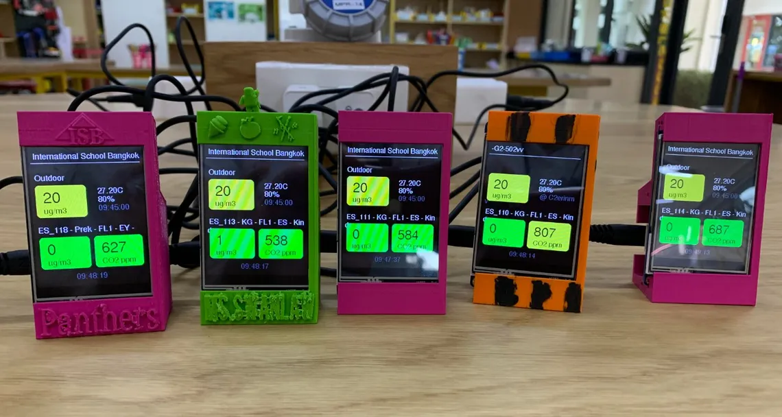

Above is how teachers and students from the International School Bangkok customized the display enclosures for their school.

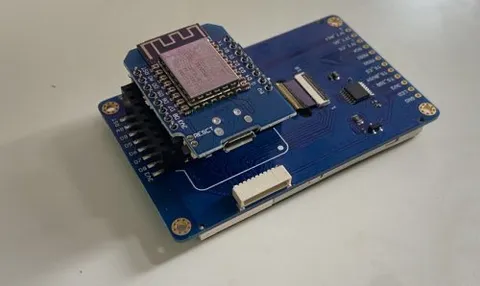

Components
You just need to get two components:
- Wemos D1 Mini approx. USD 2.00
- Wemos D1 Display USD approx. USD 10.00 (often unavailable)
Soldering
The only soldering work you need to do on this project is to solder the pins onto the D1 Mini. Please make sure you solder them the correct way by comparing the labels on the display with the ones on the D1 Mini. You can also use the display pins as holder during the soldering job.
