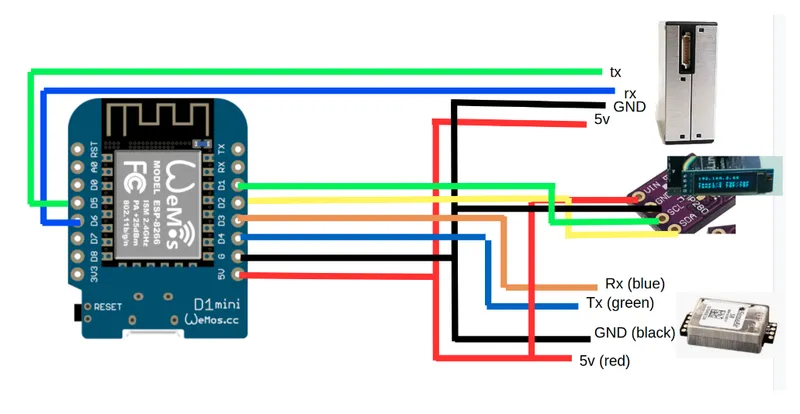

Schematics
You can use the following schematics:

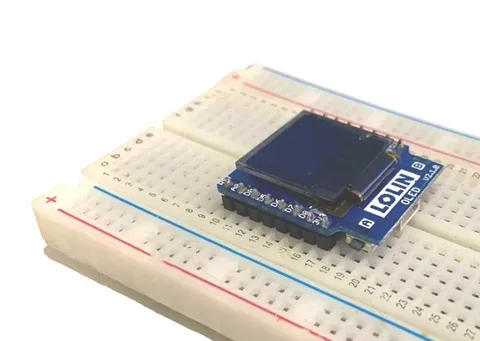

OLED Display Soldering
If you have a breadboard on hand, we recommend that you fix the pins with the breadboard to ensure that they are straight as shown in this picture.

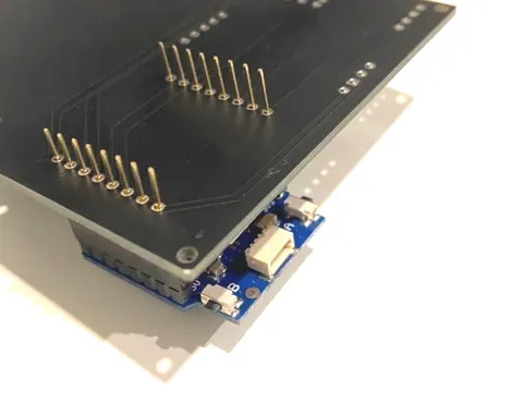

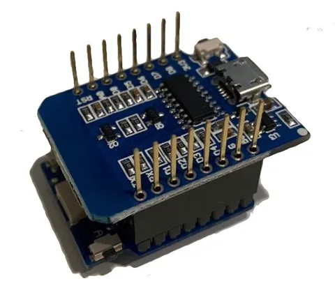

D1 Mini Soldering
Put the long female and male pins through the D1 Mini. Make sure that the female parts are on top of the D1 Mini as shown in this picture:
Then connect the freshly soldered OLED display into the female pins to better hold them in place. Then take the D1 Mini with the OLED display attached and turn it around and solder the pins onto the D1 Mini.
D1 Mini Soldering Onto PCB
The next step is to solder the D1 Mini onto the PCB. Please make sure you solder it the correct way. The Micro-USB port needs to face outwards. You can also compare the pin labels on the PCB with the ones on the D1 Mini. You can either solder the D1 Mini directly onto the PCB or use the pin headers as a socket. If you solder it directly, please leave a small gap between the PCB and the D1 Mini to make sure the plug is accessible.

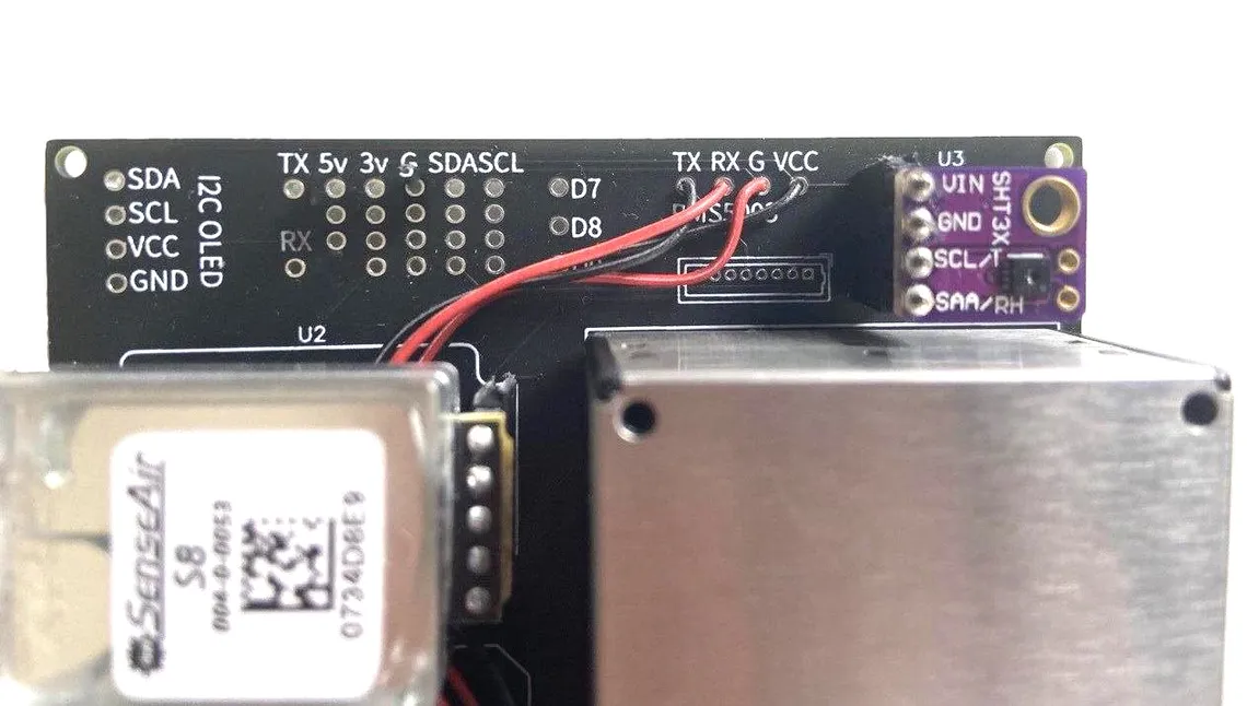

Soldering The SHT30/31 Module (Temperature and Humidity)
To solder the small pins onto the SHT30/31 module, you can again use a breadboard to fix it in place.
Then put the SHT30/31 module through the corresponding holes on the PCB and solder it onto the board. You only need to solder the four pins. No need to do anything with the two pins on the top of the sensor.

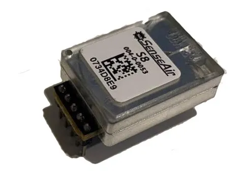

Soldering The Senseair S8 Module (CO2 Sensor)
To solder the small pins onto the S8 module, you can again use a breadboard to fix it in place.
Please make sure that the pins face downwards as can be seen on this image.
Then solder the CO2 sensor onto the PCB. It is important that the bottom side of the CO2 has enough air flow. So make sure the gap is sufficient. It might be a good idea to put it on a female pin socket but you can also solder it directly. You can use the pin that came with the D1 Mini but you need to cut them down to the required length.

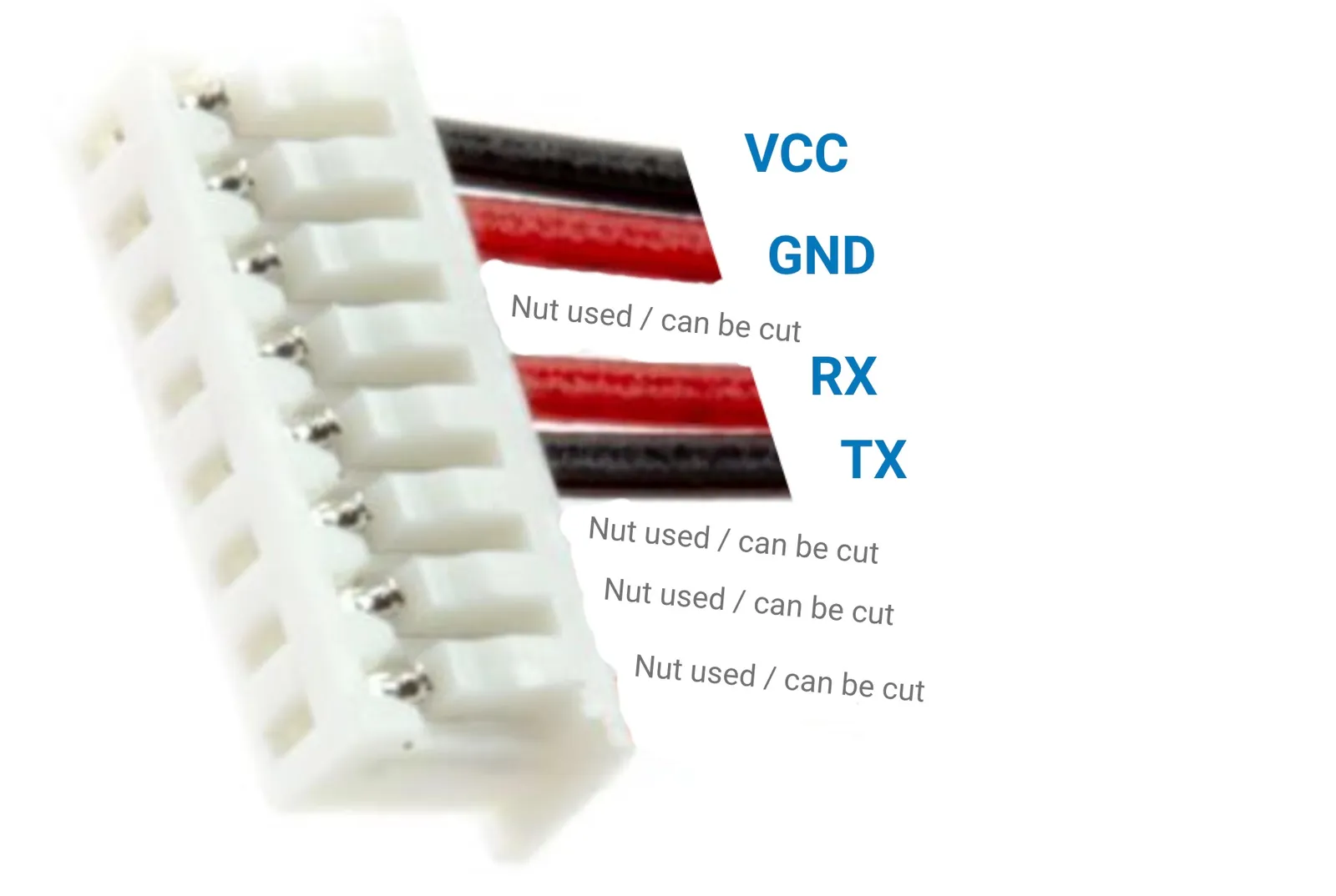

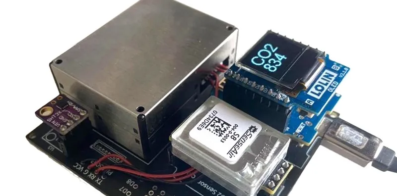

Normally the PMS5003 comes with a cable. As we will solder one end of the cable directly onto the PCB, you can cut the connector off one end of the cable. Then prepare the following four wires as per this image. Please make sure you cut the correct wires.
Then solder the cable onto the PCB. Make sure that you solder the correct cable to the correct pin.
After you have soldered the cable to the PCB, connect the PMS5003 with the other end of the cable. Then screw the PMS5003 onto the PCB or use double sided tape to fix it in place.
Done & Enjoy
