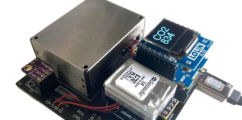

CO2 traffic lights are often used in classrooms around the world as an indicator when it is important to ventilate the classrooms to reduce the COVID-19 transmission risk. So this built especially addresses the needs for schools and enables them to build a powerful, accurate CO2 traffic light for a much less cost than commercial sensors (that often do not even have WiFi capabilities).
This build uses the Senseair S8 NDIR CO2 sensor that has a high accuracy and is also used in much more expensive professional grade sensors.
We offer schools who buy our CO2 traffic light kit, one year premium access to our powerful AirGradient platform made especially for schools.
The build also comes with 3D printable files of a professionally designed enclosure. This build also uses our standard AirGradient PCB. More information below.

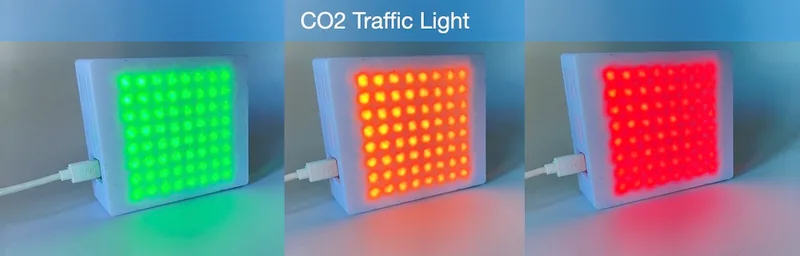

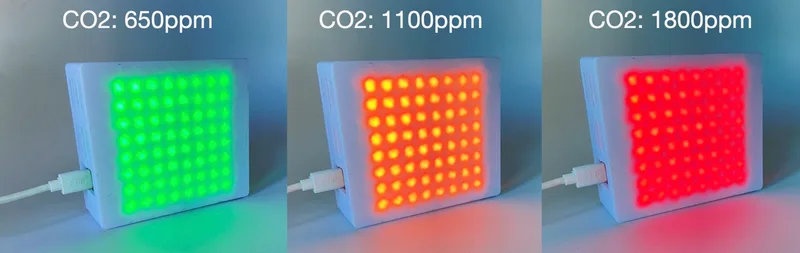

Adjusting the CO2 traffic light color bands
You can easily adjust at what levels of CO2, which color should be displayed. Just adjust the values in the code block that looks like below.
if (CO2 > 1200) {
showColor("red");
} else if (CO2 > 800) {
showColor("orange");
} else {
showColor("green");
The default is green <=800ppm CO2, yellow between 800 and 1200 ppm and red above 1200.

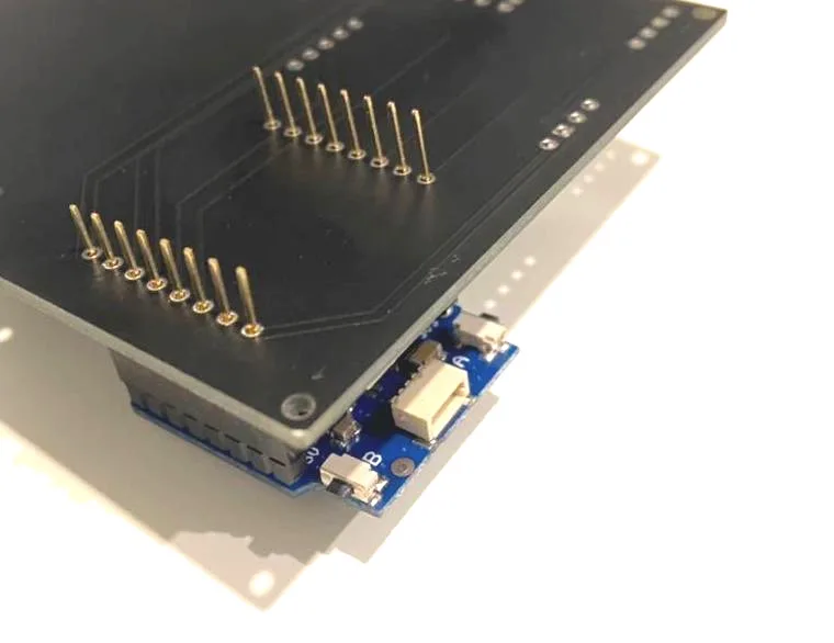

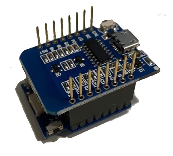

Wemos D1 Mini Soldering
Put the long female and male pins through the D1 Mini. Make sure that the female parts are on top of the D1 Mini as shown on this image:
ag diy wemos soldering mn04r6ax h50h1d7u
Wemos D1 Mini Soldering onto PCB
The next step is to solder the D1 Mini onto the PCB. Please make sure you solder it the correct way. The micro USB port needs to face outwards. You can also compare the PIN labels on the PCB with the ones on the D1 Mini.
You can either solder the D1 Mini directly onto the PCB or use the pin headers as a socket. If you solder it directly, please leave a small gap between the PCB and the D1 Mini to make sure the plug is accessible.
Important. If you use the display or RGB led shield, you need to solder the D1 Mini directly on the PCB without the pin headers as a socket as otherwise it becomes too high and does not fit the enclosure.

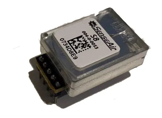

Soldering the Sensirion S8 Module (CO2 Sensor)
To solder the small pins onto the S8 module, you can use a breadboard again to fix it into place.
Please make sure that the PINS face downwards as can be seen on this image.
ag diy s8 mn04r6gm hb5jn22y
Then solder the CO2 sensor onto the PCB. It is important that the bottom side of the CO2 has enough air flow. So make sure the gap is sufficient. It might be a good idea to put it on a female pin socket but you can also solder it directly. You can use the pin that came with the D1 Mini but you need to cut them off to the required length.

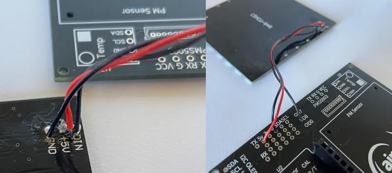

Connecting the LED matrix to the board
Take a 3 wire low voltage cable, around 10cm. Solder one part to the LED matrix. Important please make sure you soldet it to the pins labelled DIN.
Then solder the other end of the cable to the through holes of the board.
Please ensure that you connected the cables the following:
AirGradient PCB LED Matrix
5v +5V
G GND
D8 DIN

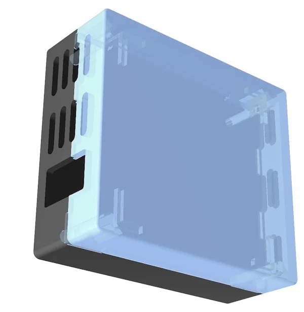

3D Enclosure and Mount
We have created a 3D printable enclosure that exactly fits the LED matric and the AirGradient DIY board consisting of a top and bottom part.
Download Enclosure STI Files
