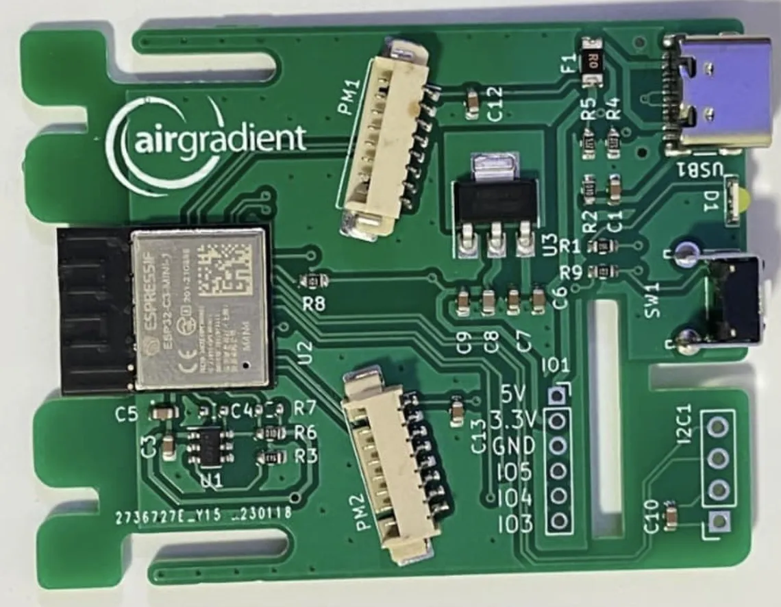

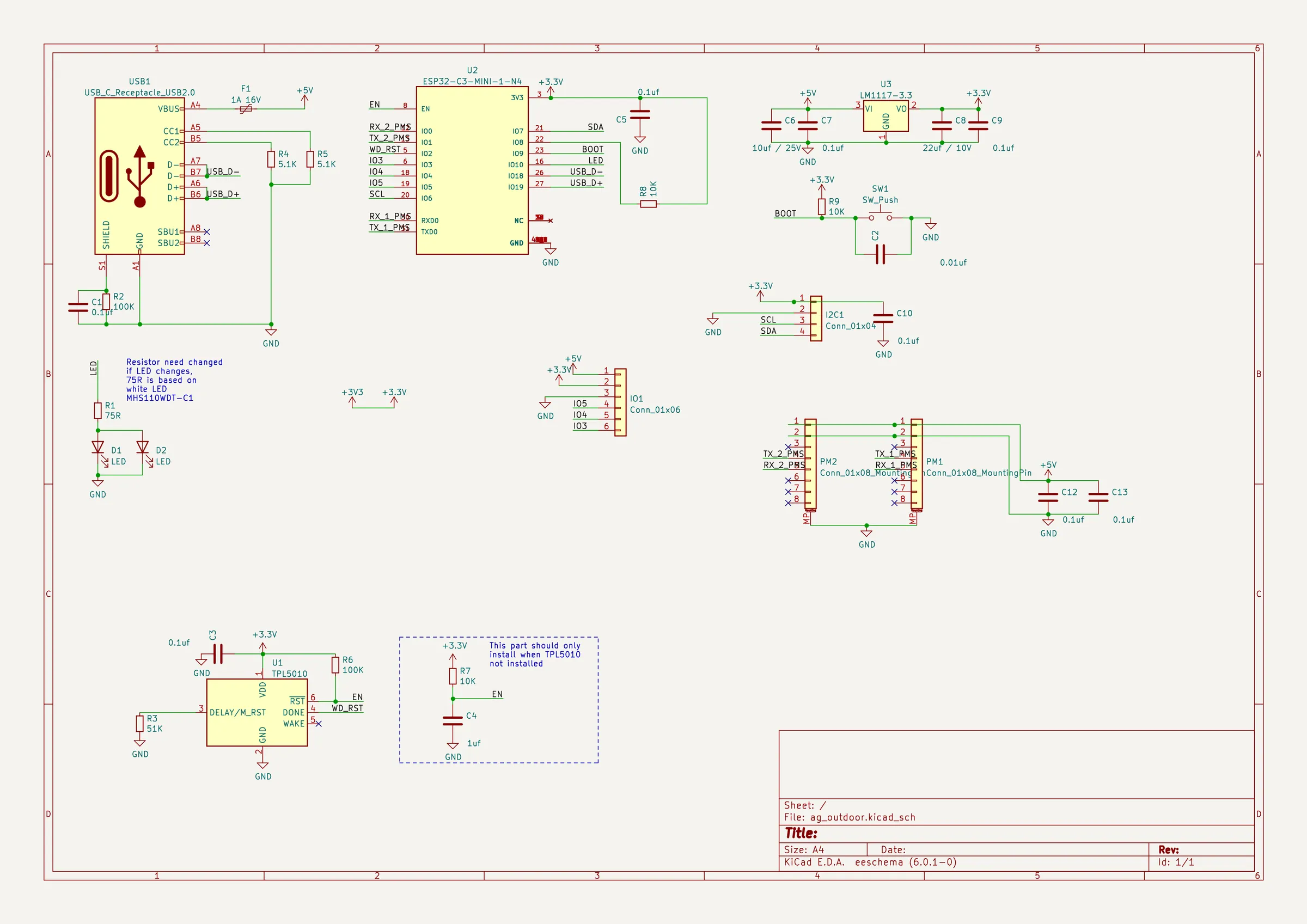

Schematics
(right click, open image in new tab for full screen)
PCB
The KiCad files are available for download here.
