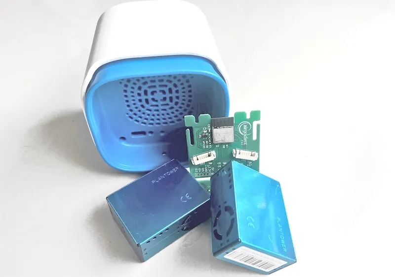

The assembly of the unit is very simple as you just need to connect the two PM sensor modules to the PCB and then fit all parts into the enclosure and screw the enclosure parts together.
Connect the PM Cables
First connect the PM cable to the PM sensor. Make sure you put the cable into the PM sensor in the right way. Then feed the cable through the small slots on the PCB and connect the cable to the PCB. You need to press the cables into the PM sensor and connector tightly. Please ensure that the cable is fully plugged in on both ends.
Then repeat the same thing for the second PM module.

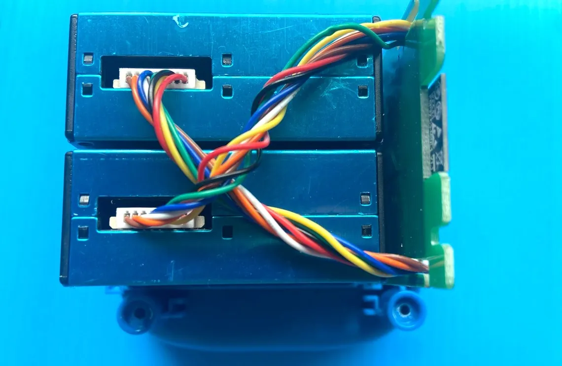

After you have connected both PM modules, place the PCB, PM modules into the blue bottom plastic part of the enclosure.
Please note the following: Twist the cable around 3 times and put the PM modules cross over from the cable exit on the PCB.

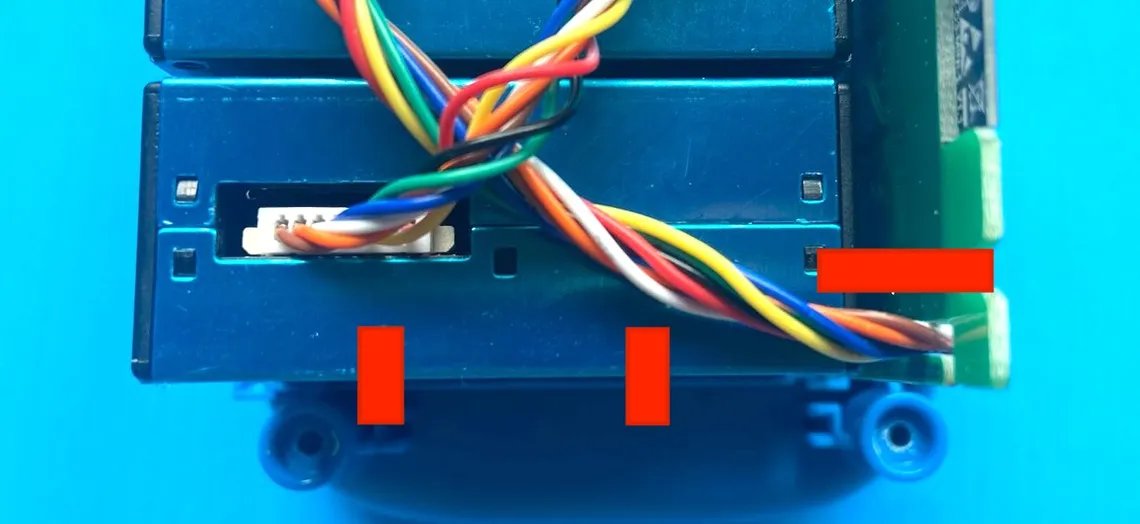

It is important that the cables are not squeezed from the plastic parts of the enclosure. So you should avoid that the cables are on the areas marked red in below image. Have a look at the inside of the white top part of the enclosure to see which parts might press onto the cable.
