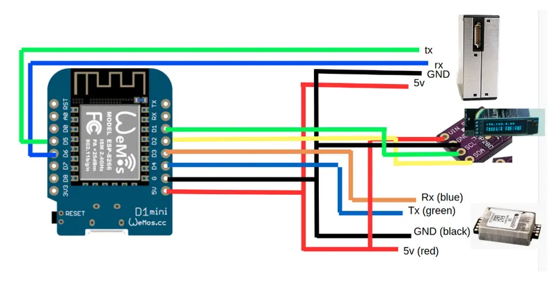

The schematics
The schematics

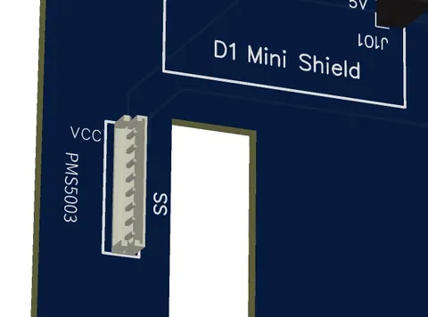

The PMS Sensor is connected with the enclosed cable to the PCBs JST connector.
PMS Location
PMS Location
PMS JST Connector
PMS JST Connector

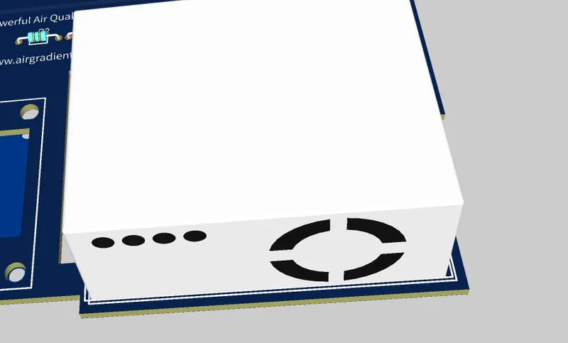

Then screw the PMS5003 onto the PCB.
