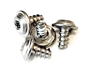

Screws for EnclosureM1.8x10 (Torx T6)
Screws for PCBM2*4.5 (Torx T6)
Screws for PM SensorM2*4.5 (Torx T6). Same screws as for PCB.

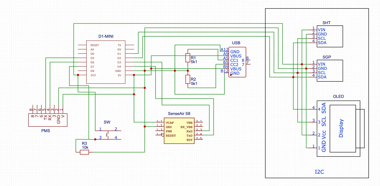

Schematics
The schematics

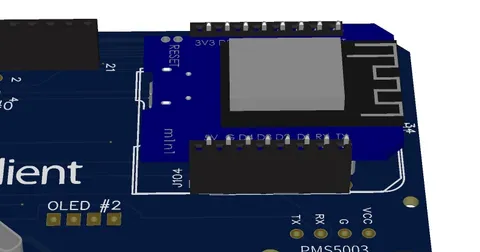

D1 Mini
Put the D1 microcontroller onto the pin sockets labelled “Microcontroller”. Make sure that the orientation is correct and all pins slide into the sockets. Ensure that the USB port of the D1 faces inwards and the antenna outwards.
D1 Mini Placement

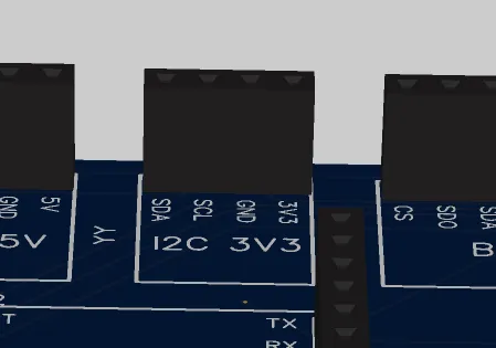

SHT31 Module (Temperature and Humidity)
Put the SHT31 Module onto the pin sockets labelled “SHT”. Make sure that the orientation is correct and all pins slide into the sockets.
SHT31 Module

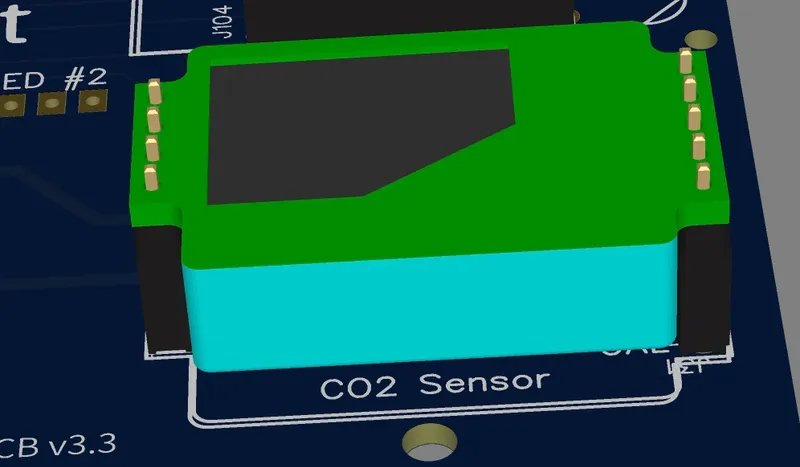

Senseair S8 Module (CO2 Sensor)
Put the CO2 Module onto the pin sockets labelled “CO2 Sensor”. Make sure that the orientation is correct and all pins slide into the sockets.
SHT Module
Important: Compared to the smaller DIY Basic kit, the pins here are soldered the opposite way to enhance the accuracy and airflow around the sensor. So in case you have a DIY Basic kit you cannot swap the sensor modules without resoldering the pins to change their orientation.

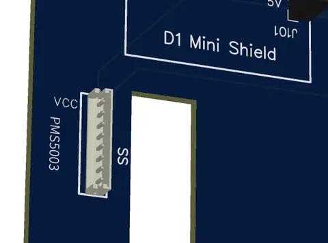

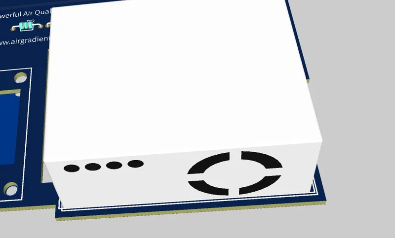

PMS5003 (PMS Sensor)
The PMS Sensor is connected with the enclosed cable to the PCBs JST connector.
PMS Location
PMS JST Connector
Screws for PMS Sensor
Then screw the PMS5003 onto the PCB.

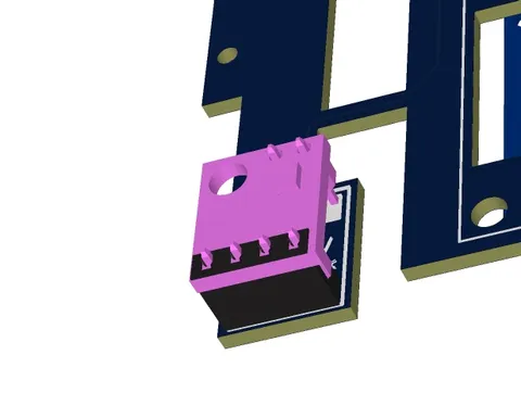

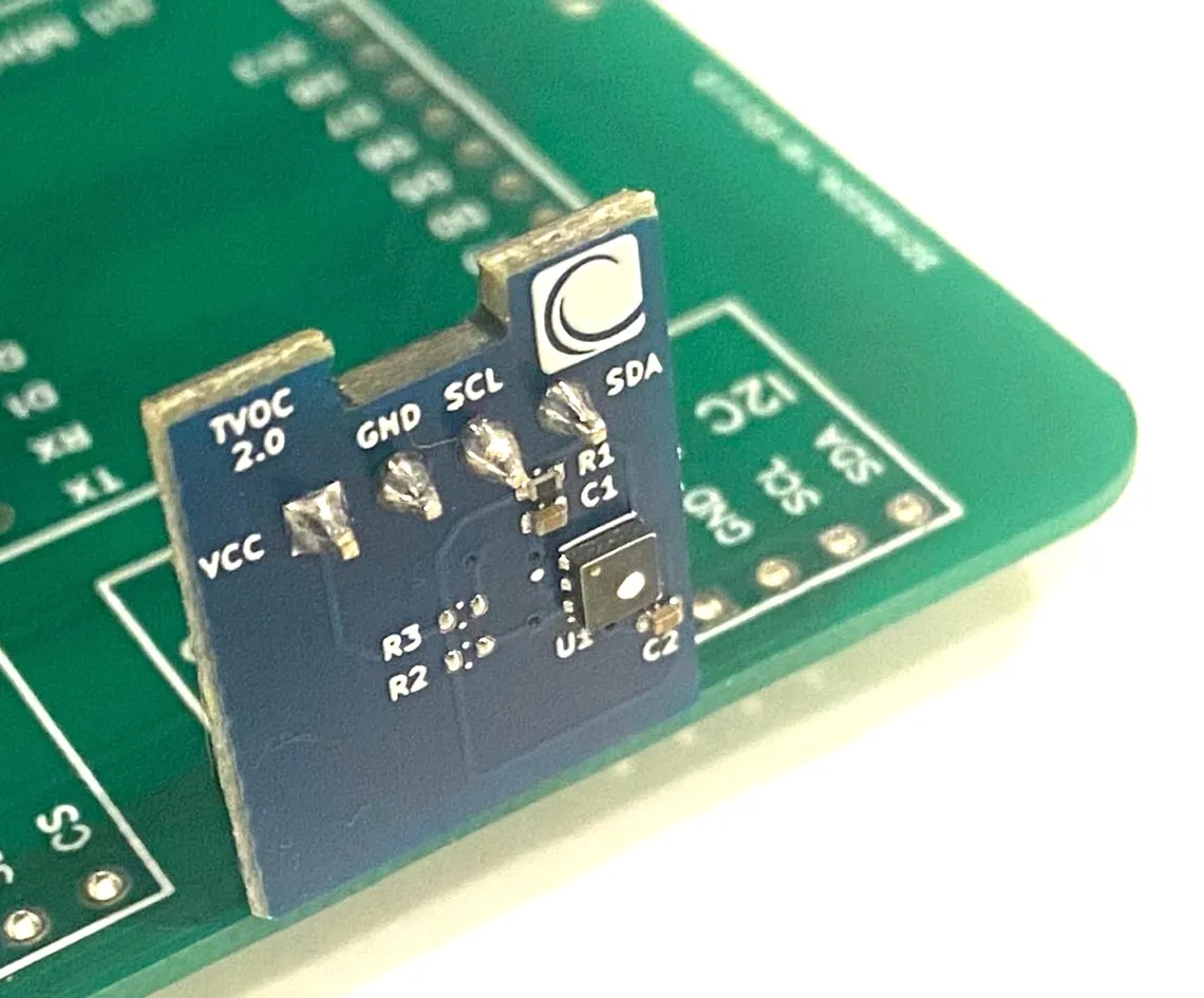

Optional SGP41 AirGradient TVOC / NOx Module
If you purchased the AirGradient TVOC / NOx module, please mount that module on below slot.
Slot for AirGradient TVOC / NOx Module
Please make sure you mount the module in the correct orientation. The sensor needs to face outwards.

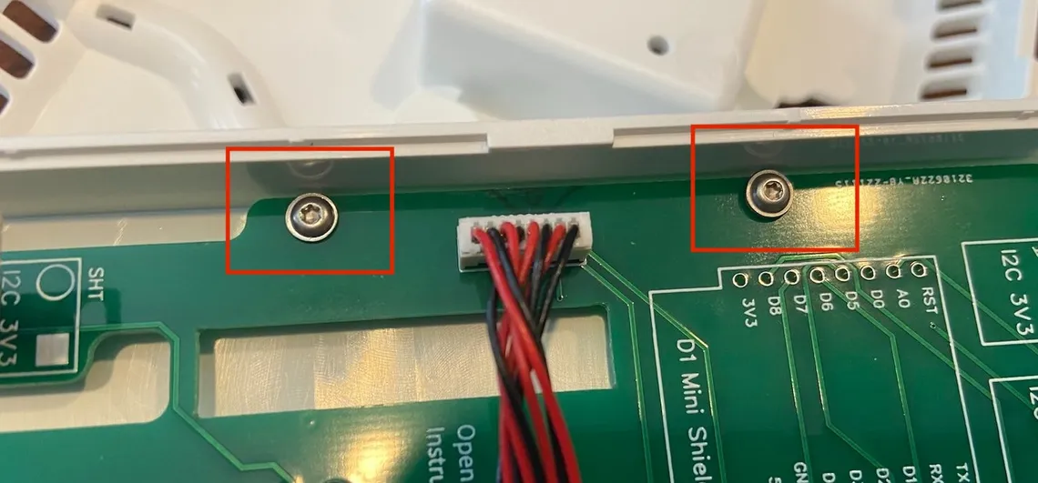

If everything works, you can screw the PCB into the top cover of the enclosure and close the enclosure.
Screws for PCB
Then screw them on both sides (each 2 screws).
Location for PCB screws

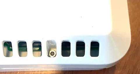

Once the PCB is firmly screwed on the top part of the enclosure, you can close the enclosure with the longer screws.
Screws for enclosure
The enclosure screws are going on the four sides into the ventilation vents:
Location for enclosure screws
