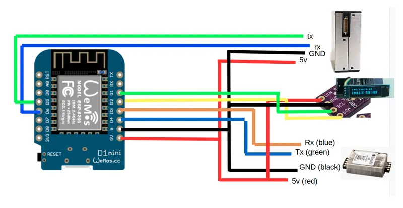

Schematics
You can use the following schematics:
Schematics

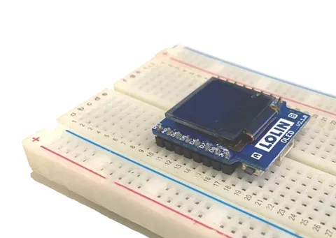

OLED Display Soldering
If you have a breadboard on hand, we recommend that you fix the pins with the breadboard to ensure that they are straight as shown in this picture.

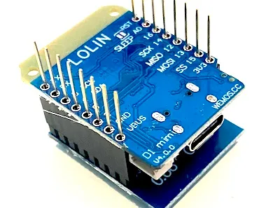

D1 Mini Soldering
Put the long female and male pins through the D1 Mini. Make sure that the female parts are on top of the D1 Mini (on the same side like the USB C plug) as shown in this picture and that the labels of the OLED pins and the D1 mini align:
D1 Mini soldering.

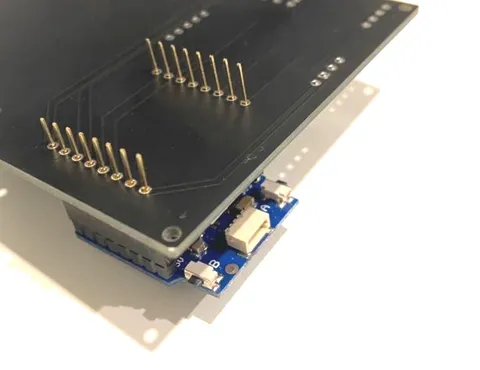

Then connect the freshly soldered OLED display into the female pins to better hold them in place. Then take the D1 Mini with the OLED display attached and turn it around and solder the pins onto the D1 Mini.
D1 Mini Soldering Onto PCB
The next step is to solder the D1 Mini onto the PCB. Please make sure you solder it the correct way. The USB port needs to face outwards. You can also compare the pin labels on the PCB with the ones on the D1 Mini. You can either solder the D1 Mini directly onto the PCB or use the pin headers as a socket. If you solder it directly, please leave a small gap between the PCB and the D1 Mini to make sure the plug is accessible.
Important: If you use the display or RGB led shield, you need to solder the D1 Mini directly on the PCB without the pin headers as a socket, otherwise it becomes too high and does not fit the enclosure.
D1 Mini PCB soldering

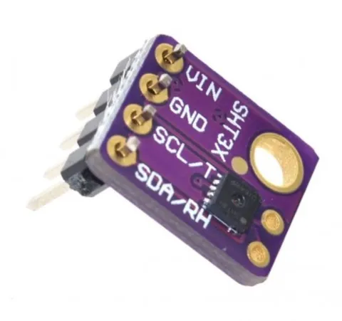

If you have the SHT3x module, you need to first solder the small pins onto the module, you can again use a breadboard to fix it in place. You only need to solder the four pins. No need to do anything with the two pins on the top of the sensor.
Soldering Pins onto the SHT Module

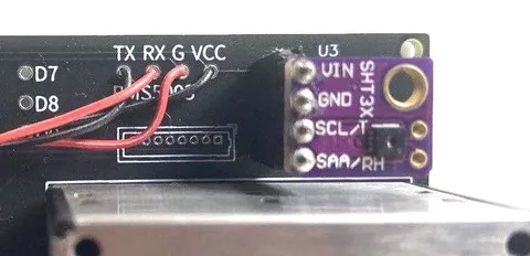

For easier replacement of the sensor modules, solder a 4 pin female header onto the board and then put the SHT3x module onto the pin header as per picture below.
SHT 3x Module Placement

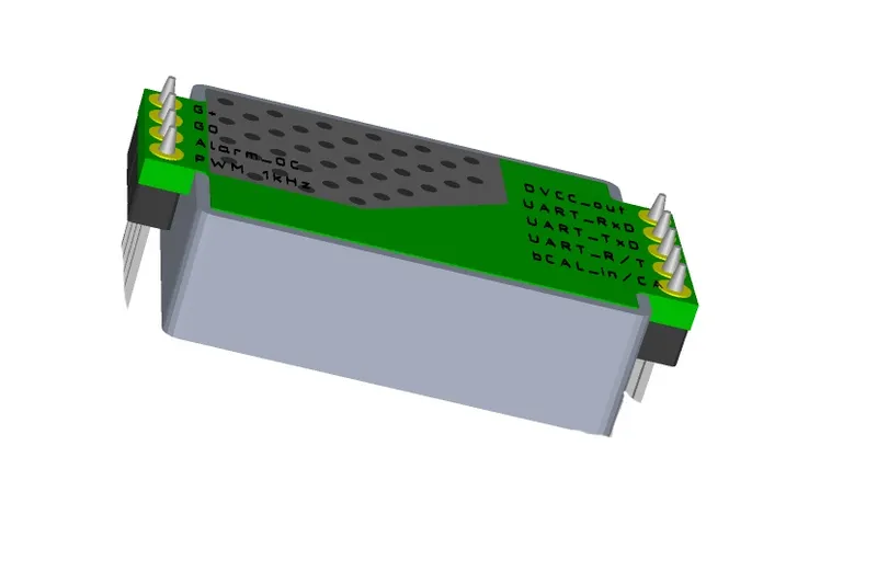

Solder female pin headers onto the S8 PCB. Then put the S8 onto the pin headers.
Please make sure that the pins face as can be seen on this image. If you purchase the kit from us, these pins are already soldered on.
Senseair S8 pin header soldering
Please note that in previous versions of this PCB, the pins were soldered in the opposite way.

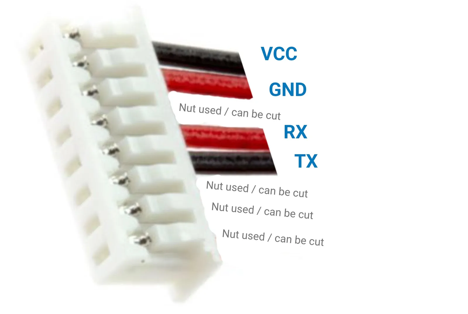

The PMS Sensor is connected with a cable to the PCB. There are two ways to connect it. If you can solder the small JST connector, then solder it on the board:
PMS JST Connector
Make sure it is soldered in the correct way (as indicated with the silkscreen and can be seen in the image above).
In case you cannot solder these small pins, you can also cut and splice the cable and solder it directly onto the PCB.
PMS Cable Wiring
Then solder the cable onto the PCB. Make sure that you solder the correct cable to the correct pin.
PMS Cable Connection without JST Connector

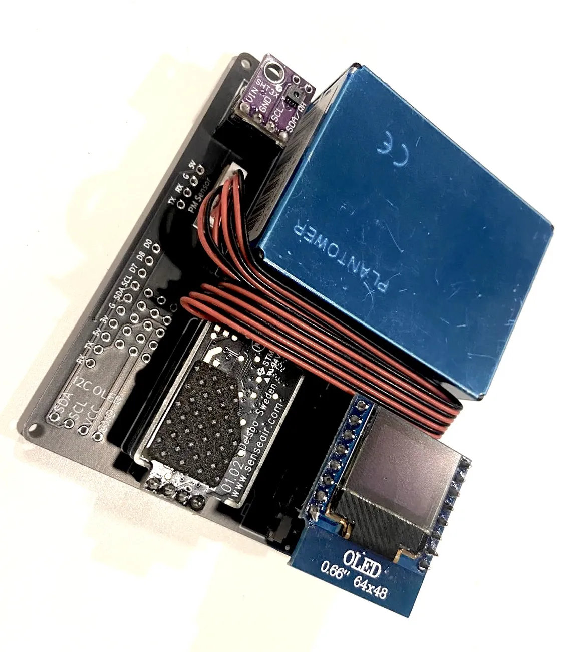

Done & Enjoy
That’s all and you can now connect the D1 Mini to power and you should be able to see the display lighting up. If you flashed the Wi-Fi version, you need to connect the D1 Mini to the Wi-Fi. To do this, open the Wi-Fi Settings on your phone and look for a hot spot called “AirGradient-______”. Connect to it and enter your Wi-Fi network credentials. It will then connect to your Wi-Fi and start displaying and sending the air quality data.

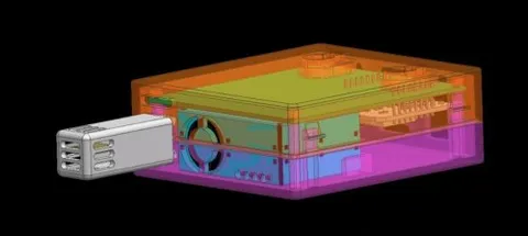

3D Enclosure And Mount
You can download STL 3D printer files to print an enclosure that exactly fits the PCB. The 3D enclosure consists of a top and bottom part. There are two different top parts depending on if you use the OLED display or not. Please note that if you use the OLED you need to solder the D1 Mini directly on the PCB as it otherwise sit too high and not fit the enclosure.
You can also print a small temperature probe that can be snapped onto the enclosure. By thus moving the temperature sensor outside the main enclosure, you can achieve more accurate temperature readings by minimizing the impact of the heat that builds up within the main enclosure.
