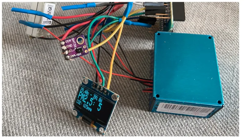

You can also get the components working without the PCB just by soldering the sensor modules with wires directly to the D1 Mini.
Built without PCB
However, we strongly recommend you assemble the monitor with a PCB as it will be much easier and more robust.

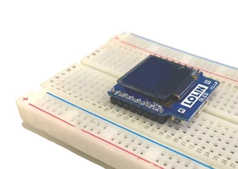

OLED Display Soldering
If you have a breadboard on hand, we recommend that you fix the pins with the breadboard to ensure that they are straight as shown in this picture.
OLED soldering

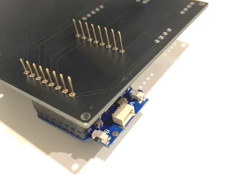

D1 Mini Soldering
Put the long female and male pins through the D1 Mini. Make sure that the female parts are on top of the D1 Mini (on the same side like the USB C plug) as shown in this picture and that the labels of the OLED pins and the D1 mini align:
D1 Mini soldering.
Then connect the freshly soldered OLED display into the female pins to better hold them in place. Then take the D1 Mini with the OLED display attached and turn it around and solder the pins onto the D1 Mini.
D1 Mini Soldering Onto PCB
The next step is to solder the D1 Mini onto the PCB. Please make sure you solder it the correct way. The USB port needs to face outwards. You can also compare the pin labels on the PCB with the ones on the D1 Mini. You can either solder the D1 Mini directly onto the PCB or use the pin headers as a socket. If you solder it directly, please leave a small gap between the PCB and the D1 Mini to make sure the plug is accessible.
Important: If you use the display or RGB led shield, you need to solder the D1 Mini directly on the PCB without the pin headers as a socket, otherwise it becomes too high and does not fit the enclosure.
D1 Mini PCB soldering

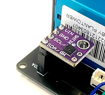

Soldering The Temperature and Humidity Module
You can use either the SHT3x module from AliExpress or the special AirGradient SHT40 module for temperature and humidity. The modules have a different design, so please follow the instructions below.

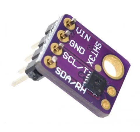

Instructions for SHT3x Module
If you have the SHT3x module, you need to first solder the small pins onto the module, you can again use a breadboard to fix it in place. You only need to solder the four pins. No need to do anything with the two pins on the top of the sensor.
Soldering Pins onto the SHT Module
For easier replacement of the sensor modules, solder a 4 pin female header onto the board and then put the SHT3x module onto the pin header as per picture below.
SHT 3x Module Placement

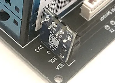

Instructions for AirGradient SHT40 Module
If you use the AirGradient SHT40 module, you do not need to solder pins as the 90 degree pins are already soldered on it but you need to solder a 4 pin female header onto the board and then put the module on it. Please note that when you put the SHT40 module onto the pin headers it needs to face backwards as per the image below.
SHT 40 Module Placement

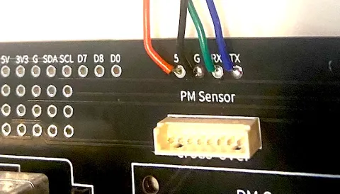

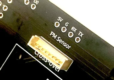

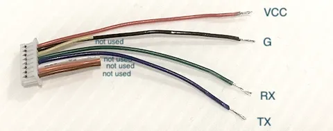

The PMS Sensor is connected with a cable to the PCB. There are two ways to connect it. If you can solder the small JST connector, then solder it on the board:
PMS JST Connector
Make sure it is soldered in the correct way (as indicated with the silkscreen and can be seen in the image above).
In case you cannot solder these small pins, you can also cut and splice the cable and solder it directly onto the PCB. Please note that the 3rd, 6th, 7th and 8th wire is not used and can be cut.
PMS Cable Wiring
Then solder the cable onto the PCB. Make sure that you solder the correct cable to the correct pin.
PMS Cable Connection without JST Connector
Please note that version 4 of this PCB now uses a smaller cross-over cable. Often the default cable that comes with the PM sensor is not cross-over. See above on how to detect what kind of cable you have.

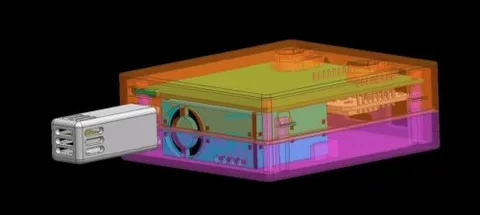

3D Enclosure And Mount
You can download STL 3D printer files to print an enclosure that exactly fits the PCB. The 3D enclosure consists of a top and bottom part. There are two different top parts depending on if you use the OLED display or not. Please note that if you use the OLED you need to solder the D1 Mini directly on the PCB as it otherwise sit too high and not fit the enclosure.
You can also print a small temperature probe that can be snapped onto the enclosure. By thus moving the temperature sensor outside the main enclosure, you can achieve more accurate temperature readings by minimizing the impact of the heat that builds up within the main enclosure.
Download Enclosure STL Files
