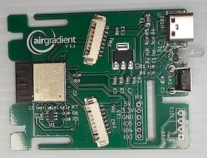

Flashing Instructions
Important. Please follow these steps for flashing only. If you only want to see debug messages and logs of the monitor see the instructions for logging:
- Push the button on the PCB and keep it pushed
- Plug in the USB C cable
- Release the button. If you do not do this, the board will not get into the flash mode.
- Press the blue button above
- Select the serial port your monitor is connected to. It is typically called “USB JTAG / Serial Debug”
- Follow the instructions for flashing
- After the flashing is complete, restart the monitor by unplugging the USB C cable (and plugging it back in)
