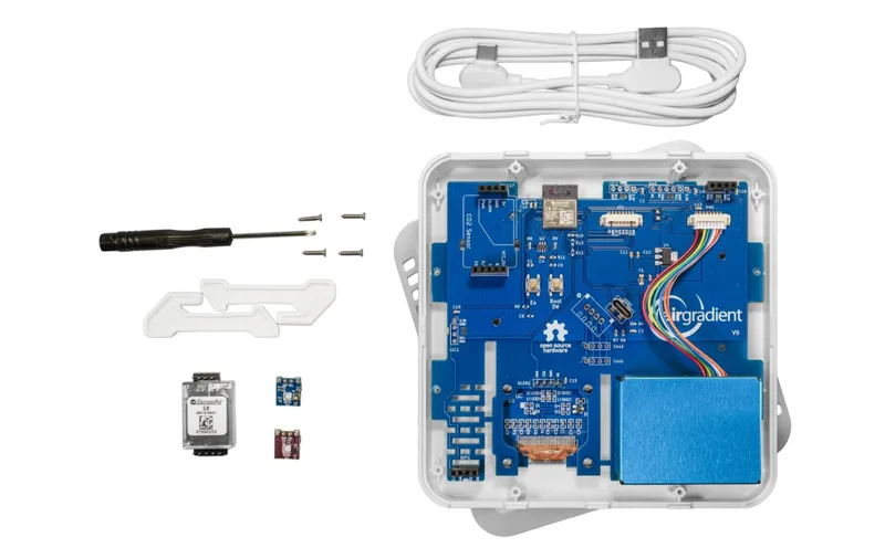

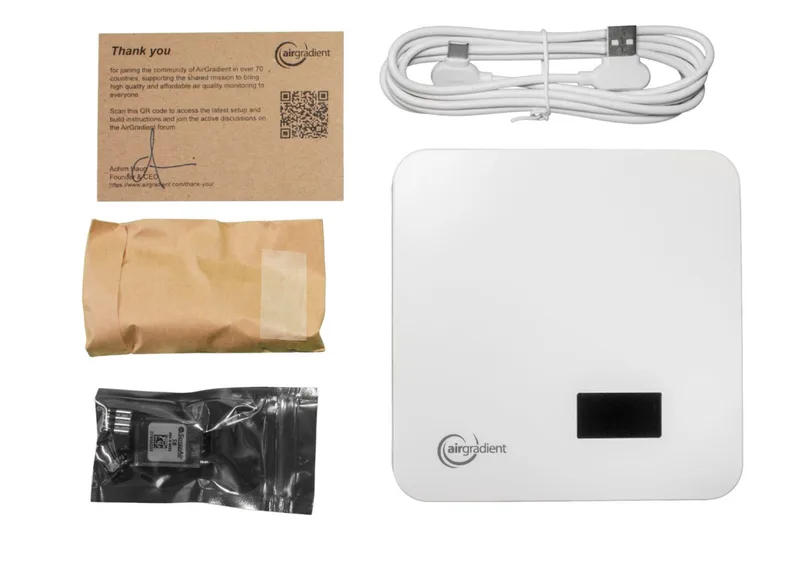

Below is the list of components that you will receive with the kit:
Component Description
AirGradient ONE PCB v9 with ESP32-C3-MINI, OLED Display, connectors and pin sockets.
Plantower PMS5003 PM Sensor pre-mounted particulate matter (PM) sensor with cable.
Senseair S8/S88 CO2 Sensor with pre-soldered pins
SHT4x Temperature and Humidity Sensor Module with pre-soldered pins
SGP41 TVOC / NOx Sensor Module with pre-soldered pins
USB-C Cable 90-degree head (USB A to USB C)
Enclosure UV-resistant injection molded ASA plastic
Stands UV-resistant injection molded ASA plastic
Screws for Enclosure 4x M1.8x10 (Torx T6)

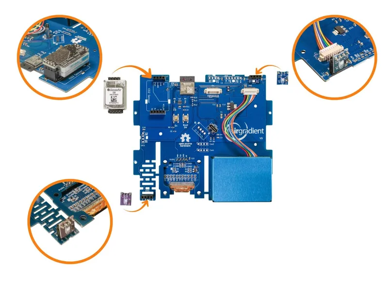

Location of the Components on the PCB

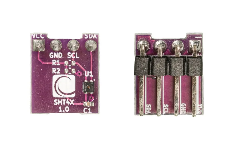

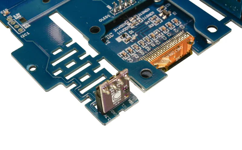

1. Install the SHT4x Module (Temperature and Humidity Sensor)
sht40 module mn04r15v 0svu5gxr

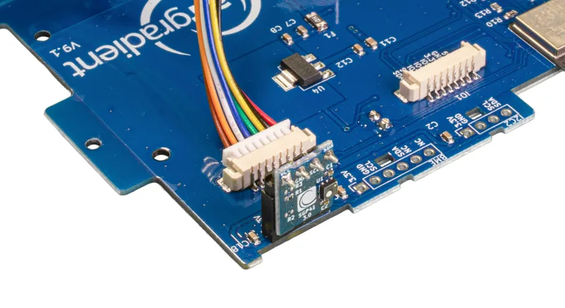

Install the SHT4x module as per the picture below. It should be inserted in the slot at the bottom left of the board labelled “SHT1”. The AirGradient logo should face outward.
sht41 in ag one mn04r1fd 2cj2q3uq
Note: The SGP41 (TVOC) module looks very similar to the SHT4x Module (Temperature and Humidity Sensor). Please pay close attention to ensure you don’t mix up the modules.

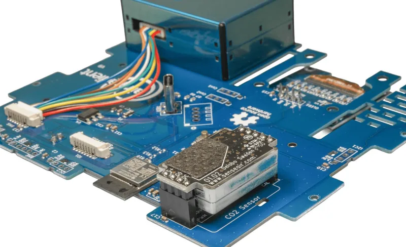

2. Senseair S8/S88 Module (CO2 Sensor)
senseair s8 module mn04r1ye 8zwjc89i

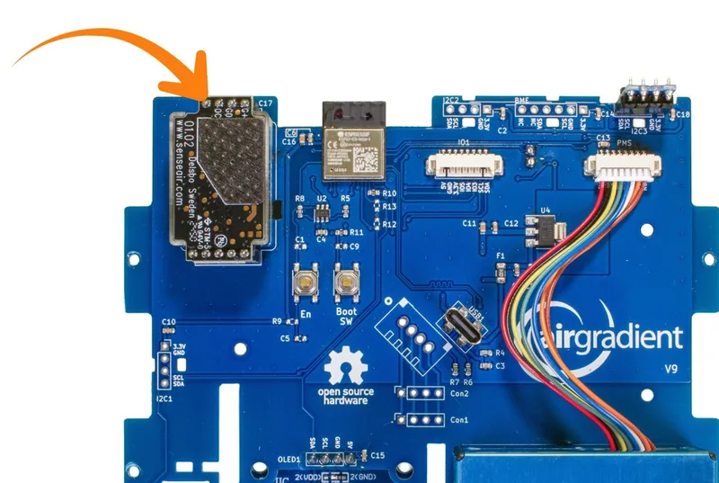

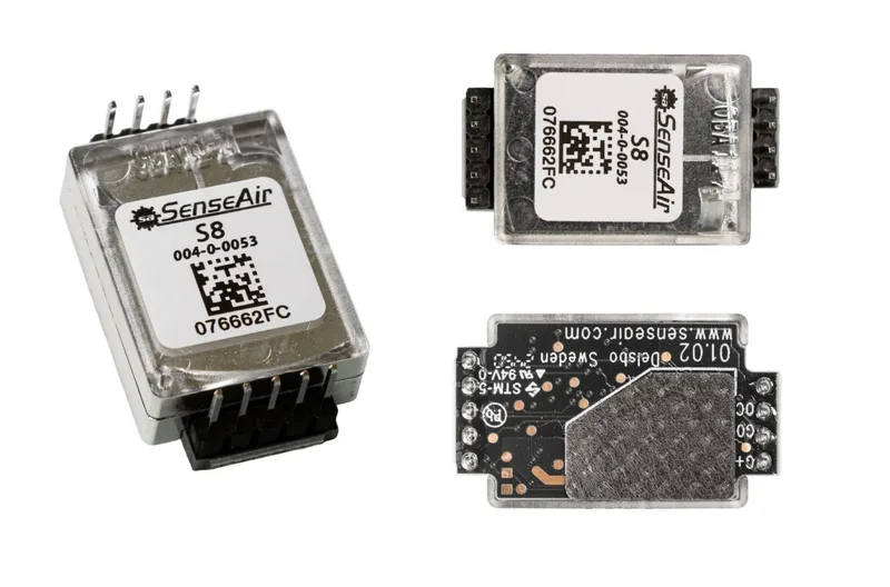

Next, insert the CO2 Module in the pin sockets labelled “CO2 Sensor”. Make sure that the orientation is correct and all pins slide into the sockets.
s8 module on board mn04r2lj 7f5meu9t
CO2 Module
CO2 Module
By default, the CO2 sensor uses a 7-day automatic baseline calibration and thus needs a few days to become accurate.
Please note that some monitors may come with an S8 module, and some with an S88. These are functionally the same and should be placed in the same way.

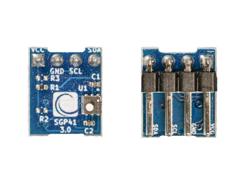

3. SGP41 TVOC / NOx Module
sgp4x module mn04r38v ztm1p3vf

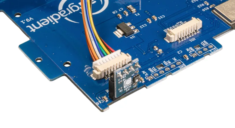

Mount the TVOC / NOx sensor in the slot in the top-left corner labelled “I2C3”.
sgp41 placement mn04r3ny d9oezye9
Please make sure you mount the module in the correct orientation. The sensor needs to face outwards.
Again, please ensure that the SGP41 and SHT4x modules are in the correct locations on the board (pictured above) and that they are both orientated with the logo facing outwards. If these sensors are mixed up, the device will still work, but the readings from these sensors may be inaccurate.

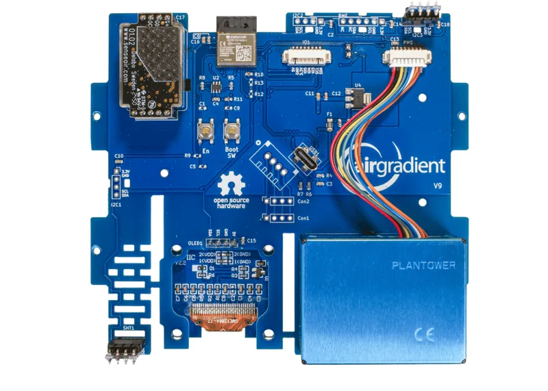

The fully assembled PCB will look like below:
Fully assembled AirGradient ONE PCB

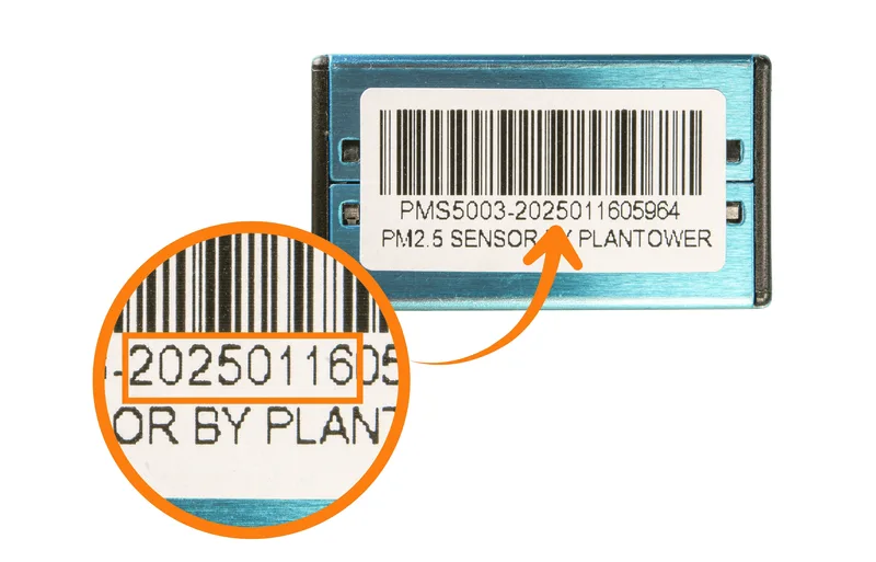

4. Take Note of Your PM Module Serial Number
pms serial number mn04r46t 63s2poxw
We have developed a range of batch-corrections for the PM sensors used in our monitors which help to improve accuracy and precision. To apply these batch corrections, you will need to know the first eight digits of the PM sensor's serial number.
To find the serial number, please look at the blue PM module from the bottom of the board. Each sensor will have a sticker like the image above. For further information on the batch corrections, please refer to this article.
To avoid needing to open the monitor at a later date, please note down or take a photo of this number.

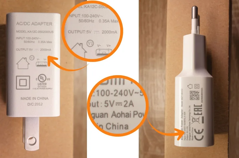

You can now power on the device by plugging in the USB cable. After a few seconds, you should see the display light up. The power adapter is not included in the kit. Please use a standard 5V, 2A power supply.
usb adapter for airgradient mn04r4eo il1dv8qx
You will likely have one of these lying around your house from a smartphone or another device.
Please note that if the device does not turn on - or if you notice unexpected behaviour like the device restarting randomly - you may need to use a different USB adapter.

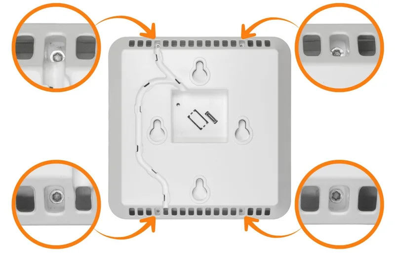

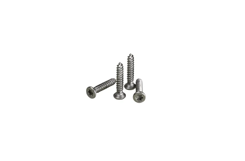

If everything works, place the PCB assembly inside the enclosure. The PCB does not need screws as it is held firmly in place by the enclosure. Then close the enclosure using the four long screws provided, inserted through the side vents.
Enclosure Screws
Enclosure Screws
The enclosure screws go into the four ventilation vents around the back of the device:
Enclosure Screw Vents

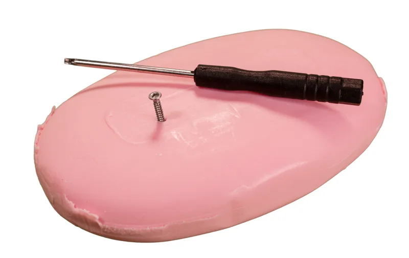

Please note that the mini screwdriver enclosed with the kit might not have enough torque to screw these screws all the way in. In that case, please use a larger T6 screwdriver, or you can also put some oil/soap on the screws to make them go in easier.
Please also be careful not to force the screws in, as this can lead to them getting stuck in the case and may make the device hard to open for maintenance.
Soap helps getting the screws into the enclosure in case you use the mini screwdriver

Please use a standard 5V, 2A power adapter. Using lower-rated power adapters can cause issues. If you notice issues like a distorted screen or sensors dropping out, this is likely due to the power supply being used.
