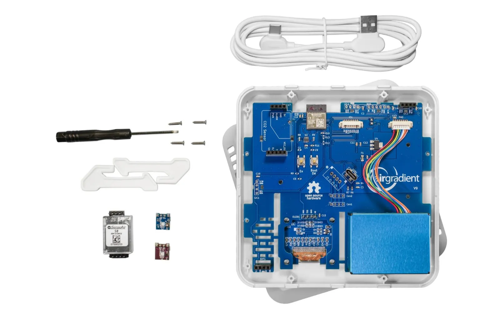

Below is the list of components that you will receive with the pre-soldered kit:
Component | Approx. Price |
AirGradient ONE PCB v9 | with ESP32-C3-MINI, OLED Display, connectors and pin sockets |
Plantower PMS5003 PM Sensor | with cable |
Senseair S8 CO2 Sensor | with pre-soldered pins |
SHT4x Temperature and Humidity Sensor Module | with pre-soldered pins |
SGP41 TVOC / NOx Sensor Module | with pre-soldered pins |
USB-C Cable | 90-degree head |
Enclosure | UV-resistant injection molded ASA plastic |

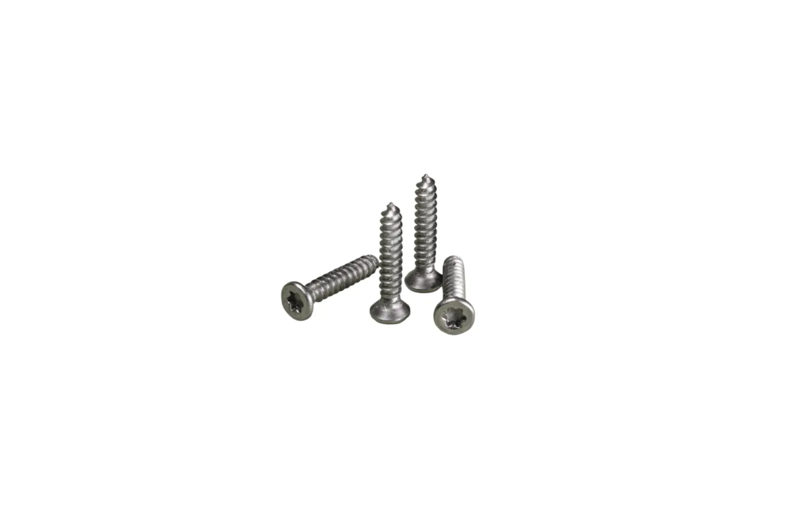

Screws for Enclosure | M1.8x10 (Torx T6) |
Screws for PCB | M2*4.5 (Torx T6) |
Screws for PM Sensor | M2*4.5 (Torx t6). Same screws as for PCB. |

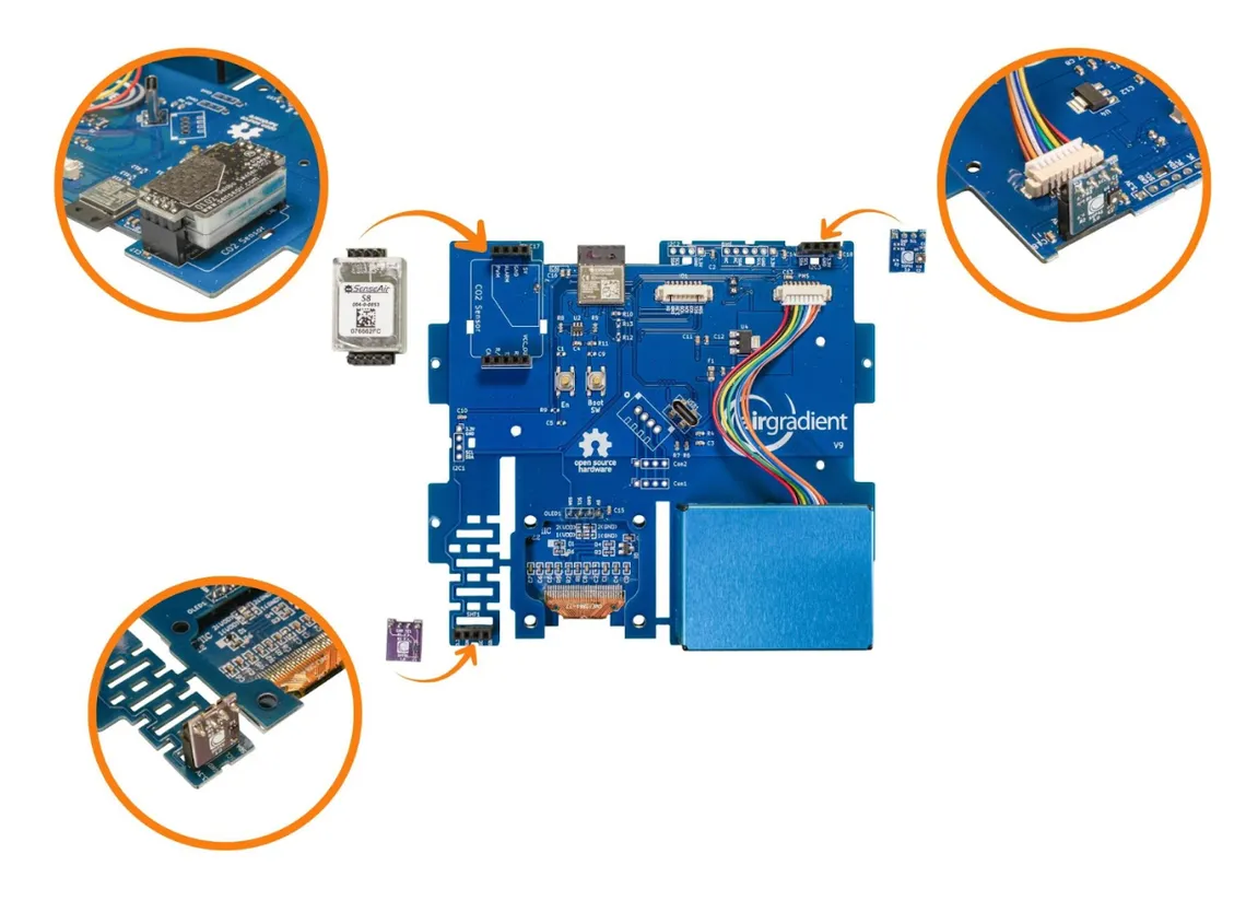

The assembly of the pre-soldered parts is very simple, just make sure you mount the components in the correct direction. The labels on the components should match the labels on the PCB. The PCB might come in blue or black color but are functionally identical.
ESP32-C3 Mini
The board already contains the ESP-C3-MINI microcontroller installed so there is nothing you need to do. Please note that it is connected to the USB connector on the board so that it can be flashed through the USB port.
There are also two buttons below which you might need during the flashing process.
SHT40 Module (Temperature and Humidity Sensor)
Install the SHT4x module as per the picture below. It is put on the pin headers at the bottom left of the board labelled “SHT1”. Note that the SGP4x (TVOC) module looks very similar. So make sure you install the SHT module which is labelled “SHT4x”.
Please make sure that the module faces outwards.

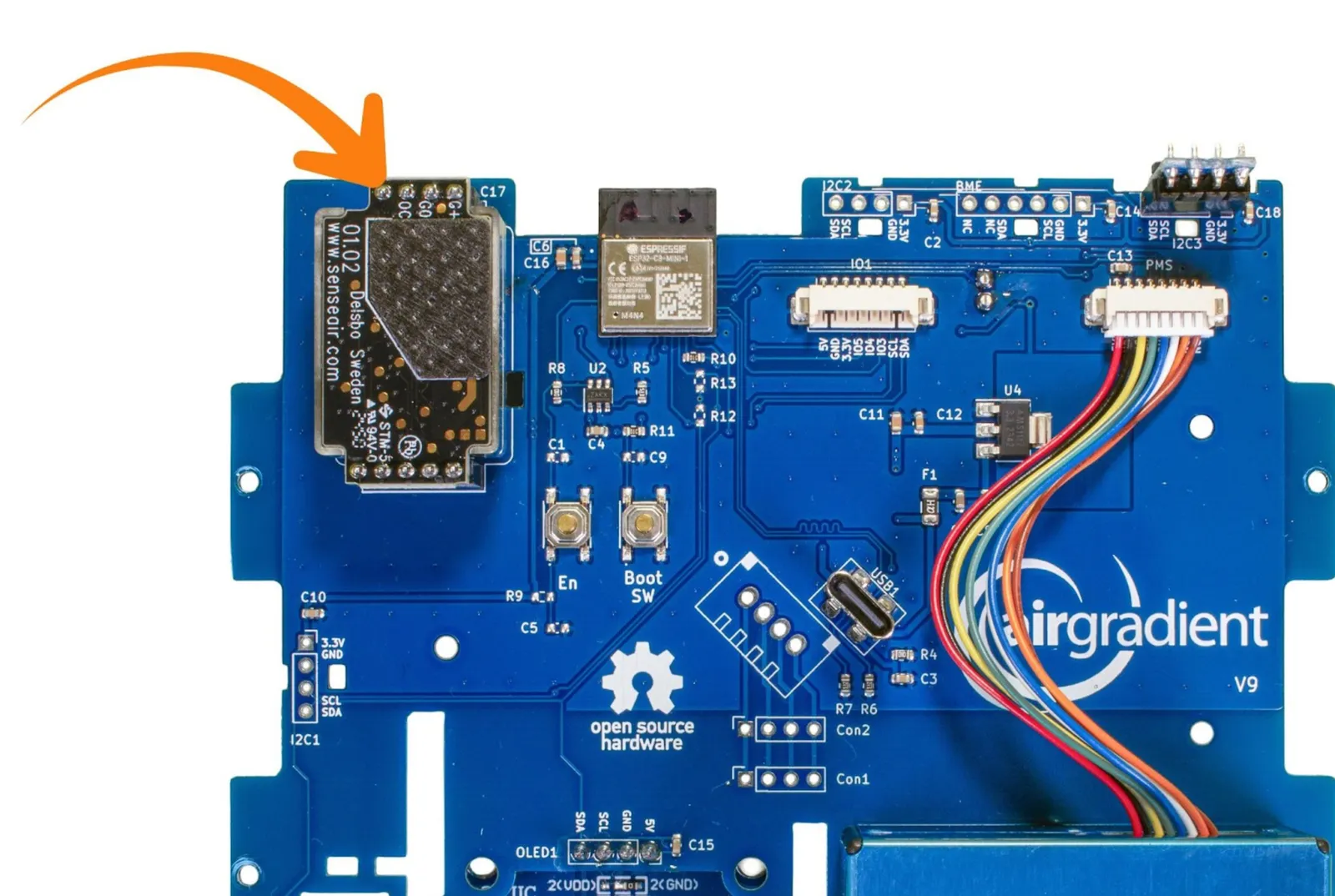

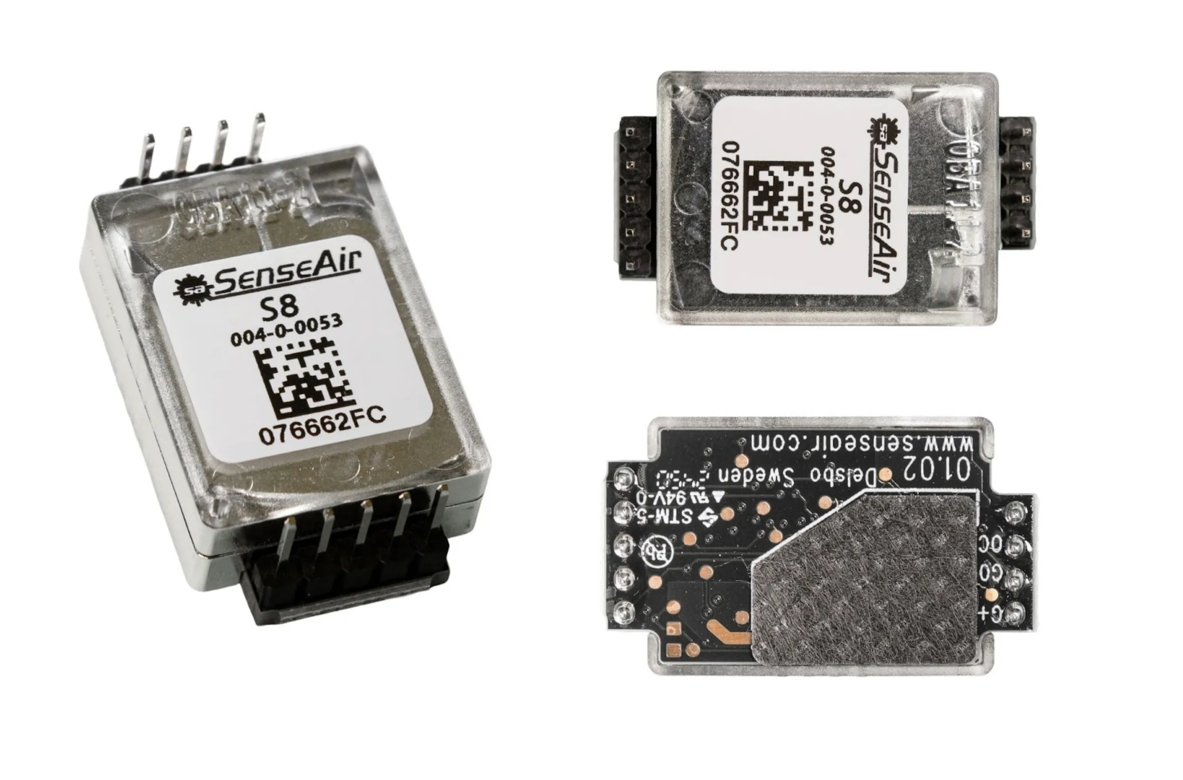

Senseair S8 Module (CO2 Sensor)

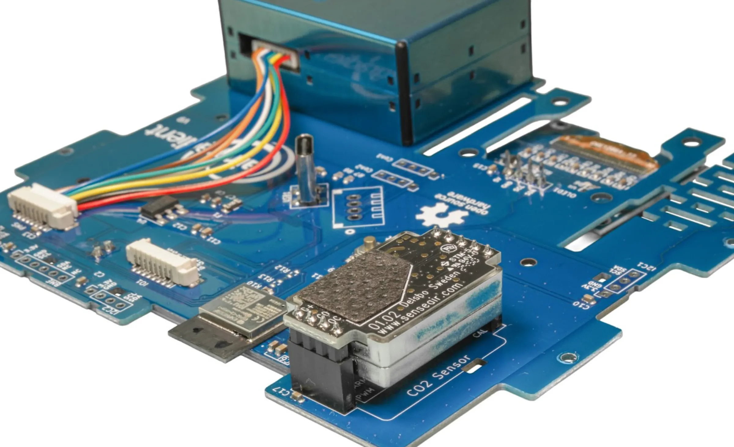

Put the CO2 Module onto the pin sockets labelled “CO2 Sensor”. Make sure that the orientation is correct and all pins slide into the sockets.
The CO2 sensor uses a 7-day automatic baseline calibration and thus might need some time to become accurate.
PMS5003 (PMS Sensor)
The PMS Sensor is connected with the enclosed cable to the PCBs JST connector labelled “PMS”. Please note that we use a cross-over cable and thus the longer cable that is often shipped with the PMS5003 sensor will not work. You need to press the cables into the PM sensor and connector tightly.
Please ensure that the cable is fully plugged in on both ends.
Then screw the PMS5003 onto the PCB.

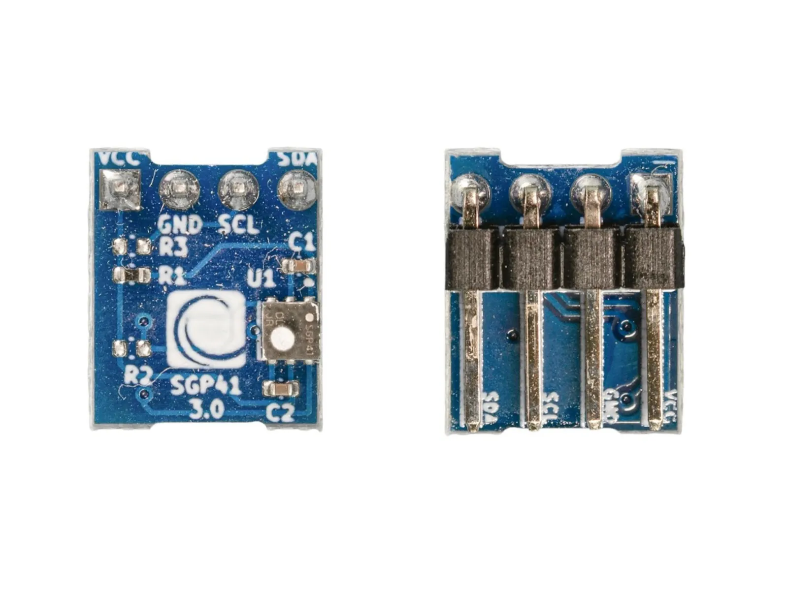

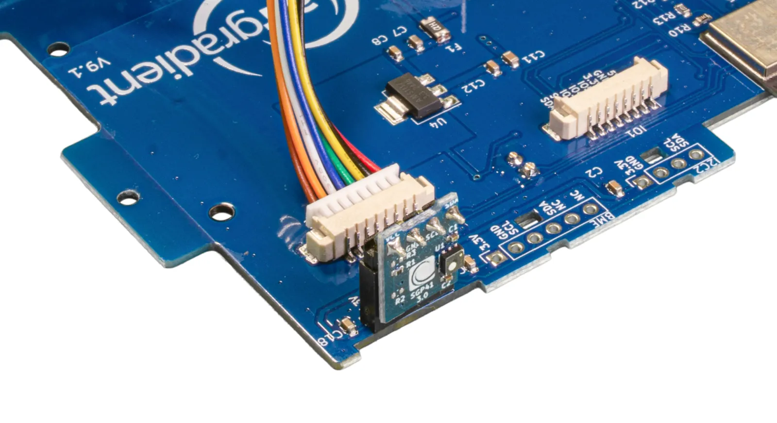

SGP41 AirGradient TVOC / NOx Module
The TVOC / NOx module is mounted in the slot in the top left corner labelled “I2C3”.

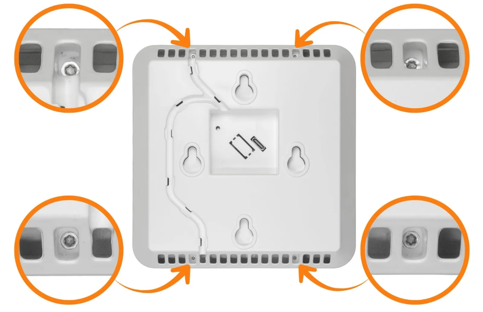

Once the PCB is firmly screwed on the top part of the enclosure, you can close the enclosure with the longer screws.

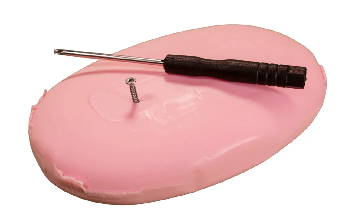

The enclosure screws are going on the four sides into the ventilation vents:
Please note that the mini screwdriver enclosed with the kit might not have enough torque to screw these screws in. In that case, please use a larger T6 screwdriver, or you can also put some oil/soap on the screws to make them go in easier.

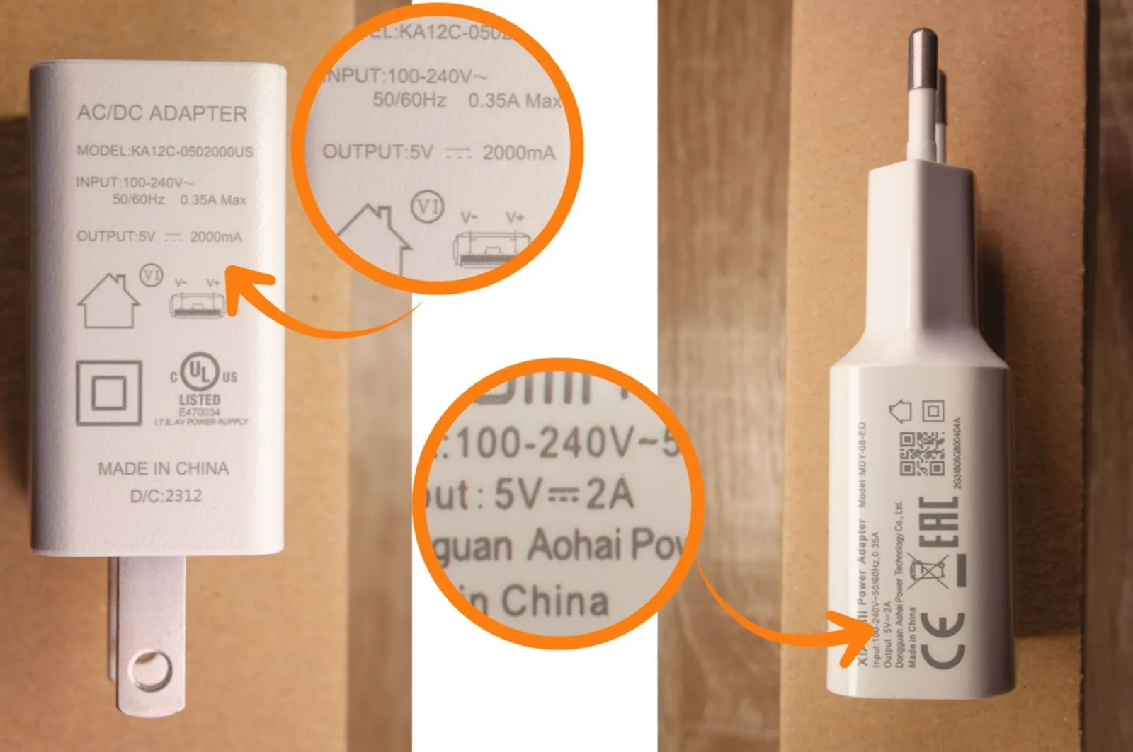

Power Supply
The power supply is not included in the kit. Please get a standard 5v, 2A power supply.

Enclosure screws hard to put in with small screwdriver. | Put some soap on the screws or use a larger T6 one. | |
