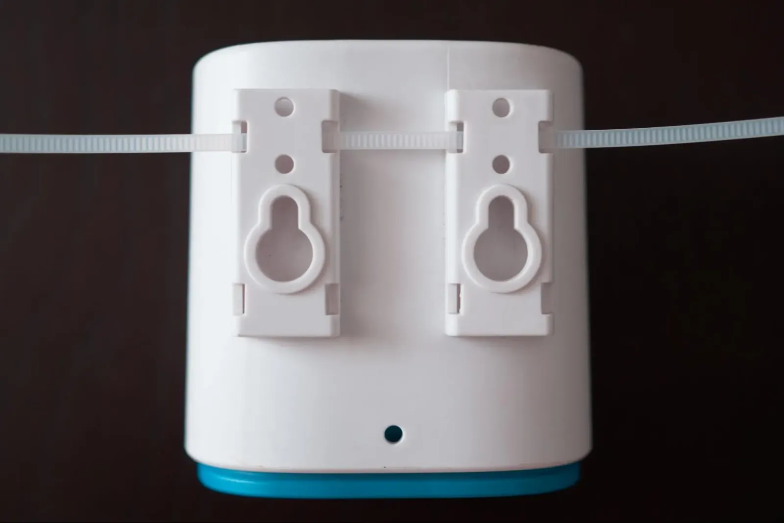

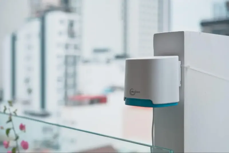

For temporary installations, cable ties, sturdy string, or wires can be passed through the four holes on the sides of each bracket. This method is well-suited for mounting the device on poles, fence posts, or any other object to which the monitor can be tied. We recommend cable ties or wire for this method, as they won’t degrade significantly due to weather conditions.

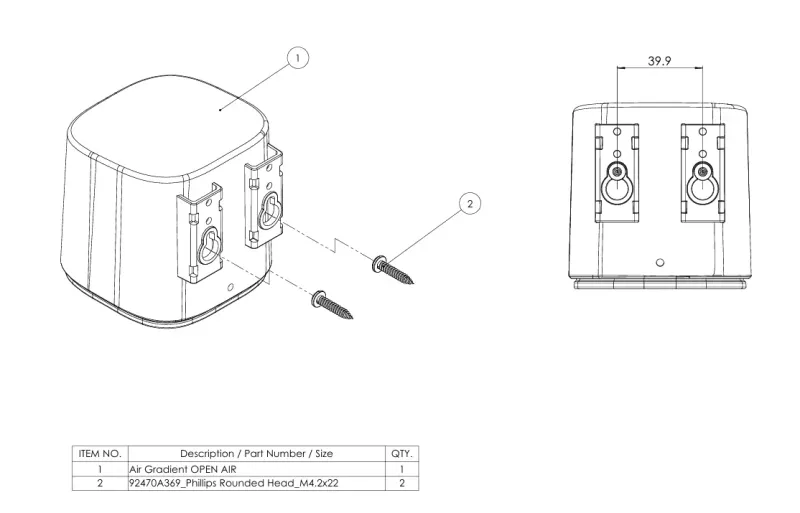

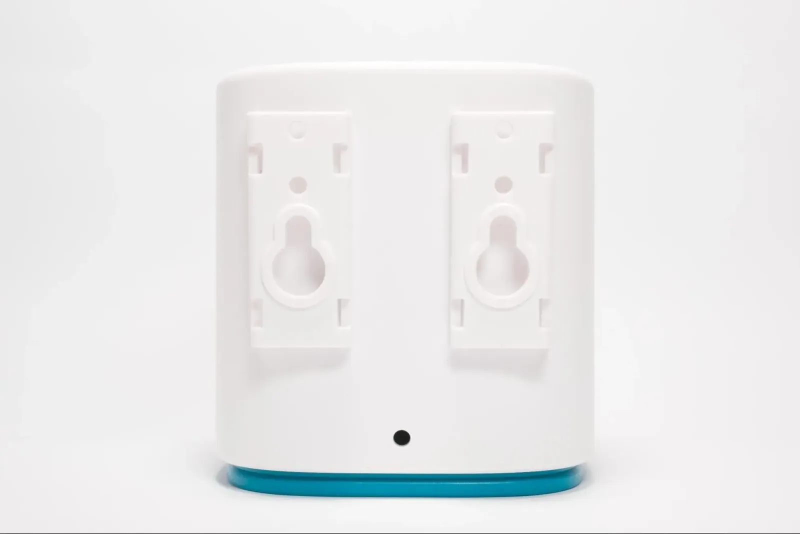

For a more permanent installation, or when installing the device on a flat surface, we recommend measuring the distance between the two large mounting points (located 39.9mm apart) and drilling two M4 screws into the wall with the heads sticking out. The monitor can then be mounted on these heads and pushed down so the monitor won’t fall off. When removing the monitor, push it up before pulling it off the wall.
The two holes at the top of each bracket are designed for expansion options and aren’t intended to be used to mount the device. Finally, the single hole at the bottom of the device is an anti-theft screw hole into which you can insert a screw to prevent the device from being lifted up and easily removed.

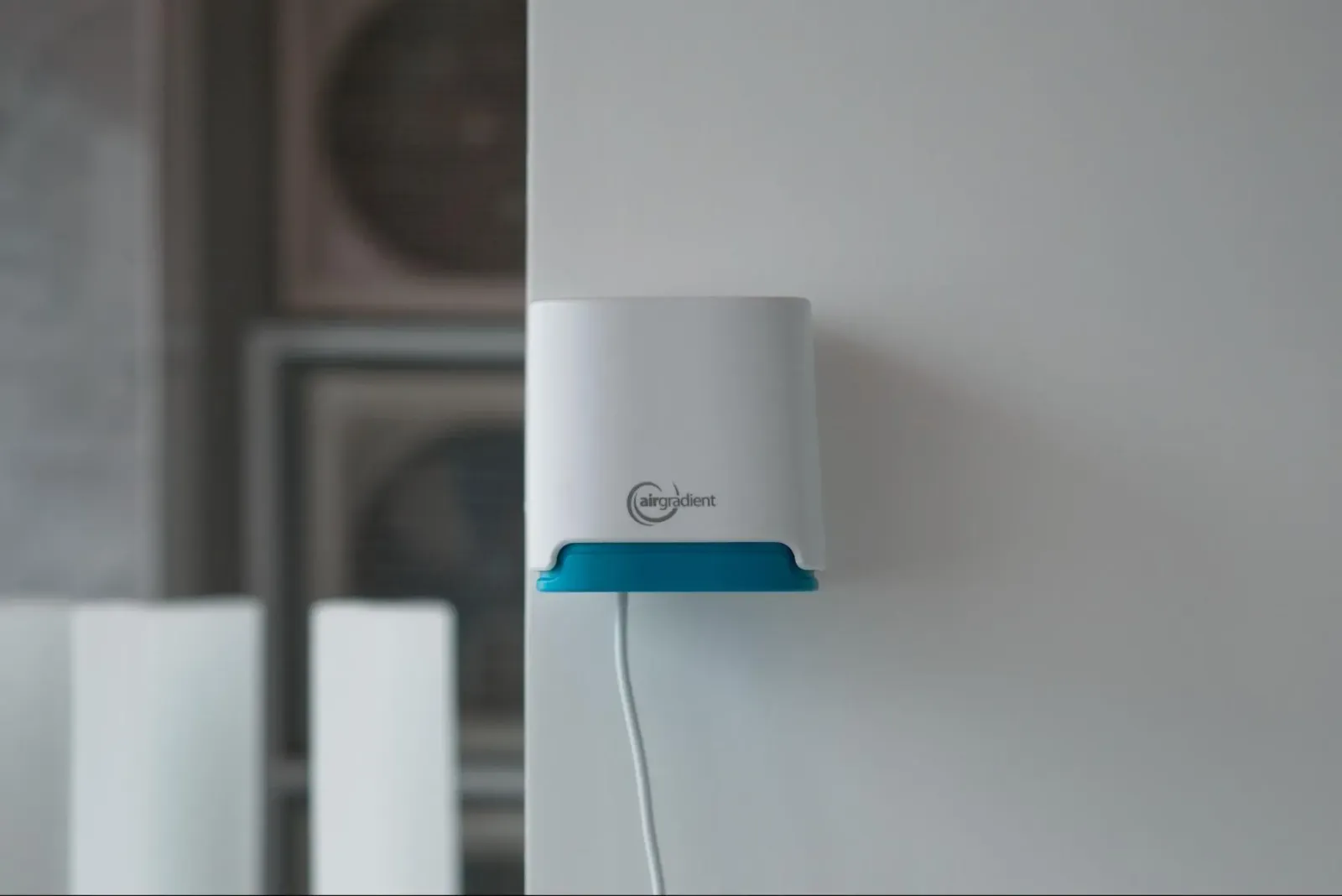

When installing the Open Air on a wall or post, please ensure the device is in the correct orientation, with the blue vent facing downwards. Furthermore, ensure that there are no obstructions around the vent hindering airflow. Furthermore, please remember the following points:
