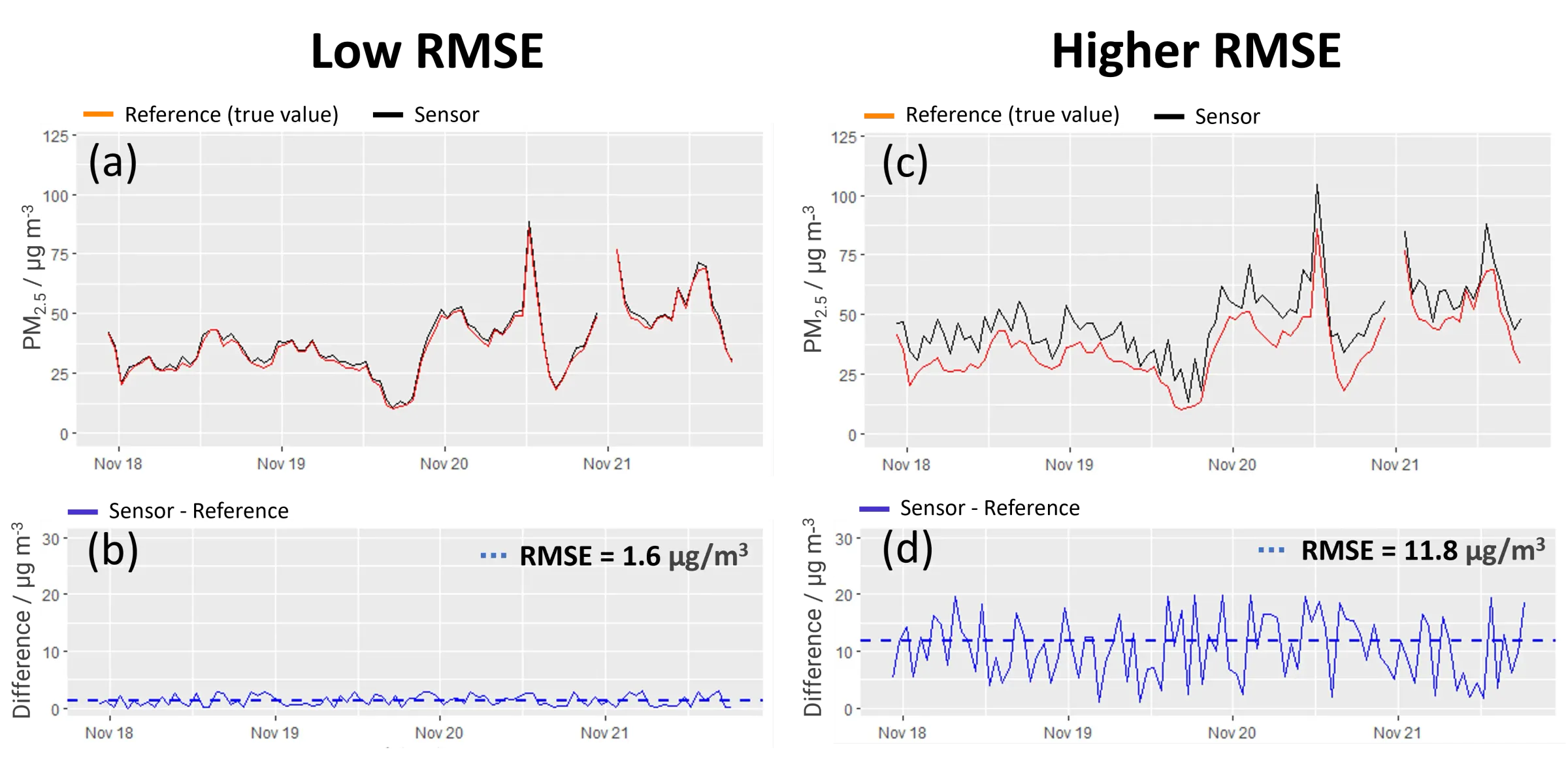

Look at the two top panels of Figure 3. Which of the two sensors would you use? Left or right? Most of you will probably pick the left sensor because its measurements are very close to the reference values (red line) whereas the right sensor is much “further away” from the red line. You intuitively see that the left sensor is more accurate. So well chosen!
The RMSEs reflect this: Not surprisingly, the RMSE (i.e., the average error) of the left sensor is lower than the RMSE of the right sensor. The lower the RMSE, the better the sensor performance. A perfect sensor (that exactly measures the true concentrations of a pollutant) would have an RMSE of 0.
6 Fig 3 Low vs highRMSE
Figure 3: PM2.5 measurements of a relatively accurate (left) and a less accurate low-cost sensor (right). The top panels (a) and (c) show time plots of the PM2.5 concentrations measured by a sensor (black), compared against the “true” values measured by a reference sensor (red). The bottom panels (b) and (d) show time plots of the difference between the two measurements above. The dotted line marks the RMSE.

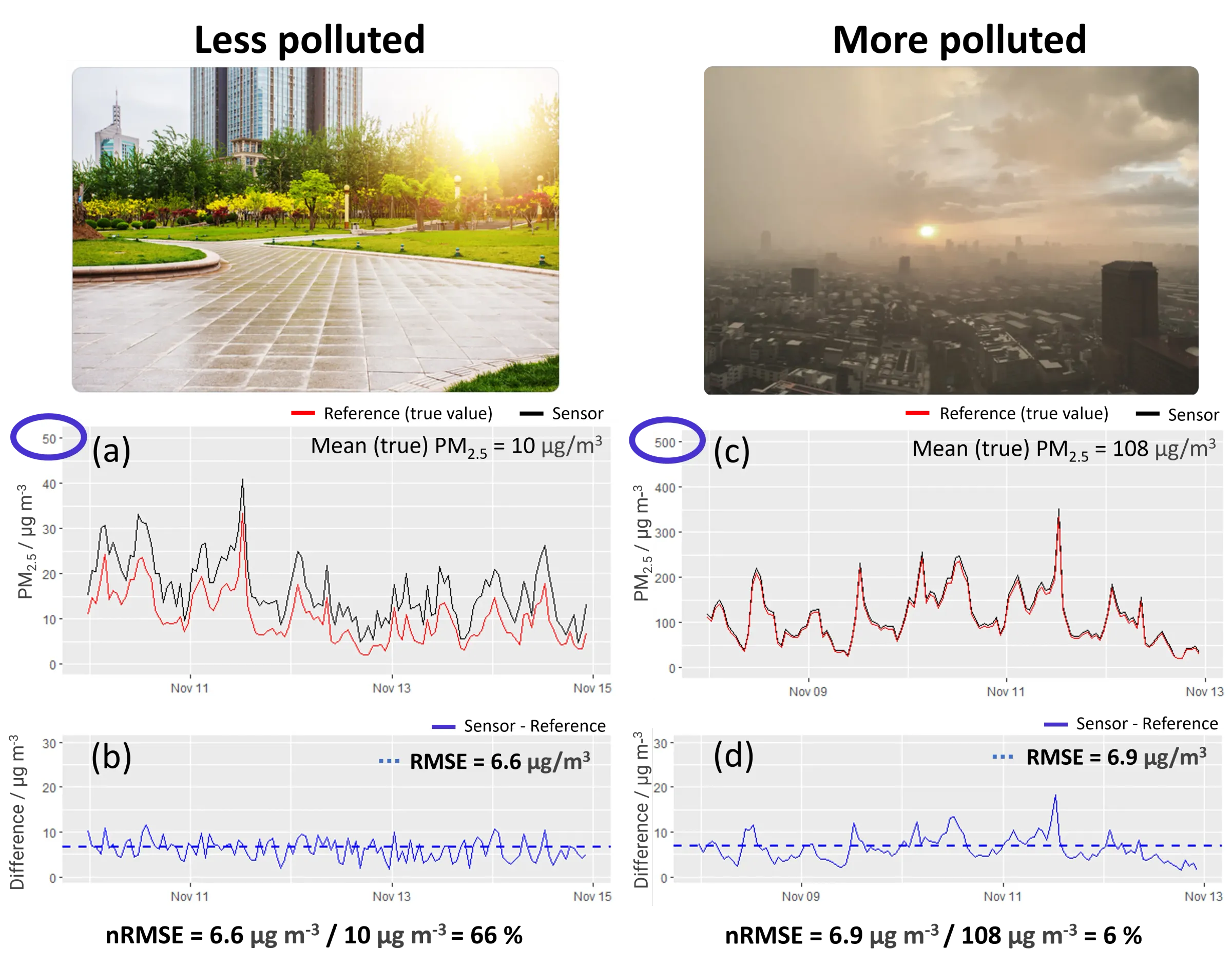

Now, which of the two sensors in Figure 4 would you use? Left or right? Considering the RMSE, both sensors have pretty much the same error. Yet, you would probably go for the right sensor, true? That’s because this one has a lower relative error.
Have a closer look at the pollution levels the two sensors in Figure 4 are exposed to. The particulate matter (PM) concentrations on the right are 10 times higher than on the left. An RMSE (see lower panels) of ca. 7 µg/m³ has a much larger impact on the measurements in the less polluted environment. If we just looked at the RMSE, we would be misled to think that both sensors perform equally well. Here is where the nRMSE comes into play. It is useful for comparing the performance of sensors across environments with different pollution levels. It’s less useful for temperature and humidity sensors.
The nRMSE is calculated by normalizing the RMSE, that means by dividing it by the average (true) measurement value during the testing interval. In our example, this would be the average PM concentration that was measured while the sensor was tested. In the bottom of Figure 4 you can see the calculation of the nRMSE for the polluted and less polluted environment. The sensor in the less polluted environment has an nRMSE of 66%, indicating that its measurements were on average 66% off the true concentration. The sensor in the polluted environment was on average wrong by 6%. So, relatively speaking, the right sensor is more accurate than the left one.
7 Fig 4 Low vs high polluted
Figure 4: Comparison between sensor and reference measurement in a less polluted (left) and a more polluted environment (right; note the different scale of the y-axis). The nRMSE is calculated at the bottom.
