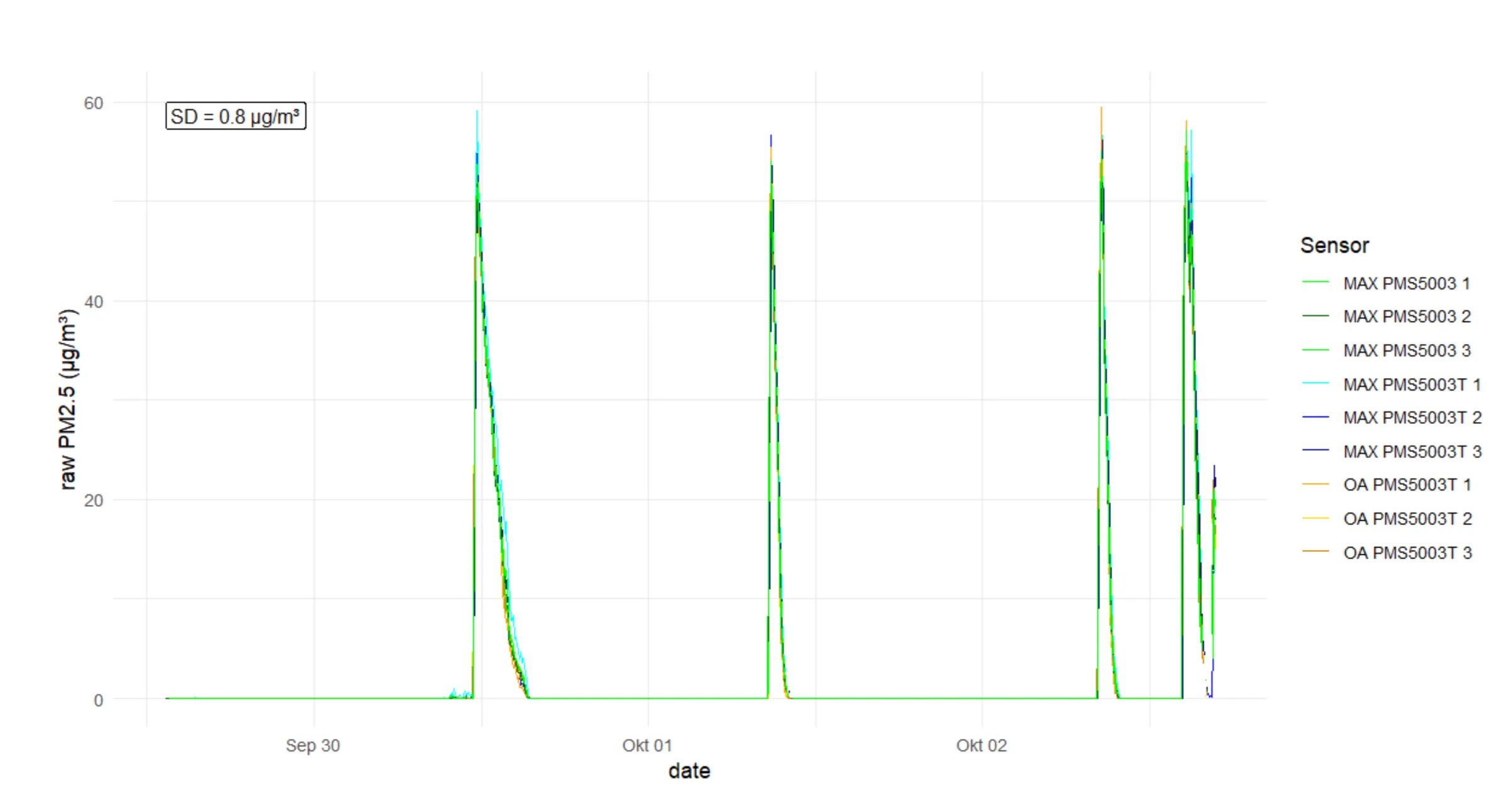

1. Test Chamber: Controlled and Repeatable
Inside our test chamber, all units showed excellent reproducibility:
PM2.5 concentrations in the test chamber
Despite being from different batches and configurations, the raw PM2.5 concentrations across all nine monitors aligned closely throughout the entire concentration range. The standard deviation (SD) is a measure for the differences across the sensors. The value is very low here, indicating an excellent agreement between the sensors. Note that the exposure to clean air (0 µg/m³) in the test chamber between the test runs might drive the SD value lower than you would expect in an ambient environment.
We didn’t observe any systematic difference between the PMS5003 and PMS5003T sensor versions, neither between the Open Air and Open Air Max designs or across different Plantower sensor batches. This is good news as it means that these factors don’t affect the consistency of AirGradient PM2.5 measurements.

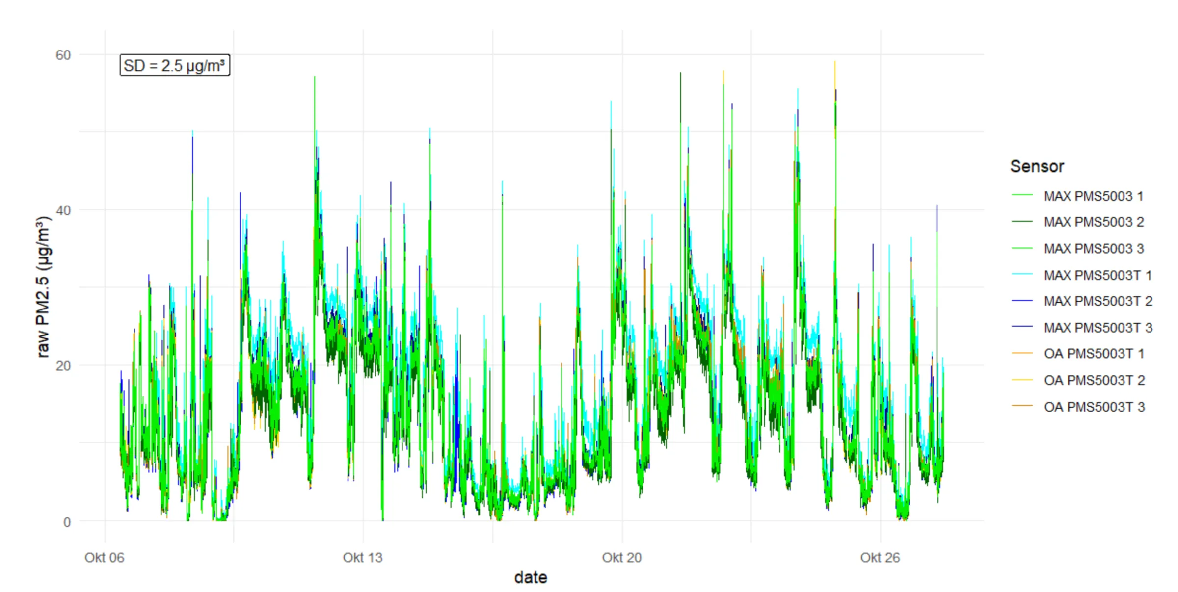

2. Rooftop: Real-World Ambient Air
The true test, however, happens outside.
When we deployed the same nine monitors side-by-side in ambient conditions, exposed to the complex, constantly changing mix of urban aerosols in Thailand, the results held steady.
PM2.5 concentrations in ambient air
Across several days of measurements, we found no significant deviation across the raw PM2.5 readings from the 9 monitors. We expected and found a slightly higher SD value when the sensors are exposed to more natural air pollution patterns instead of long time periods of clean air. An SD value of 2.5 µg/m³ still indicates high agreement between the sensors (the EPA target value is < 5 µg/m³ with hourly data).
In other words: the sensor type and enclosure design had also no measurable influence on the readings in ambient air.

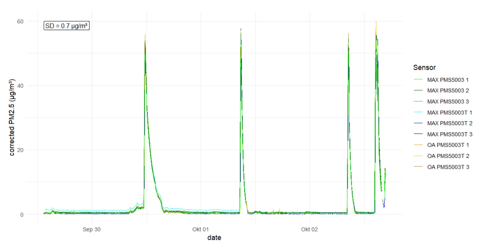

3. Improved Agreement after Calibration
After calibrating all units using incense smoke under our new Test Report v2 protocol, reproducibility improved even further.
PM2.5 in test chamber after calibration
Test Chamber

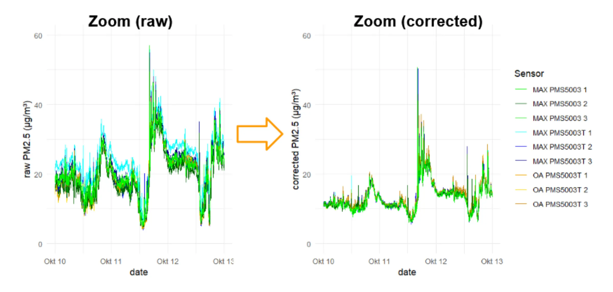

Raw vs corrected ambient air
Ambient Air (Zoom): Raw vs. Corrected
In both the test chamber and ambient air, the units showed tighter alignment (i.e. a better consistency across the sensors) across the entire concentration range after calibration.
Incense remains a valuable calibration aerosol because of its stability and repeatability, even if, as we discussed in our earlier article, it doesn’t fully replicate real ambient aerosol composition.
This consistency confirms that our internal calibration and assembly processes are working as intended: any AirGradient monitor you pick up will deliver data that matches other AirGradient monitors when exposed to the same air.
