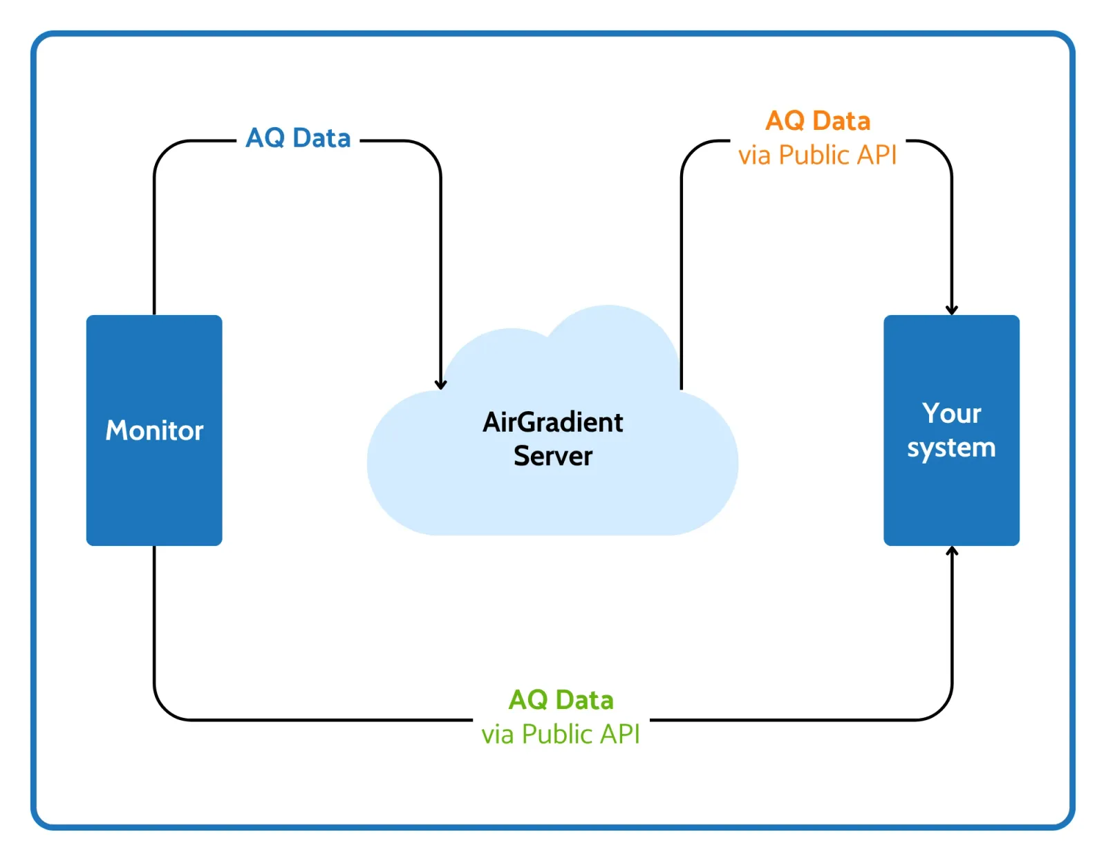

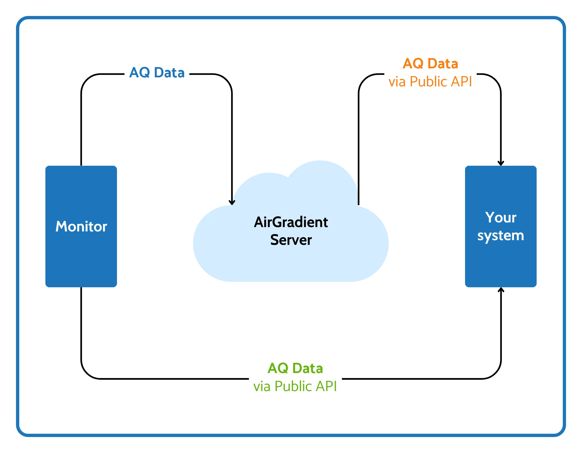

AirGradient supports two types of APIs: a Public API for data hosted on the AirGradient cloud, and a Local API for accessing data directly from the device over a local network. This gives users flexibility depending on whether they want to use cloud-based solutions or prefer local access for privacy or offline use.

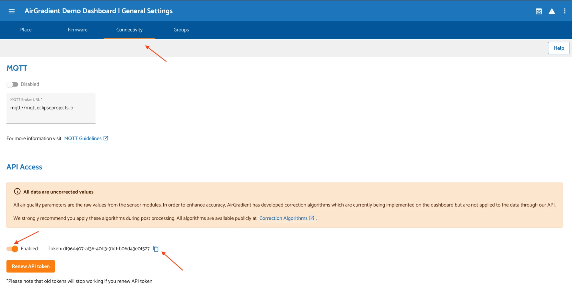

  1. Obtain an API Token: In your AirGradient dashboard, go to the General Settings page under the Connectivity tab. Enable API access, and once successful, you will receive a unique API token.
    connectivity tab

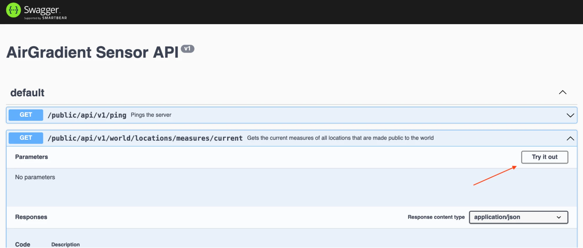

  2. Explore the Public API Endpoints: You can find all available public API endpoints in the Swagger Documentation. This page allows you to try out the necessary endpoints and provides descriptions for each, including the required parameters.

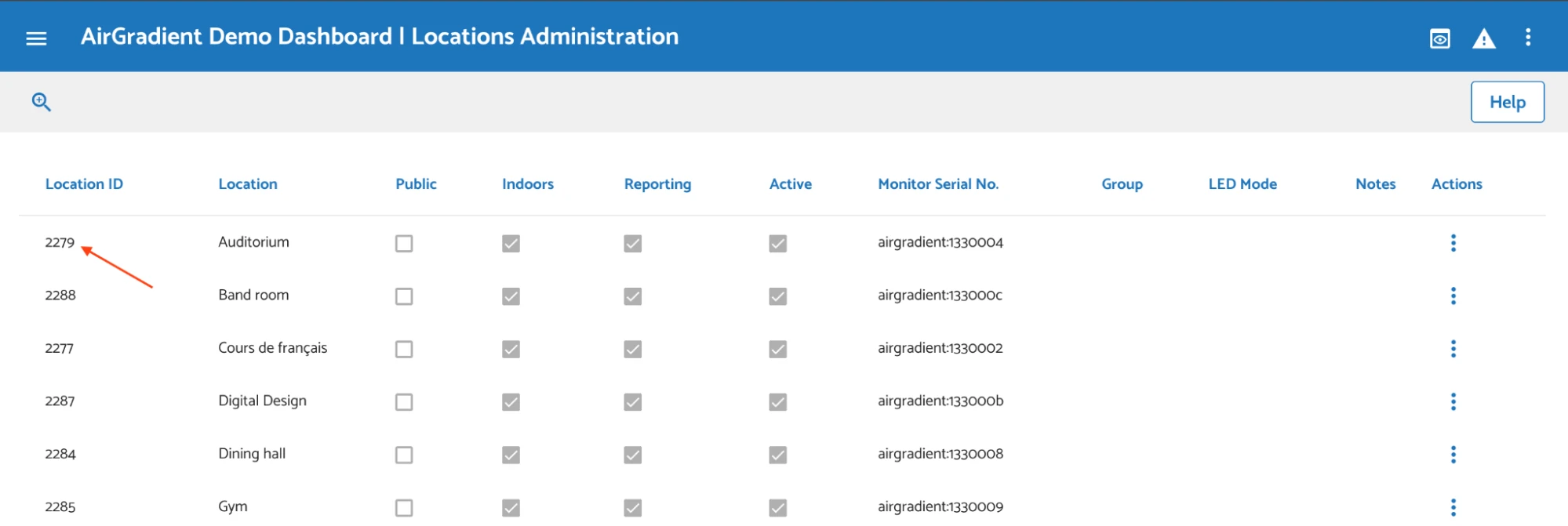

  3. Identify the Location ID: Some of the endpoints require location ID. It refers to the unique ID of the location that your monitor is linked to. It is not the name of the location. To find it, go to your dashboard’s Locations Administration page. In the table of all locations, identify the desired location, and the location ID will be displayed in the first column.
    locations administration

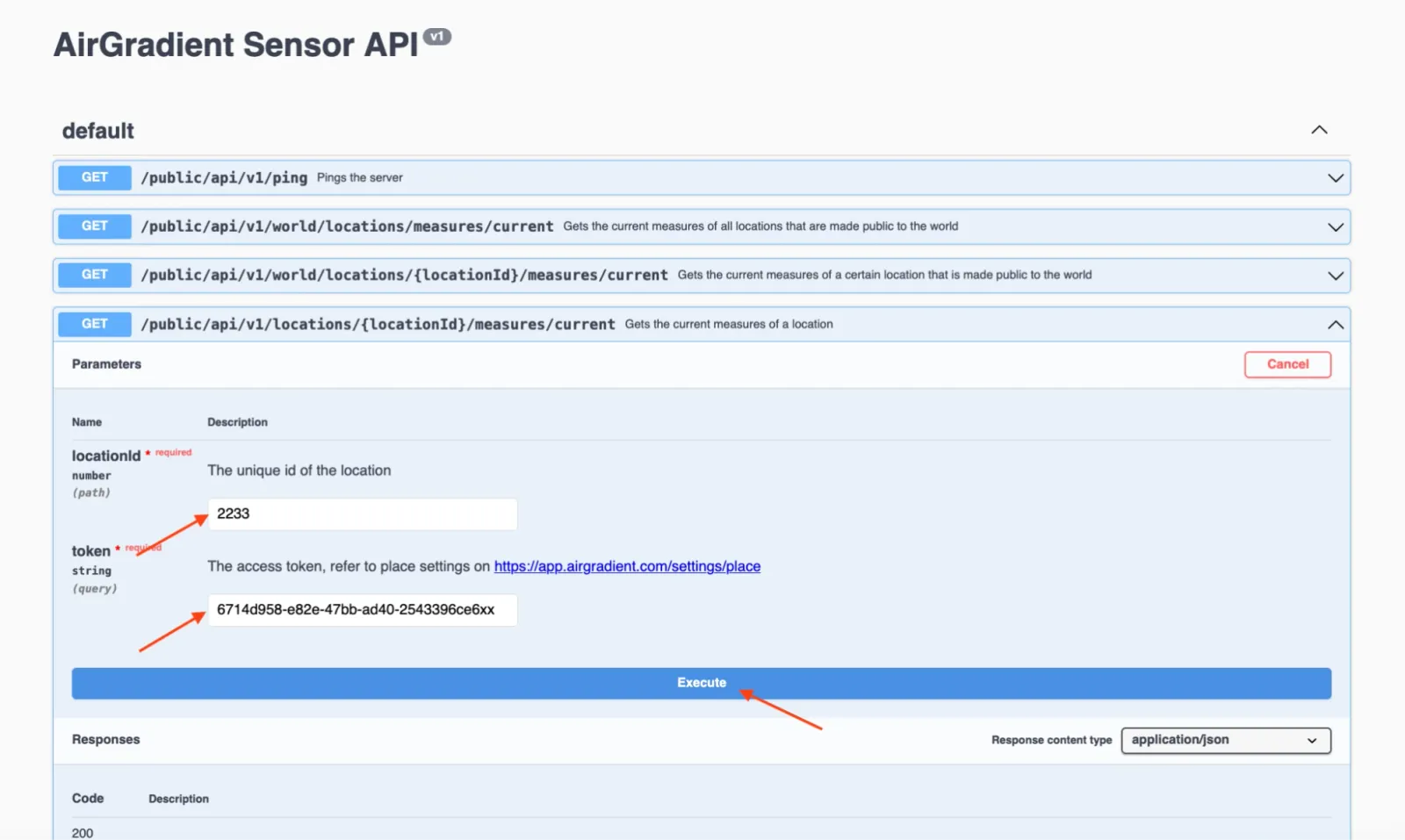

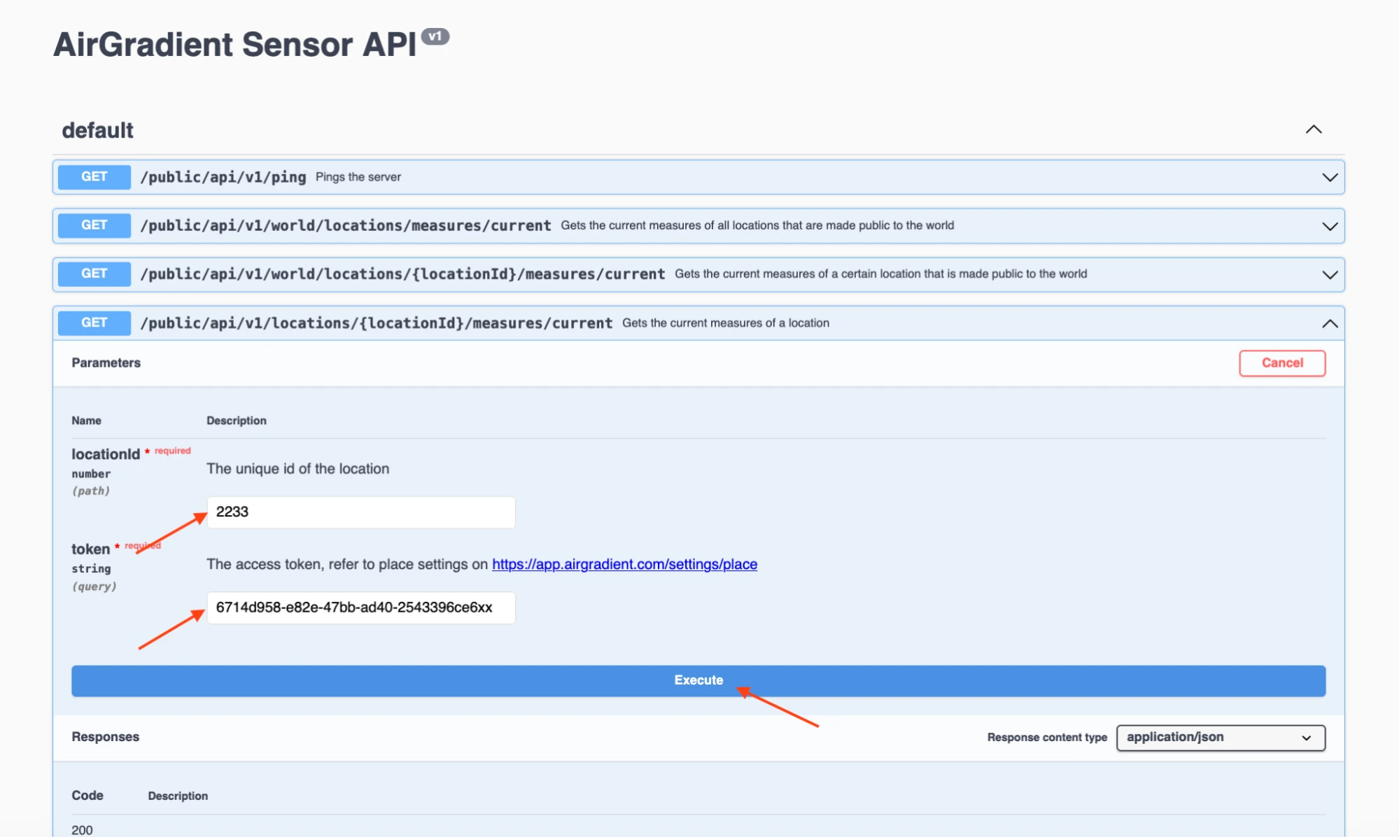

  4. Include Your API Token and Location ID: When making a request, include the API token and location ID (if applicable) that you retrieved from your dashboard in the relevant fields.
    ag api execute
  5. Receive and Use the Data: The API will return the data in JSON format. After receiving the data, you can integrate it into your system or use it for further analysis.

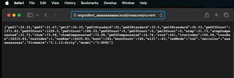

  2. Retrieve measurement data: To retrieve the latest measurements, open browser and access below URL with format:
    {{}}http://airgradient\_**{{SERIAL\_NUMBER}}**.local/measures/current{{}}
    Be sure to change {{SERIAL_NUMBER}} to the serial number (you can find this on the back of your monitor) of the target monitor, so it will be like:
    {{}}http://airgradient\_aaaaaaaaaaaa.local/measures/current{{}}
    ag api response measures

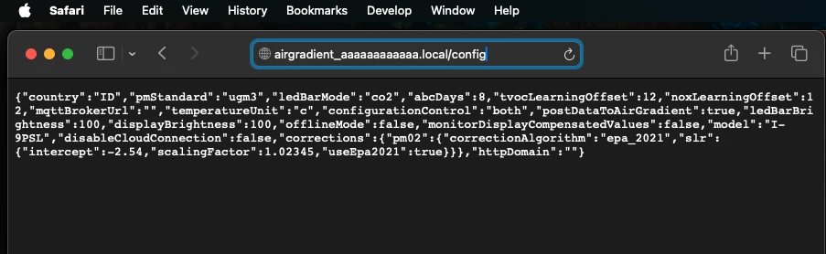

  3. Retrieve local configuration: To retrieve local configuration, same as point 2 but the URL format as follow:
    {{}}http://airgradient\_**{{SERIAL\_NUMBER}}**.local/config{{}}
    ag api response config
  4. Receive and Use the Data: The API will return the data in JSON format. After receiving the data, you can integrate it into your system or use it for further analysis.
