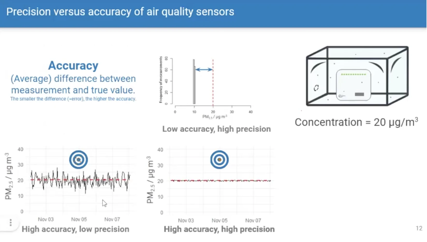

  • Detailed Reports: Maybe your community (e.g. policy makers) is more data driven and is more interested in understanding air quality data in greater detail. If this is the case, try providing them with in-depth scientific reports, case studies, or presentations. An example is seen in figure 2.
airquality forum
precision vs accuracy
Figure 2: Air Quality Forum reporting on EPA Sensor Correction
