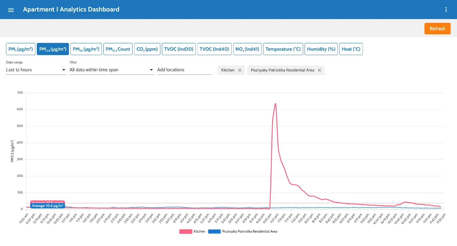

1.2 Analytics Page
Figure 4: Analytics Page
Link: https://app.airgradient.com/dashboard/analytics
Analyze and compare your locations' data for specific measures over different time periods. You can select locations, time frames, and the desired measure for comparison.
The blue boxes along the top of the screen allow you to choose which pollutants to graph. Underneath this, you can select the data range (please keep in mind that free dashboard accounts have limited historical data), filter, and the monitors you want to graph. You can add multiple monitors, including different types of monitors (for example, you can graph the PM2.5 readings from an Open Air Max and Open Air Cellular on the same graph).
This page allows you to quickly and easily identify trends in your air quality. However, if you want to carry out more advanced analysis, we recommend exporting the data.
Important note: on the dashboard, you can only graph one pollutant at a time. If you want to compare trends across pollutants, please visit the data export page (discussed below) and export your data for comparison.

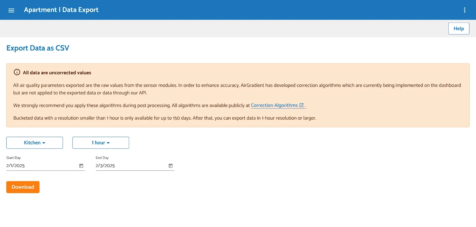

1.3 Export Data Page
Figure 5: Data Export page.
Link: https://app.airgradient.com/dashboard/export
This page lets you export data in table format (excel format) for a specific period and measure.
To export data, you will need to select the location (monitor) that you want to export data from, the bucket (the averaging period) and the start and end date of the exported data. Please note that raw data is only kept for 10 days.
Once you click ‘Download’ a CSV file will be generated and downloaded through your browser. Please allow this download, and save it in a location that is easy to relocate.

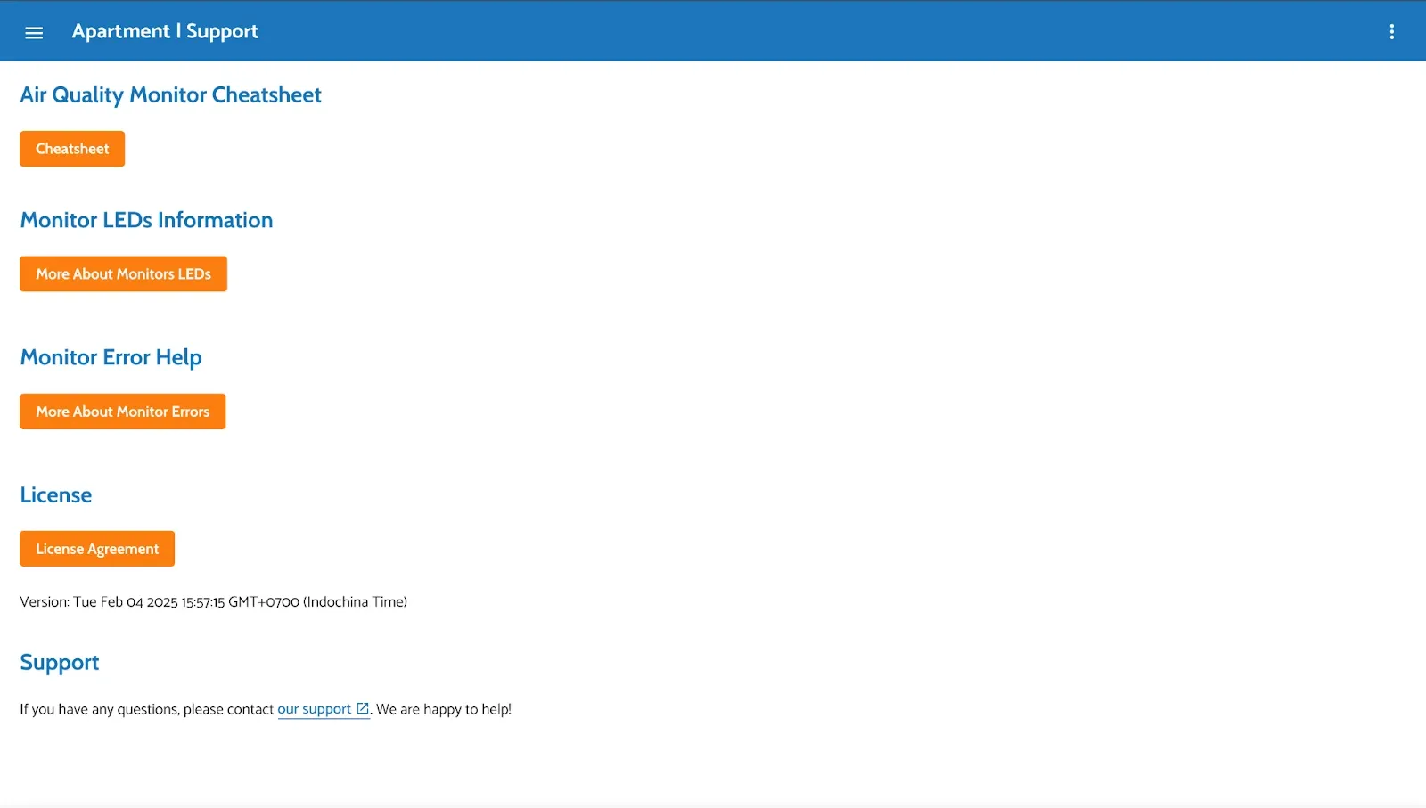

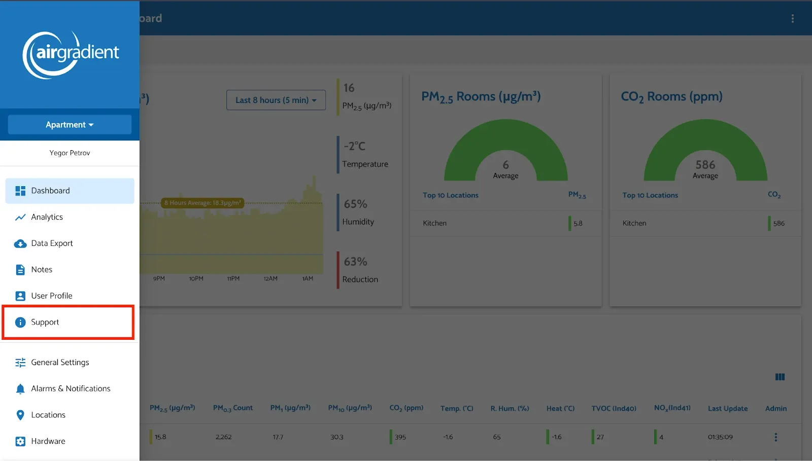

1.6 Support Page
If you would like some help or just want to learn more, you can do so anytime by going to the Support page.
Figure 9: Support sidenav menu item
After pressing you appear on our support page:
Figure 10: Support Page

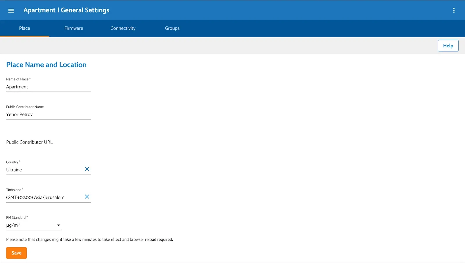

1.7 General Settings
Link: [https://app.airgradient.com/settings/place](https://app.airgradient.com/settings/place)
In General Settings, you have many different tabs which house most of the dashboard and monitor settings.
Figure 11: General Settings Page
Let's go through each one:
Place
Link: https://app.airgradient.com/settings/place?tab=0
You can configure place settings such as the place name, public contributor name, public contributor URL, temperature measurement unit, timezone, and country. You can also set the PM standard for the entire place.
Place Name - the name of your place for where you’ve installed the
Public Contributor Name - will be provided to all 3rd parties you share data with and is then often displayed together with the air quality data you share on their application. It can be your personal name or the name of the organisation / company that owns the monitor. You can also leave the Public Contributor Name empty in case you do not wish to be named.
Additionally, you can enable Advanced Configuration, which adds two extra tabs:

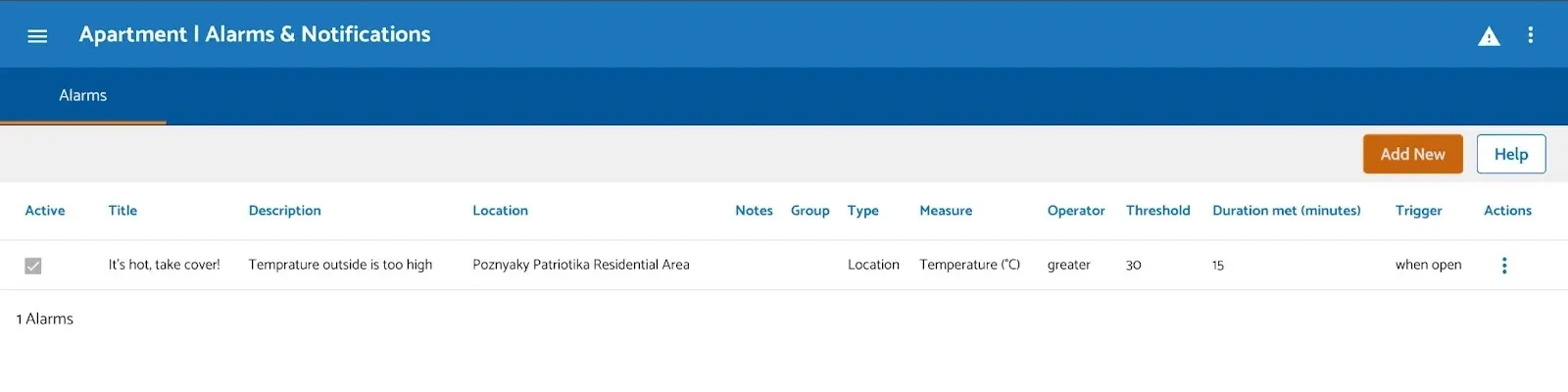

Alarms on the AirGradient Dashboard are alerts or notifications triggered when air quality measurements exceed predefined thresholds or meet specific conditions. They help users monitor and respond to significant changes in air quality, such as:
  • High levels of pollutants (e.g., PM2.5, PM10, CO2, VOCs)
  • Temperature or humidity beyond comfortable ranges
  • Custom-defined alerts based on user settings for specific air quality metrics.
These alarms can be configured to display prominently on the dashboard and may also send notifications via email or other channels, depending on the system setup. Their purpose is to ensure prompt action when air quality reaches unhealthy or concerning levels.

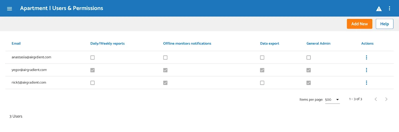

1.11 Users & Permissions
Figure 17: Users & Permissions Page
Here, you can define users and their permissions for the place. Users can be added, deleted, or edited.
When adding new users, you can select exactly what permissions they get and what features they can access. It’s important to note that, depending on what permissions you give each user, they may not be able to access certain parts of the dashboard.
You can also send an email to any new users who are added to the dashboard, allowing them to quickly access the dashboard they now have access to.

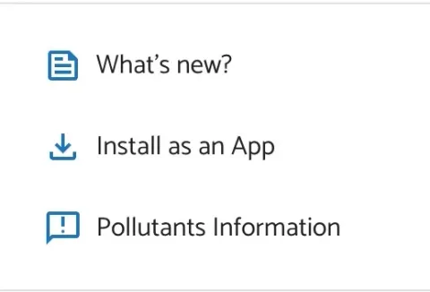

1. What’s New? - This tab keeps you updated on the latest dashboard updates and releases. We'll regularly update it so you can always stay informed.
2. Install as an App - You can install our dashboard on your device with just one click! Simply tap this option to add it to your home screen and enjoy quick access to your dashboard.
3. Pollutants Information - Here, you can learn about pollutants, their harmful effects, and ways to combat them!

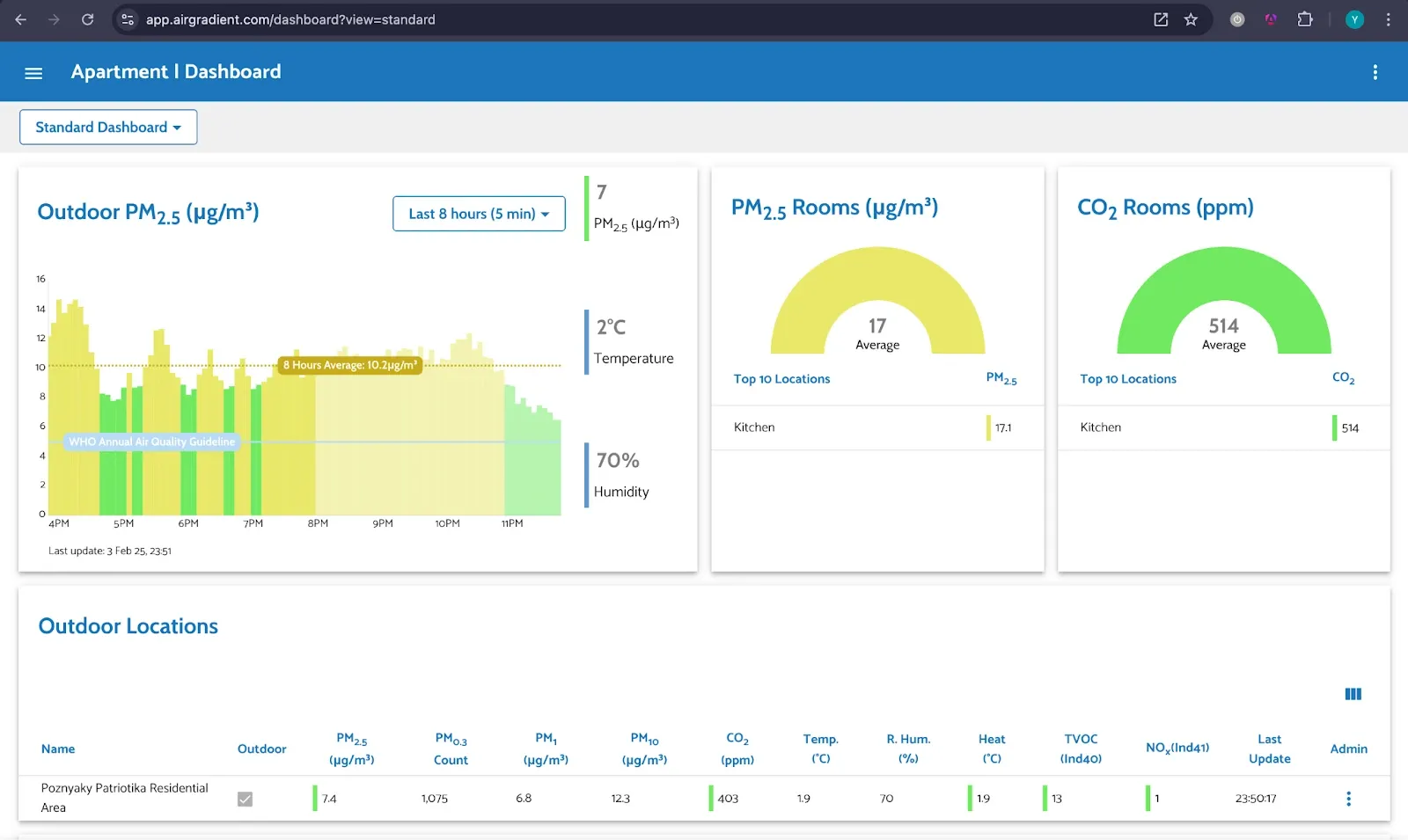

The Standard Dashboard View offers a comprehensive snapshot of key air quality indicators across all monitored locations, while the Custom Dashboard View empowers users to drill into specific data points by selecting locations, time ranges, and even adjusting monitor settings. Together, these dashboards provide both at-a-glance clarity and in-depth analysis, ensuring you stay informed and in control.
3.1 Standard Dashboard View
Figure 19: Standard Dashboard

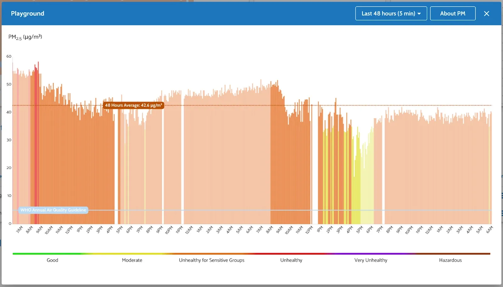

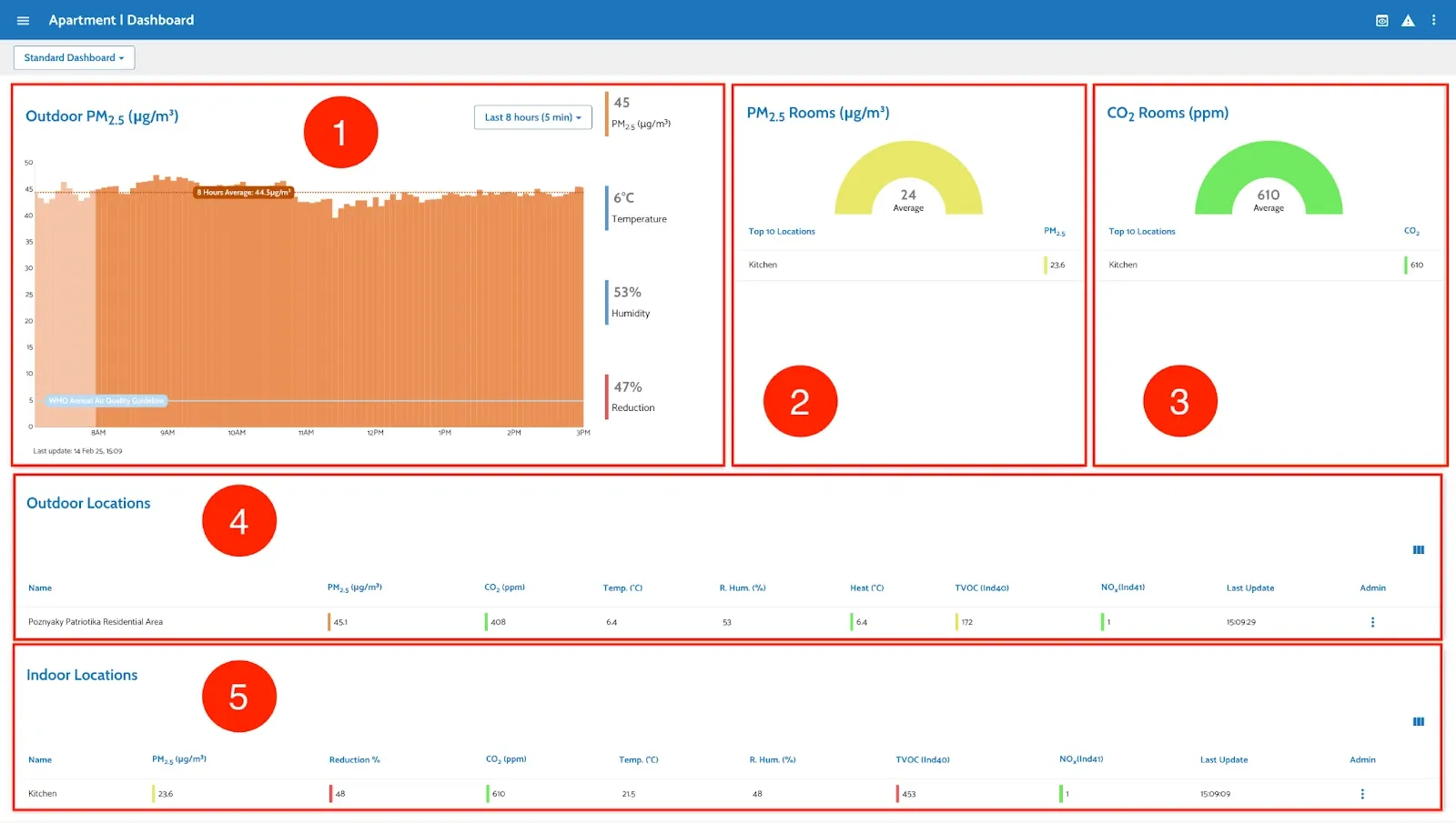

Here’s a quick overview of what we have on the AirGradient dashboard based on the image and general information about AirGradient's platform:
Outdoor PM2.5 (µg/m3) Graph
This section provides a detailed real-time graph of outdoor PM2.5 levels over time. It includes:
  • A trendline showing the concentration of PM2.5.
  • An average value for the selected time period.
  • Temperature, humidity, and reduction percentage indicators to help assess air quality trends.
  • A WHO guideline indicator for reference.
PM2.5 Rooms (µg/m3) Overview
This section displays the indoor PM2.5 levels, showing:
  • A gauge with the current average PM2.5 value.
  • A list of the top indoor locations with their respective PM2.5 measurements.
CO2 Rooms (ppm) Overview
This section provides a similar gauge but for CO2 levels indoors, showing:
  • The current average CO2 concentration.
  • A list of indoor locations with their CO2 readings.
Outdoor Locations Data Table
This section presents a table summarizing the air quality measurements from outdoor monitoring locations. It includes:
  • PM2.5, CO2, temperature, humidity, heat index, TVOC and NO2 values.
  • The last update timestamp.
  • Admin options for further management.
Indoor Locations Data Table
Similar to the outdoor table, this section displays key air quality metrics for indoor locations, including:
  • PM2.5 levels and reduction percentages.
  • CO2 concentration, temperature, humidity, TVOC, and NO2 values.
  • The last update time and admin options.
This dashboard provides a comprehensive overview of air quality, helping you to monitor and improve indoor and outdoor environments.

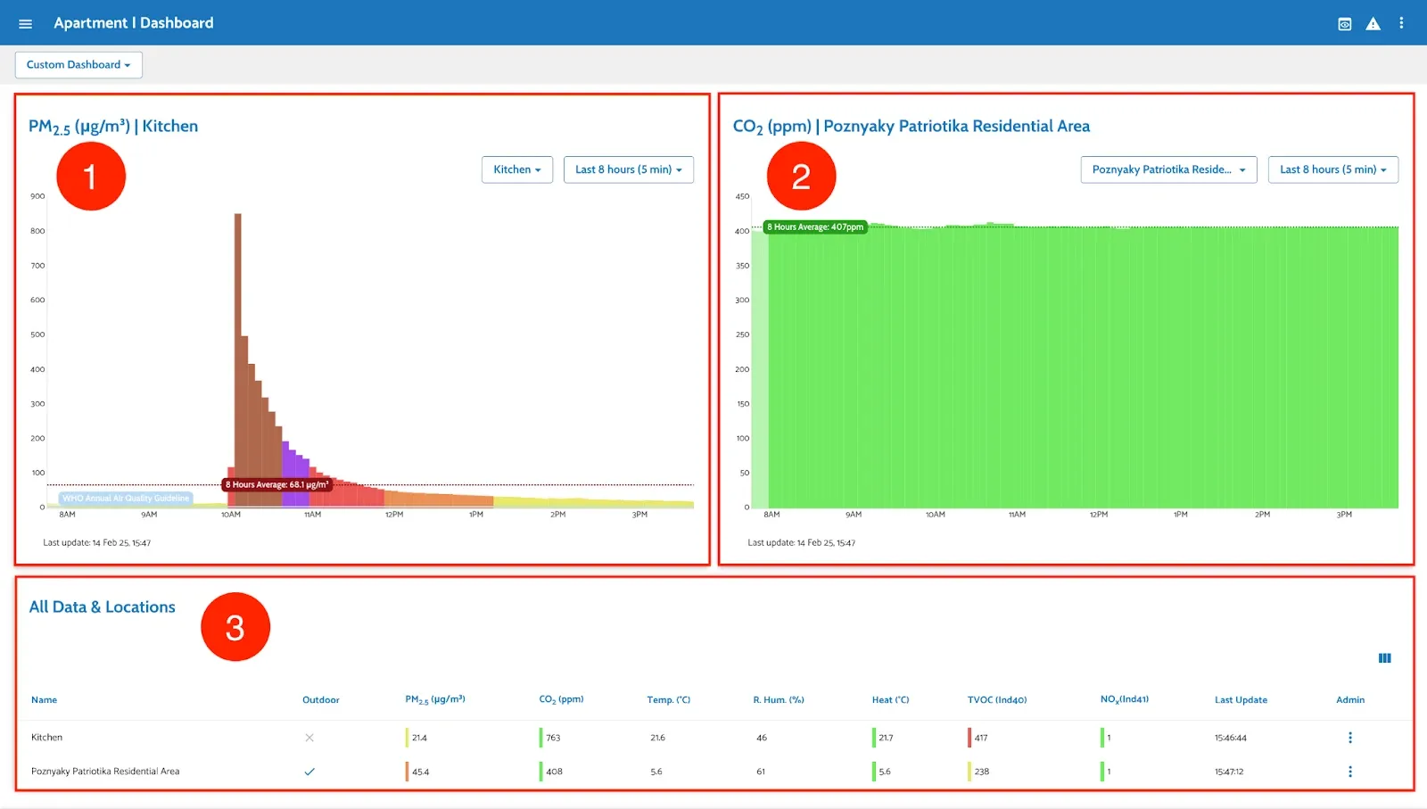

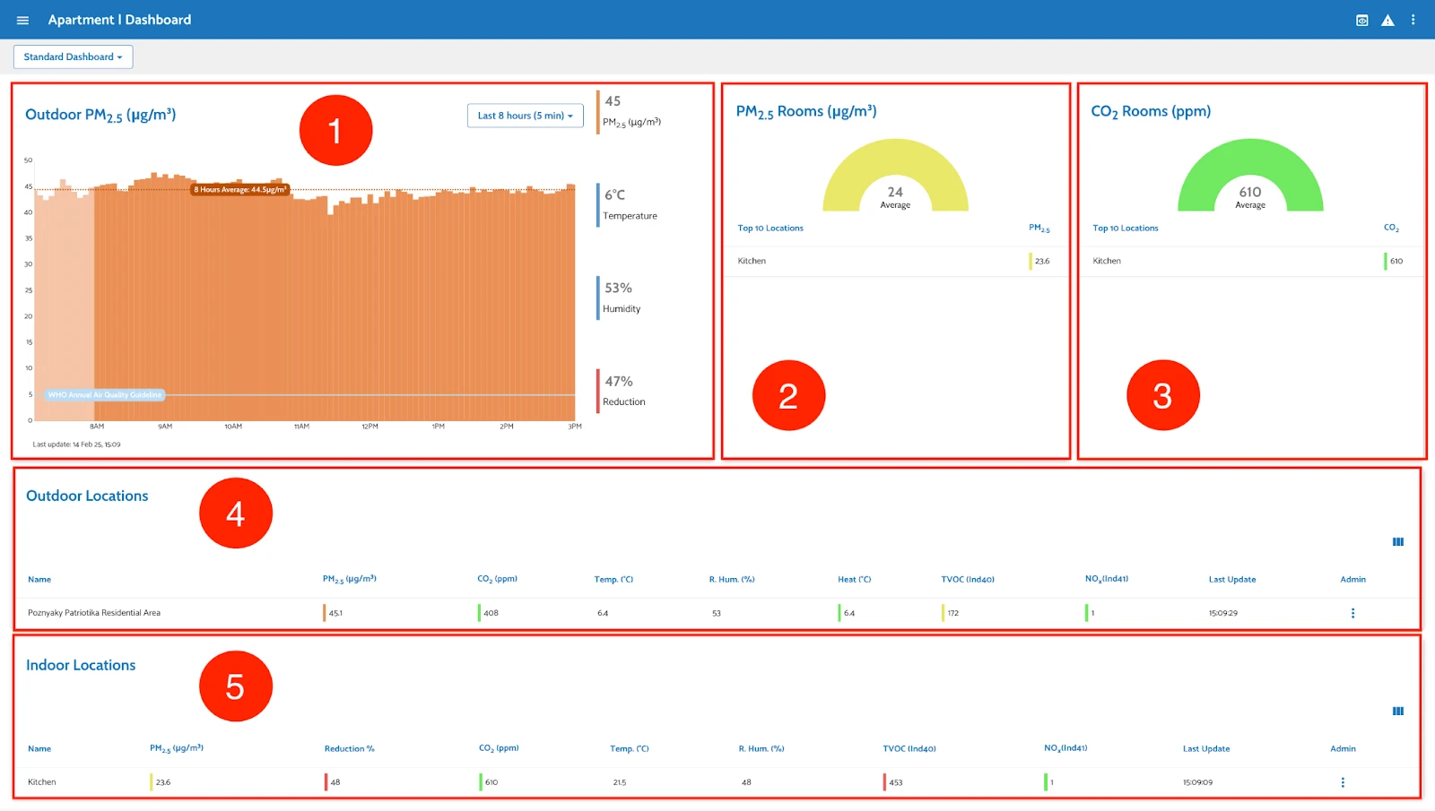

All Data & Locations Table
  • A comprehensive table summarizing air quality metrics for all selected locations.
  • Includes PM2.5, CO2, temperature, humidity, heat index, TVOC, and NO2 levels.
  • Shows whether a location is outdoor or indoor.
  • Displays the last update time and admin management options.
The Custom Dashboard allows users to customize their view by selecting specific locations and time periods, making it a flexible tool for analyzing air quality trends.
Additionally, you can configure most of the settings for your monitors. By clicking Edit Monitor under the actions of a specific location, you can:
  • Adjust basic configuration settings (e.g., name, notes, etc.).
  • Set brightness levels.
  • Make your location public (if it's an outdoor location).
You can also view detailed charts for specific measures by clicking on them to see data for a selected period.
Figure 21: Measure value in locations tables.

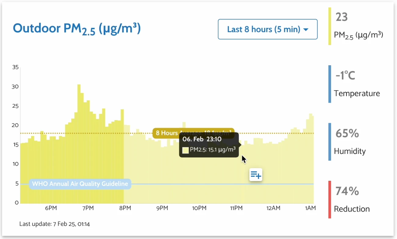

By pressing on the measurement value of your interest, you’ll be taken to the chart:
Figure 22: Chart of measured values for a specific time range.

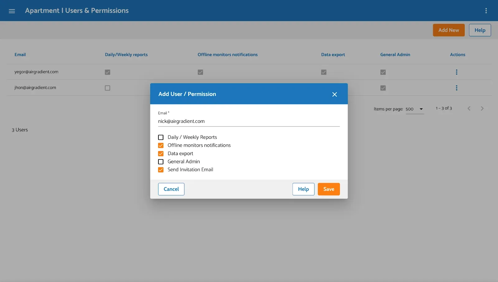

How can I add my friends to a place?
By going to ‘Users and Permissions’ and pressing the ‘Add New’ button, you will be prompted to enter your friend's email address and select the permissions to grant them.
Figure 26: ‘Add User/Permission’ window
