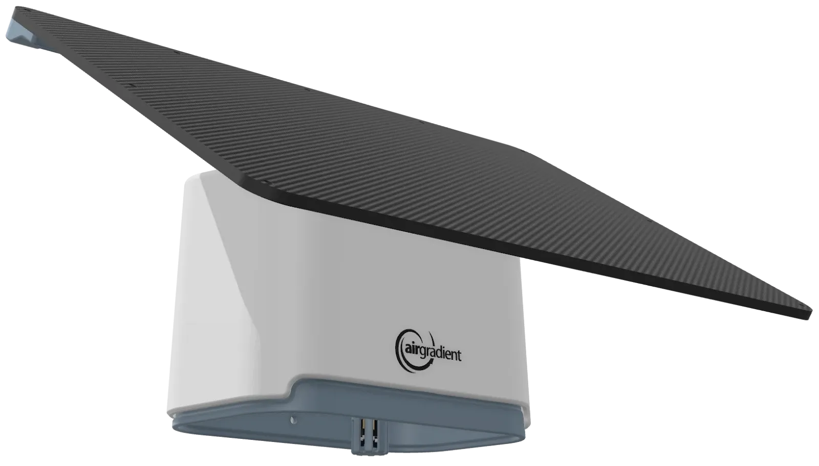

5. Selecting Appropriate Monitors
AirGradient offers different monitor models with varying connectivity. Make sure you get the correct monitors for the selected site characteristics.
Open Air
Open Air (O-1PST)
Open Air Cellular (O-1PST-CE)
Open Air Max (O-M-1PPSTON-CE)
Figure 1: AirGradient Monitors {.text-center .font-italic}

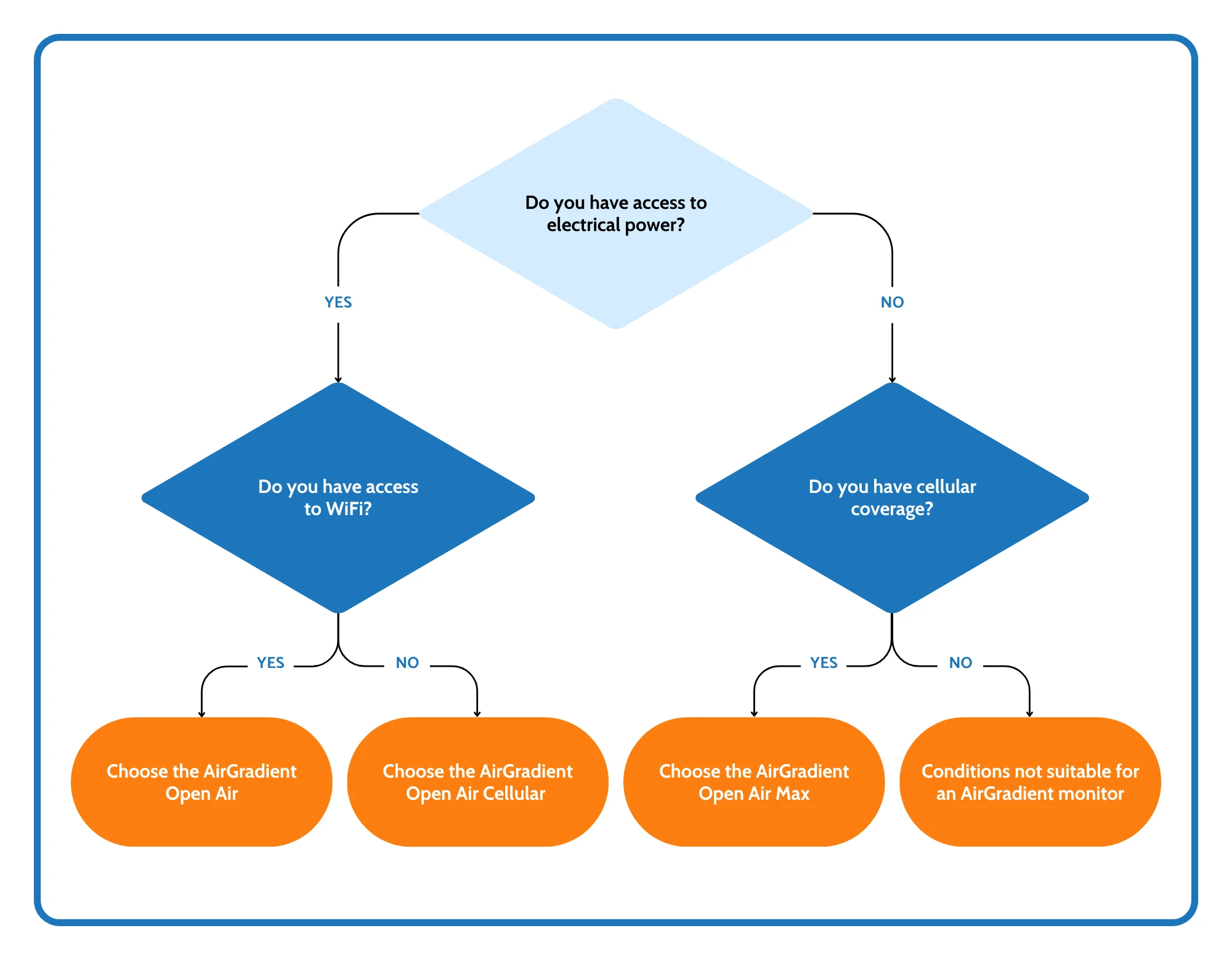

Decision Map
Figure 2: Decision Map
Site Characteristics Connectivity Options AirGradient Model Parameters Measured
Locations with reliable WiFi. Residential areas, schools, offices, community centers. WiFi Open Air PM, CO2, VOCs (optionally without CO2 but dual PM)
Locations with cellular coverage, where WiFi is unreliable or unavailable. Areas with limited infrastructure, remote urban locations. Electric mains power is readily available. Cellular (LTE Cat 1) Open Air Cellular PM, CO2, VOCs (optionally without CO2 but dual PM)
Locations with cellular coverage, where WiFi and electrical power is unreliable or unavailable. Also useful for very easy deployment as no setup to WiFi or electrical connection is needed. Cellular (LTE Cat 1) & Solar Power Open Air Max (Cellular & Solar) Dual PM, CO2, NO2, O3, VOCs (optionally without NO2, O3)
Cellular Connectivity Note: AirGradient cellular monitors use LTE Cat 1, a common cellular standard compatible in areas with smartphone connectivity. Check local cellular provider coverage maps to ensure adequate signal strength.
Solar Panel Note: The AirGradient Max utilizes a 10w solar panel that is suitable in latitudes from roughly 0 - 45N/S. In regions closer to the poles, a 2nd solar panel can be deployed to ensure a reliable energy supply.

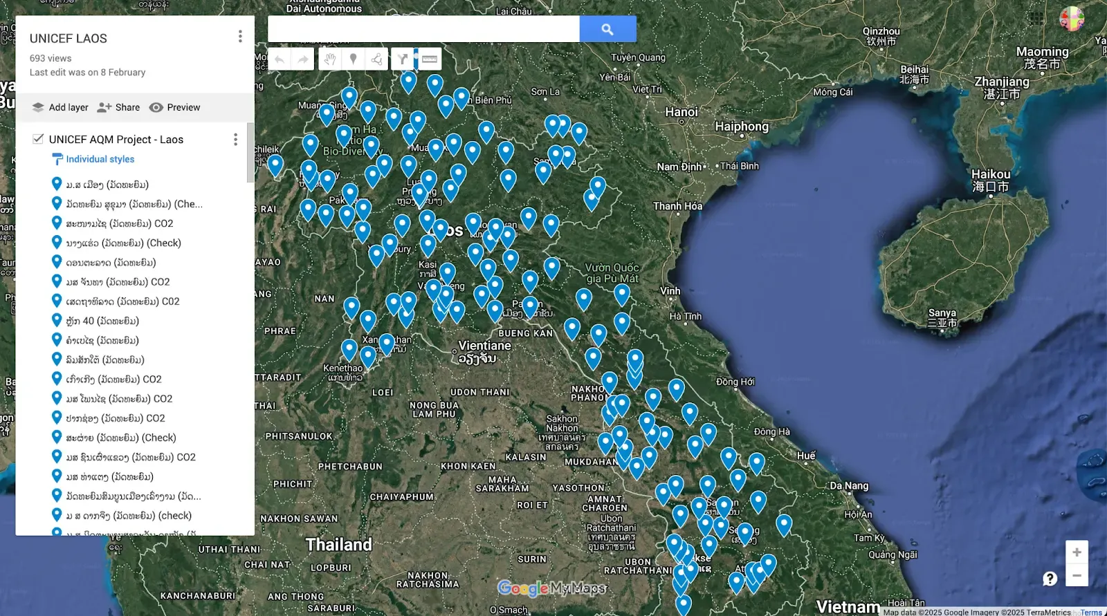

How can I use Google Maps "My Maps" for Site Planning?
Google Maps "My Maps" is a helpful tool for visualizing and planning your monitor locations across your city.
  1. Create a New Map: Go to Google My Maps and create a new map for your monitoring area
  2. Mark Potential Sites: Use the "Add marker" tool to mark potential monitor locations on the map.
Searchbar

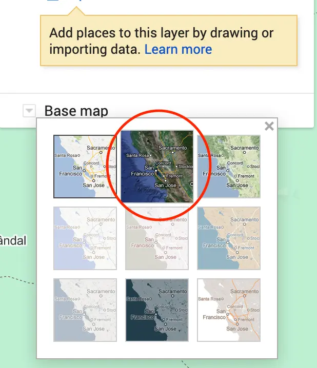

  1. Utilize Satellite Imagery: Switch to satellite view to examine the surroundings of each site. Use satellite imagery to identify potential pollution sources, wind obstructions, and general site characteristics.
Layer Selection
  1. Add Notes and Information: Add notes to each marker about power, network, accessibility, and environmental factors.
  2. Share and Collaborate: Share your map with your team to discuss and refine site selections.
Map to visualize sites in Lao PDR.
Example of using My Map to visualize sites for a Project in Lao PDR.
