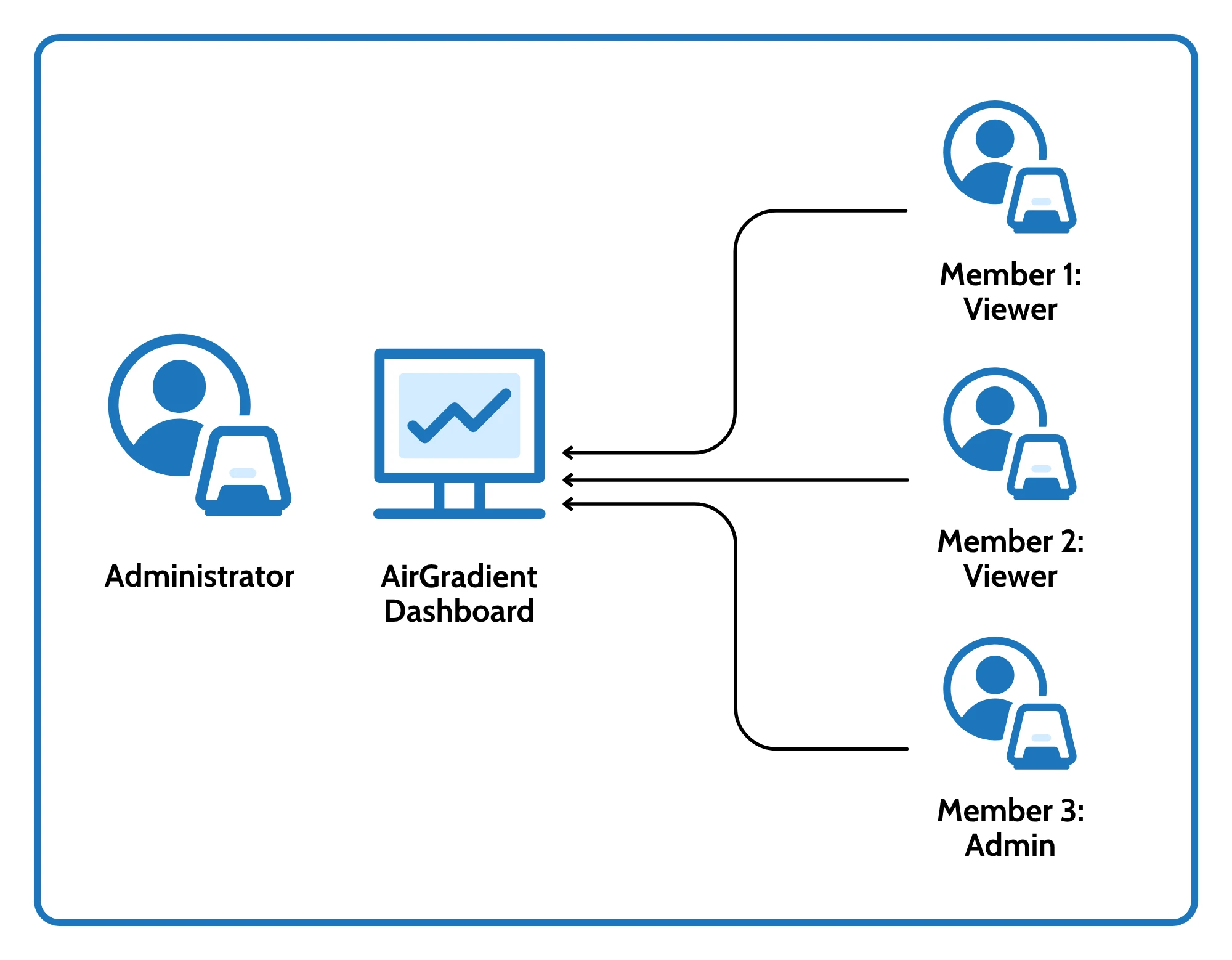

Different roles accessing the same dashboard
Figure 1: Different roles accessing the same dashboard
When the very first monitor for your project or group is registered to the AirGradient Dashboard, the system grants initial administrative access only to the person who performed this registration, using the email address they provided during that process. This person becomes the initial owner or primary administrator.
Additional users must be invited by an existing Administrator or the Owner associated with your specific Place. Again, please keep in mind that invitations are managed at the Place level. Administrators can add new users by entering their email addresses and assigning specific Permissions or Roles (e.g., 'Viewer' to only see data, or 'Admin' with broader controls over settings and user management within that Place). This controlled invitation process ensures data security.
