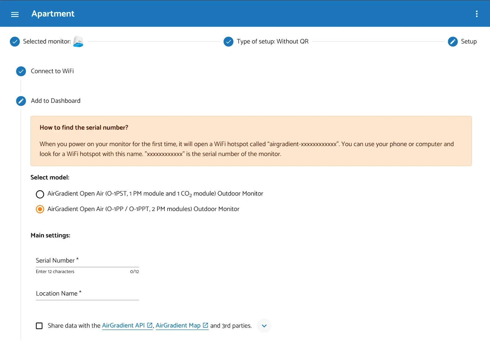

When setting up a new AirGradient Open Air monitor, go to the onboarding page: (https://app.airgradient.com/onboarding/welcome):
  1. Serial Number Entry:
    • Choose the type of monitor model and configure the main settings.
Onboarding page
Figure 1: Onboarding page, ‘Add to Dashboard’ step

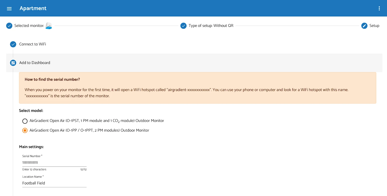

  1. Select Model and Main Settings:
    • Enter the unique 12-character serial number found on the back of your device, or shown when connected to Wi-Fi.
Onboarding page, Entered Serial Number & Location Name
Figure 2: Onboarding page, ‘Add to Dashboard’ step | Entered Serial Number & Location Name

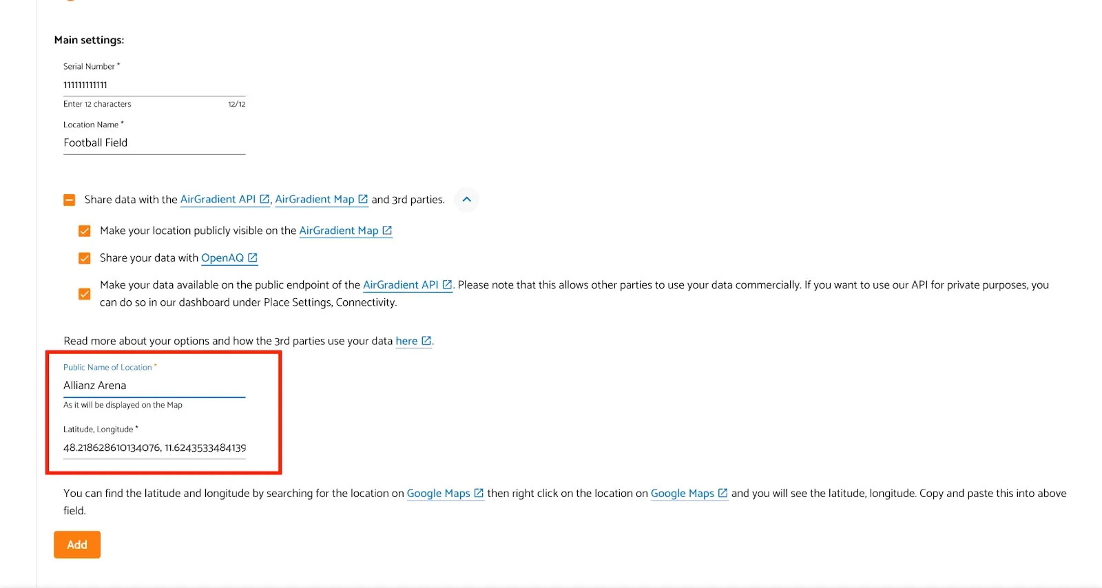

  1. Data Sharing Options:
    • Just as in the Dashboard view, you will see the options to share data with AirGradient API, Map, and OpenAQ.
    • Enter the location coordinates and contributor name (optional). The contributor name will then appear on the AirGradient map and also on the API.
Onboarding page, Public Name of Locations and Latitude & Longitude fields
Figure 3: Onboarding page, ‘Add to Dashboard’ step | Public Name of Locations and Latitude & Longitude fields

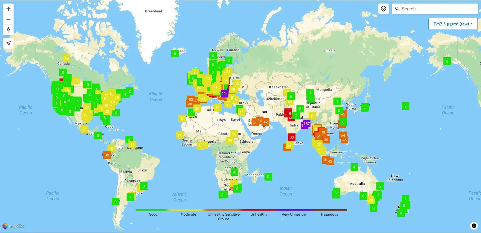

By sharing your data, you become part of a community that is raising awareness about air quality worldwide!
AirGradient Community on the map
Figure 4: AirGradient Community on the map

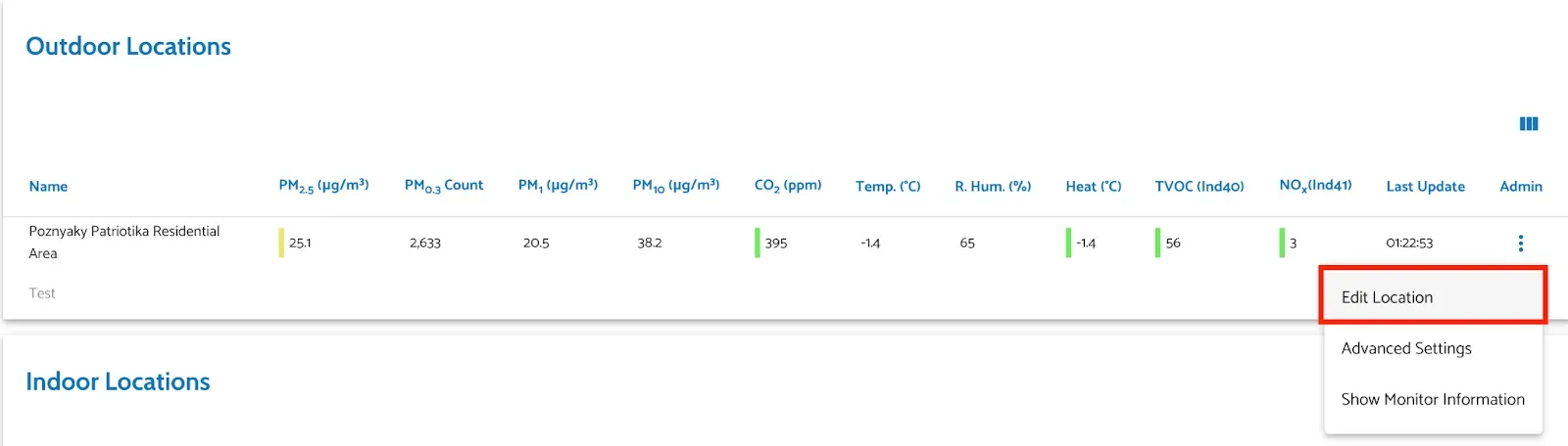

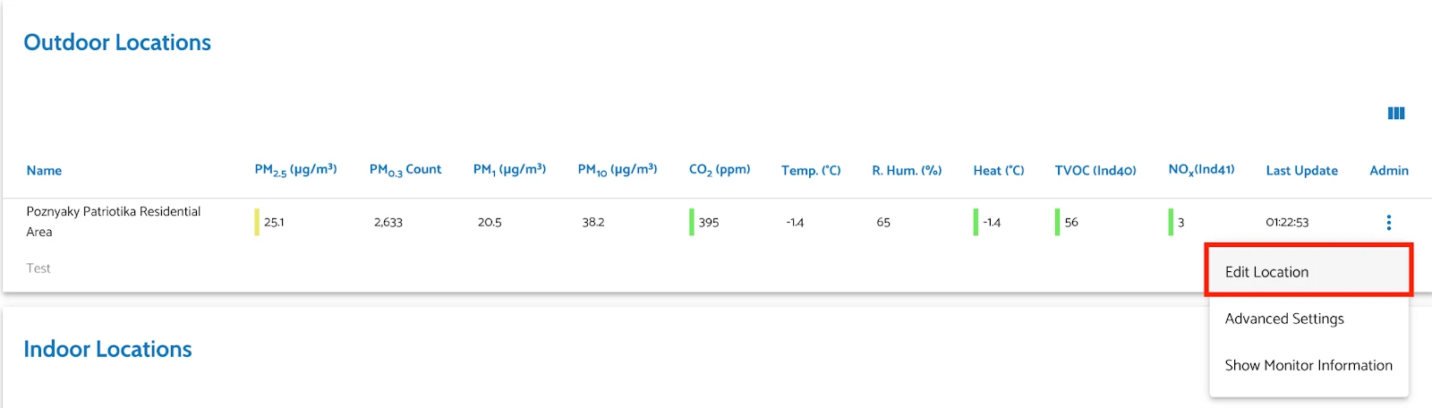

  1. Go to Edit Location
    • Find the desired location on your Dashboard in the table of Outdoor Locations.
    • Click on Edit Location
      Edit Location menu item in location’s actions column
      Figure 5: Edit Location menu item in location’s actions column

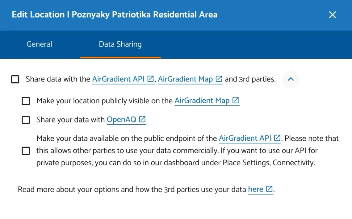

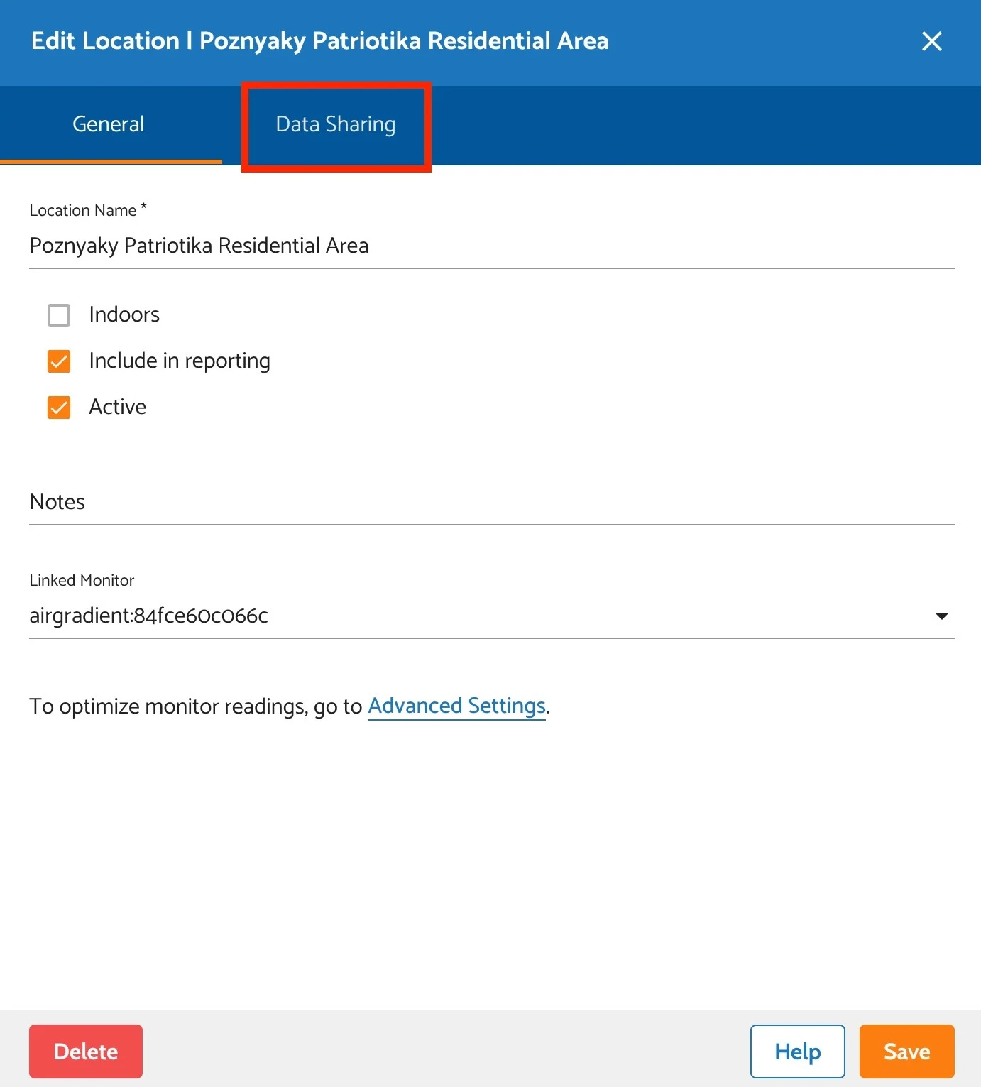

    • Go to the Data Sharing tab
      ‘Data Sharing’ tab in ‘Edit Location’ window
      Figure 6: ‘Data Sharing’ tab in ‘Edit Location’ window

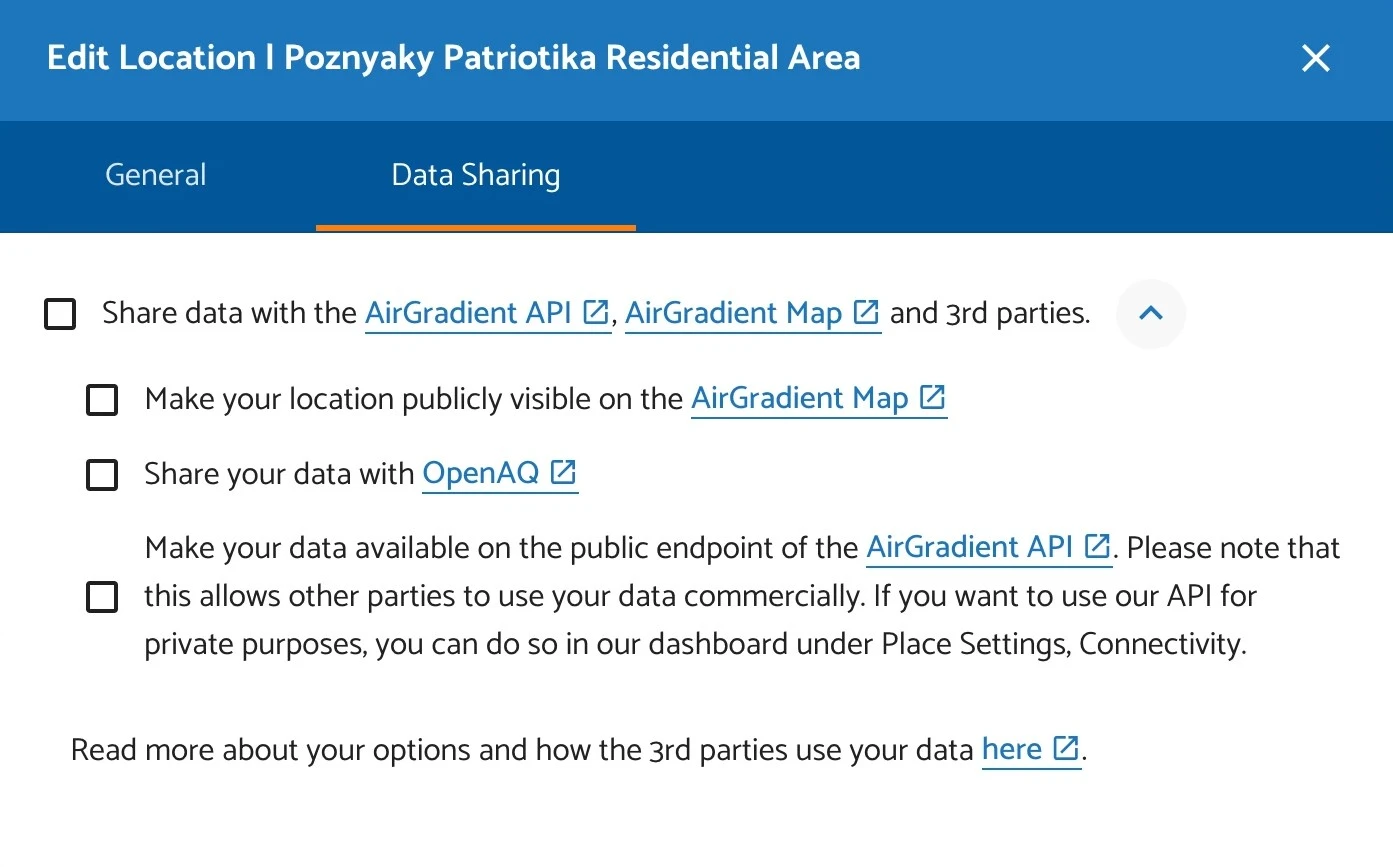

  2. Choose Sharing Options:
    • You will find checkboxes for sharing your data with:
      • AirGradient Map - a real-time, global map that displays air quality data, primarily sourced from open-source AirGradient monitors.
      • OpenAQ - a global repository of air quality data used by many organizations and research institutions. AirGradient is an official partner of OpenAQ and strongly supports their mission, as well as share the same ethos around open data. By sharing data to OpenAQ,
      • AirGradient API - allows access to air quality data from their open-source, open-hardware monitors, enabling users to integrate this data into other systems or applications.
    Sharing options on ‘Data Sharing’ tab
    Figure 7: Sharing options on ‘Data Sharing’ tab

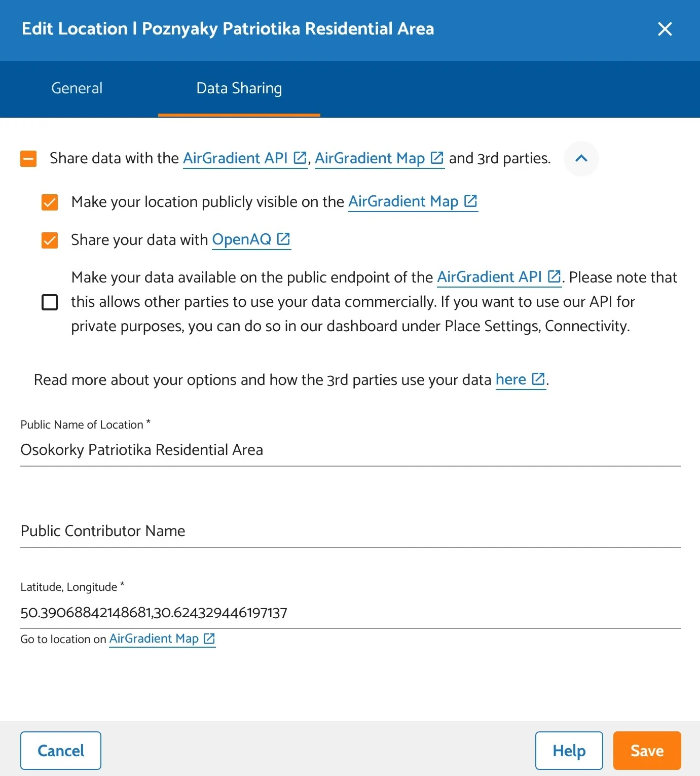

  3. Enter Location Information:
    • Latitude & Longitude: You can copy your monitor’s coordinates from Google Maps.
    • Location Name: Give a recognizable name to your monitor’s location.
    • Public Contributor Name (optional): Add a name if you wish to be credited.
      Filled up form on ‘Data Sharing’ tab
      Figure 8: Filled up form on ‘Data Sharing’ tab

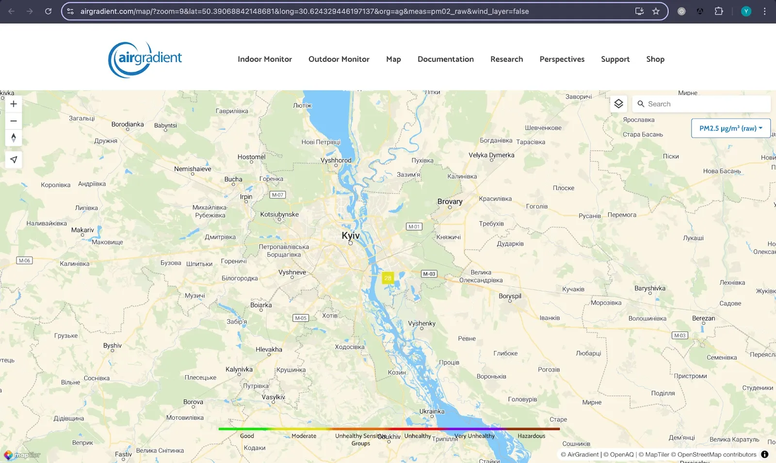

Please note that by pressing 'Go to location on AirGradient Map,' you will be taken to our map with the exact coordinates you entered earlier:
AirGradient Map
Figure 9: AirGradient Map
You can access the map by going to this link: https://www.airgradient.com/map/

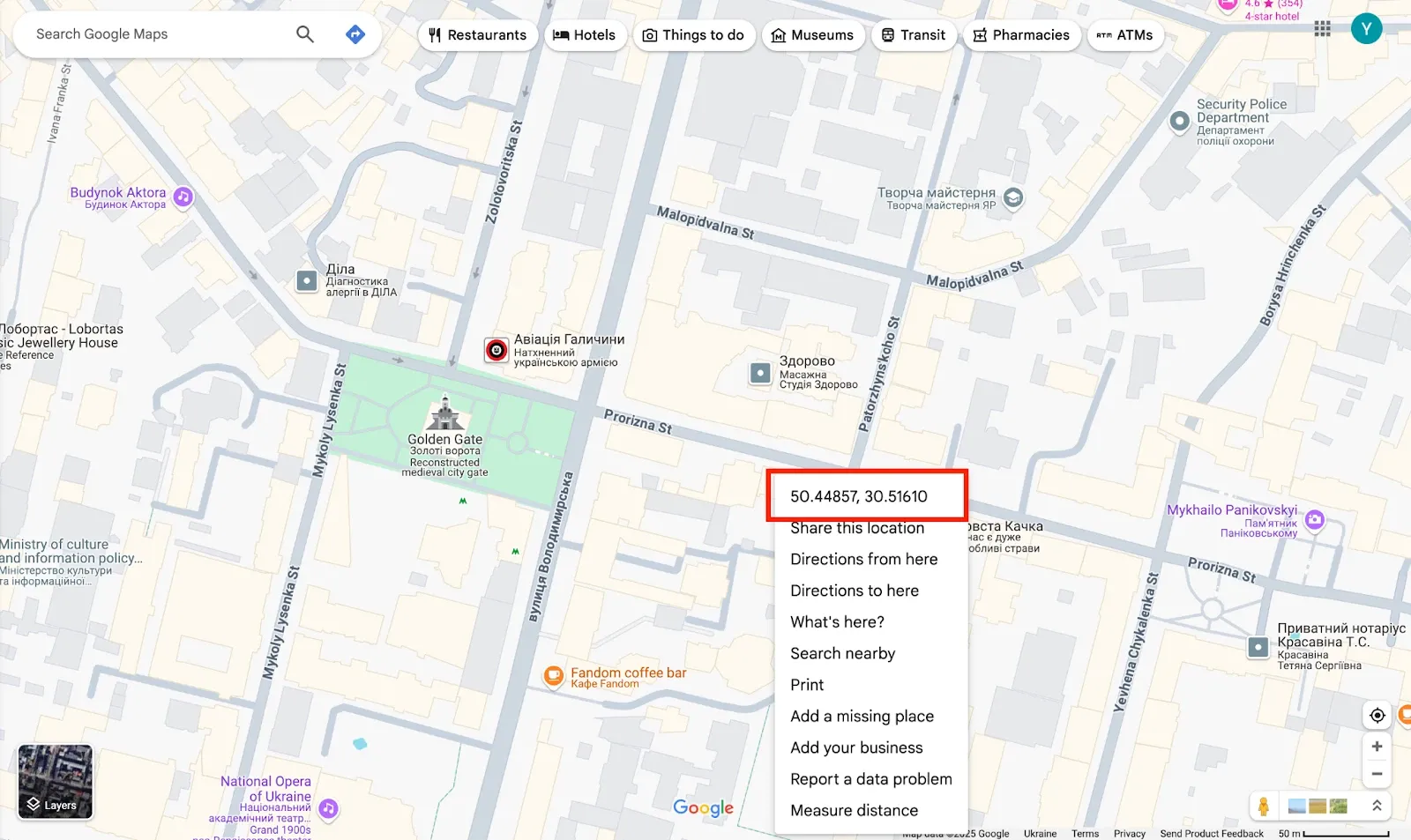

How can I get coordinates?
You can find the latitude and longitude by searching for the location on Google Maps then right click on the location on Google Maps and you will see the latitude, longitude. Copy (by right click on it) and paste this into the Longitude, Latitude field.
Copy coordinates on Google Maps
Figure 10: Copy coordinates on Google Maps
