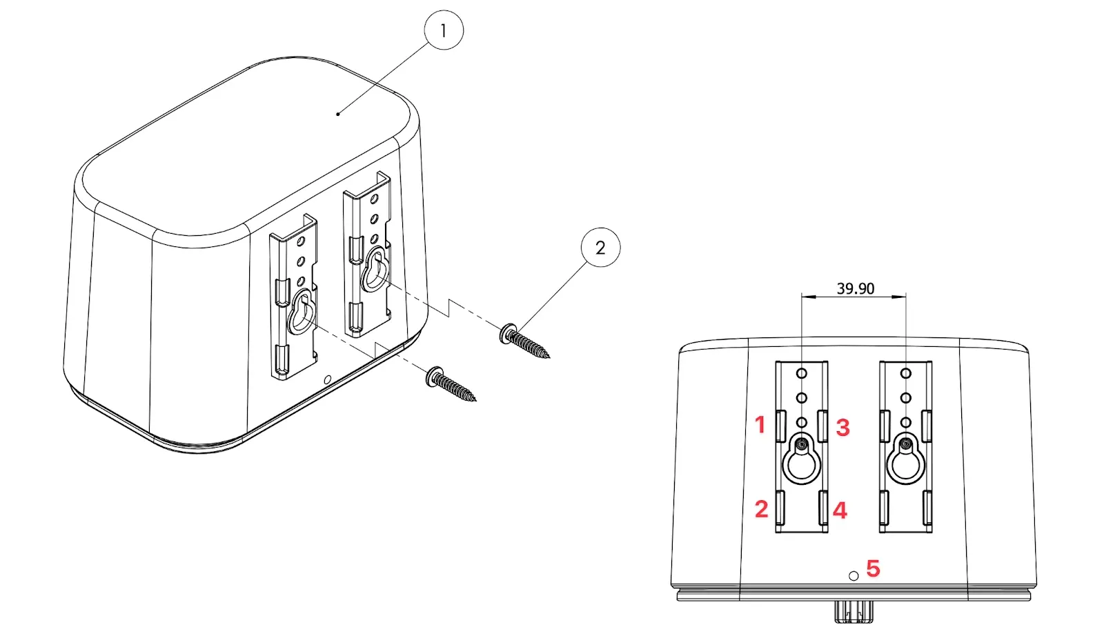

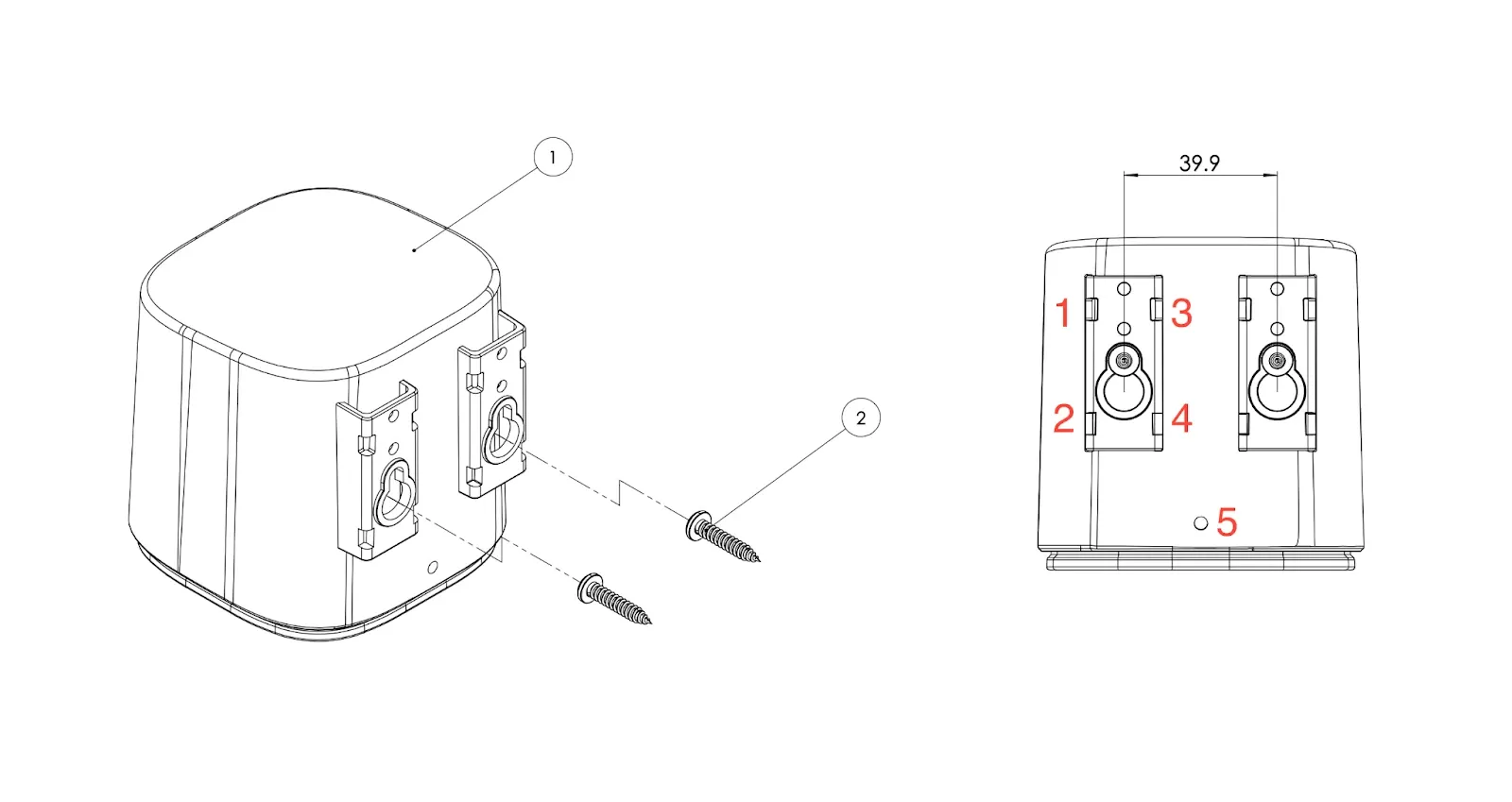

For temporary installations, cable ties, sturdy string, or wires can be passed through the four holes on the sides of each bracket (marked 1-4 on the image above). This method is best suited for mounting the device on poles, fence posts, or any other object to which the monitor can be tied. We recommend cable ties or wire for this method, as they won’t degrade significantly due to weather conditions. The cable ties or wires do not come with the monitor toolkit.
For permanent installations, or when installing the device on a flat surface where cable ties or wire can’t be used, we recommend using the two large screw mounts (located 39.9mm apart) and drilling two M4 screws into the surface with the screw heads sticking out. The monitor can then be mounted on these heads and pushed down to ensure a solid mount. When removing the monitor, push it up before pulling it off the wall.
For additional security, each Open Air features an additional hole for screws at the bottom (marked 5 on the image above) of the monitor. This slow is intended to be used as a theft deterrent and will ensure the monitor can’t be quickly removed from its mounting position.

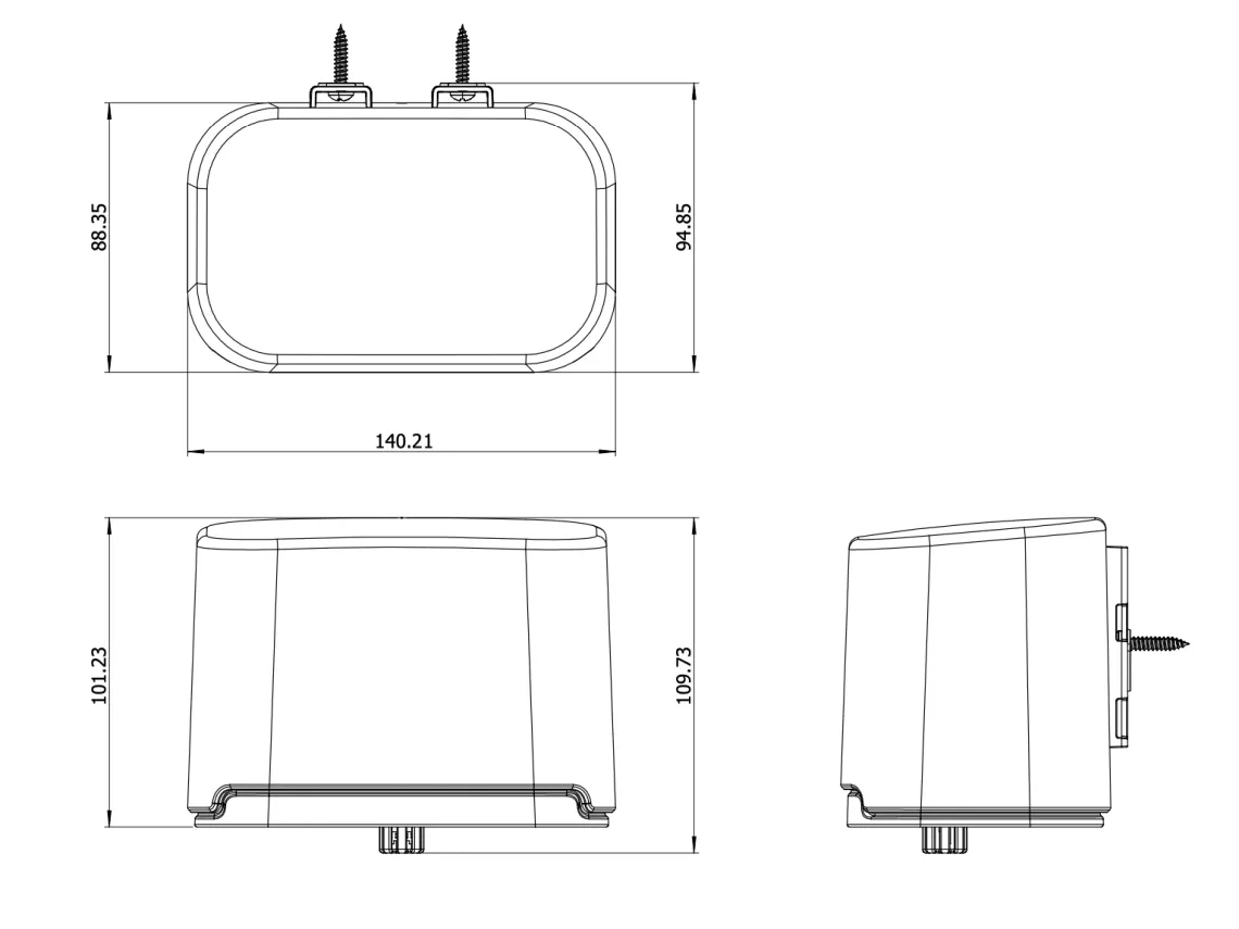

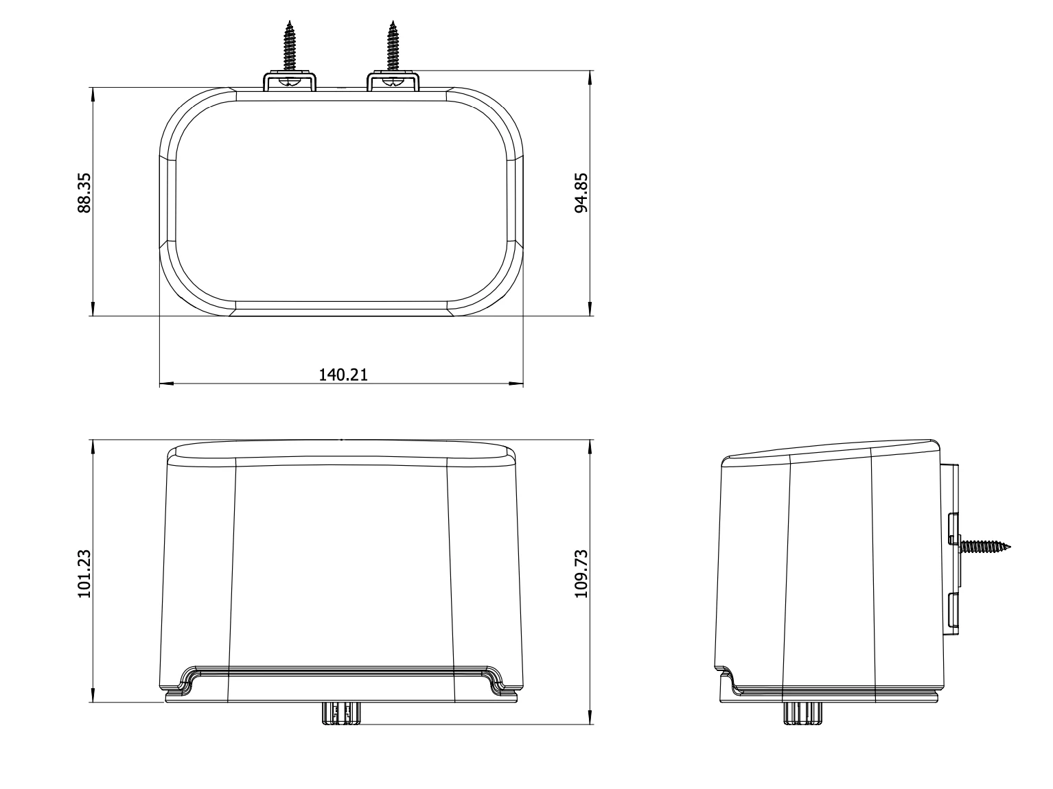

Below is a diagram showing the full dimensions of the Open Air and how it will look when mounted with M4 screws. Please note the screws should first be screwed into the surface which you want to mount the monitor on.
Full Dimensions of the Open Air

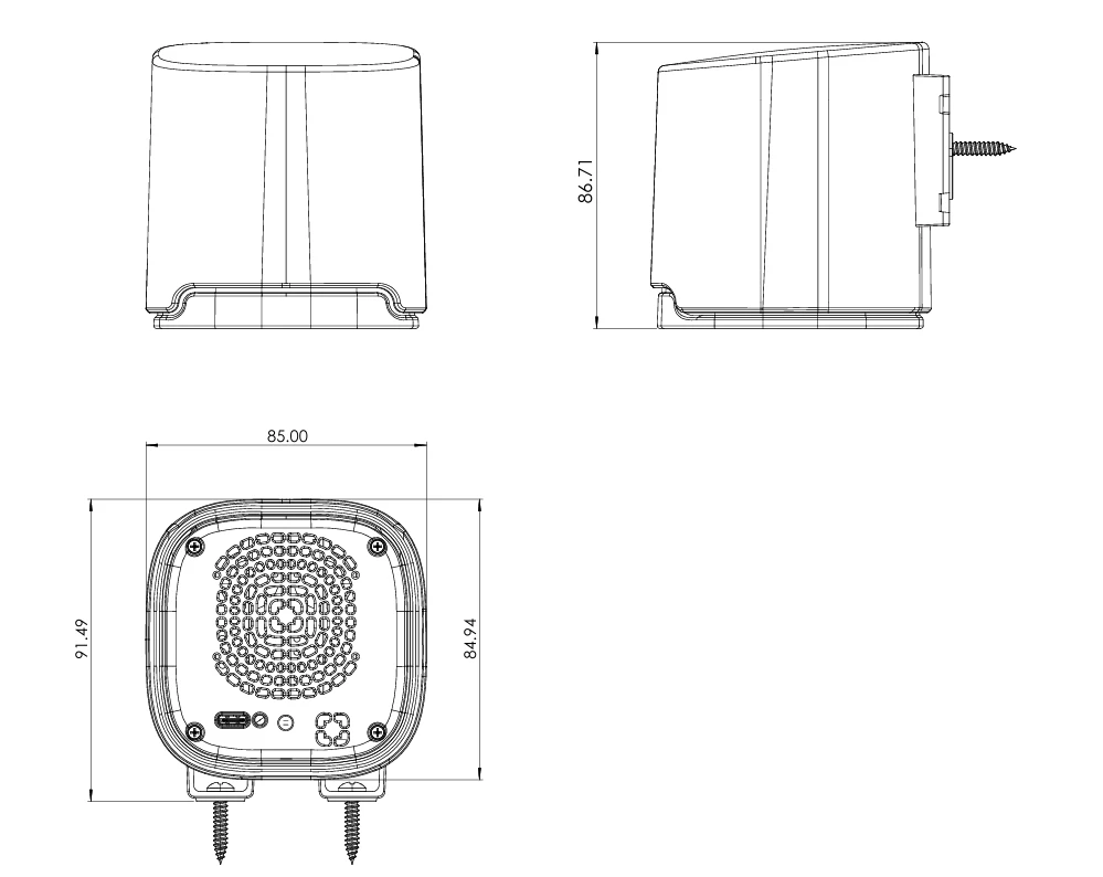

Full Dimensions of the Open Air Max
The Open Air Max has two mounting brackets on the back of the device, but it can be mounted using the same methods as the Open Air. The only key difference is to ensure that the Open Air Max is securely mounted, as the extra weight can make it more prone to falling - especially in extreme conditions.
