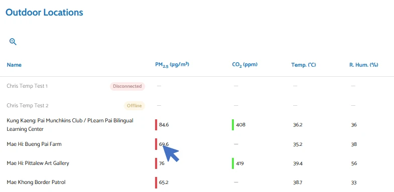

1.1. Visualise Timeplots on the Dashboard

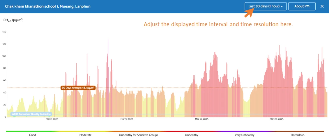

You can directly visualize timeplots of your air quality data on the dashboard. For example, a time plot will open when you click on the measured value of any monitor.
outdoor locations table
Example of a time plot visualised on the Dashboard:
adjust interval
Color code: High PM2.5 values indicate an increased health risk. This risk is visualized in the Dashboard time plots using a color code based on the Ambient Air Quality Standards of the U.S. Environmental Protection Agency (EPA) and the air quality guidelines of the World Health Organization:
color code
Additionally, you’ll see a horizontal line representing the target maximum concentration from the World Health Organization’s Air Quality Guidelines. Keep in mind that this WHO guideline refers to an annual average, while the Dashboard may display data over shorter time periods, such as daily values.

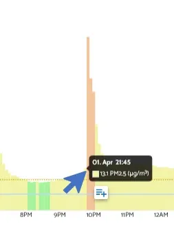

1.2. Adding notes to your Dashboard timeline
Sometimes, it is useful to save some information about events that might influence the readings of your sensor. For example, when a wildfire breaks out nearby, or your neighbour is having his Sunday BBQ.

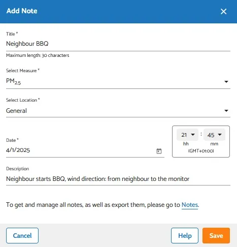

Click on any point in the displayed time series to add a note. Then, a window will pop up where you can add the details of your event.
data to note
add note form

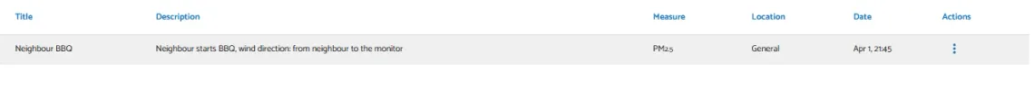

Once you have entered and saved the information, a note will appear on your timeline and in the “Notes” section, which you can reach via the hamburger menu on the left.
Note in Chart
Note in Chart
Notes Table
Notes Table

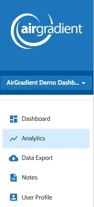

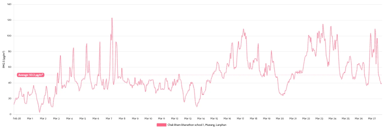

1.3. Visualise Timeplots via the Analytics function
Another way to display time plots in the Dashboard is to use the “Analytics” function.
menu item analytics
In this function, you can customise the time period that you want to have displayed. The same data as shown above ( example graph for a timeline plotted by the Dashboard) looks like this in the Analytics feature:
pm line chart one monitor
Instead of bars, a line is used to visualise the change in concentration. Both graphs present the same information, though.

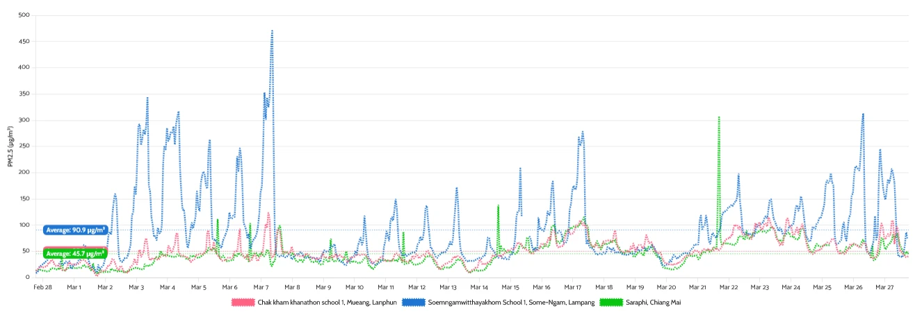

  1. Compare multiple monitors with each other.
    In the “Single parameter mode” of the Analytics function (default mode), you can compare the measurements of multiple monitors ( as long as the same pollutant is selected). This can, for instance, be useful in comparing air pollution across different locations.
line chart 3 monitors

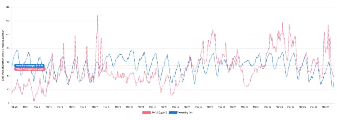

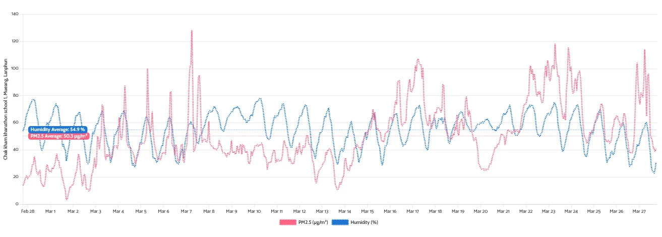

  1. Compare multiple parameters with each other.
    In the “Multi parameter mode” of the Analytics function (switch button is in the top right corner), you can compare the measurements of different sensors (e.g. Temperature and PM) within one monitor. This is, for instance, useful to assess the impact of environmental factors like temperature on your readings.
pm and humidity chart

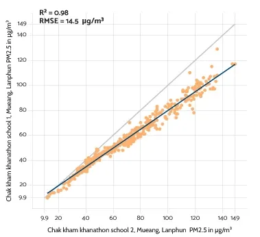

3. Scatter Plots
Scatter plots help explore the connection between two variables or monitors. Each point on the plot represents a pair of measurements taken at the same time. This visualization is often used for calibration—checking how closely a low-cost sensor follows a reference monitor—or for data quality assurance. If the points lie neatly along a line, that's a good sign: it suggests a strong correlation. If the points are widely scattered, it may be necessary to find out why the two readings differ.
You can use the automatic calibration tool to create scatter plots on your dashboard. Go to Chapter S8 to find more information on this (Section 4.3: Automised Calibration Tool).
Scatterplot of the PM 2.5 measurements of two co-located AirGradient monitors in Thailand, visualised by the calibration tool.
Scatterplot of the PM2.5 measurements of two co-located AirGradient monitors in Thailand, visualised by the calibration tool.

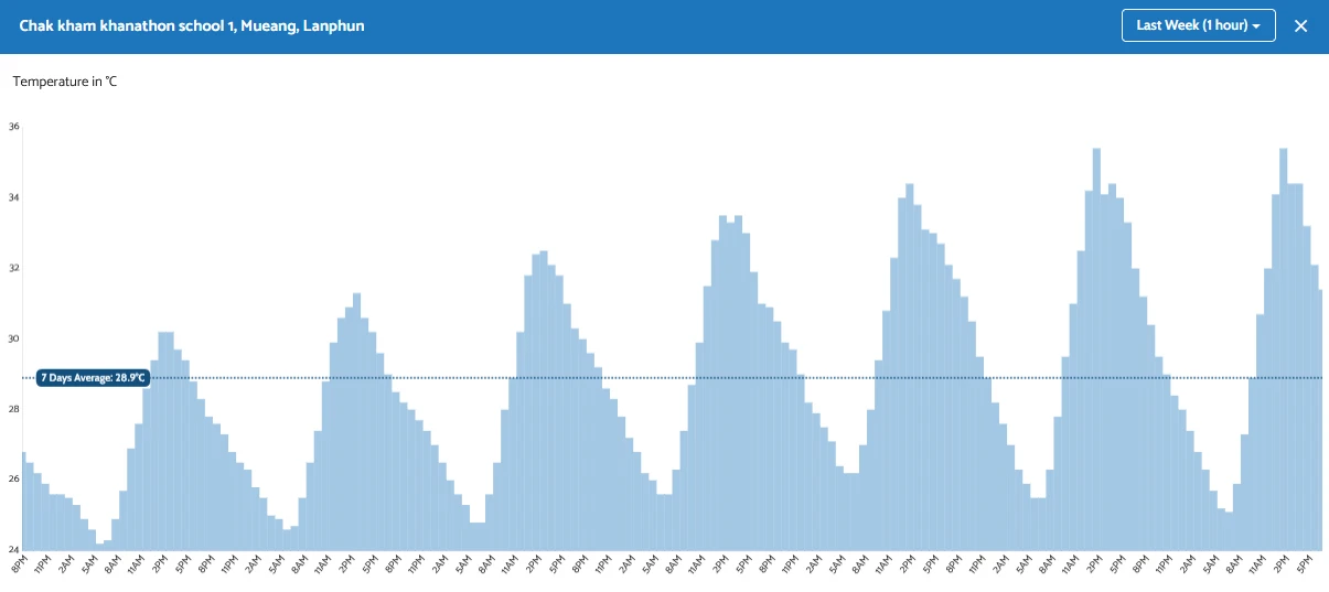

{.accent-text} Air quality often fluctuates throughout the day due to changes in human activity and environmental factors. For instance, in urban areas, pollution levels tend to spike during morning and evening rush hours due to increased vehicle emissions. Temperature differences between day and night also influence air quality: hotter daytime temperatures can increase ozone levels, while cooler nighttime temperatures can cause pollutants to settle closer to the ground, temporarily increasing concentrations.
Daily trends in data can be very clearly seen in temperature readings. This is an example of the temperature variations in Chiang Mai, Thailand.

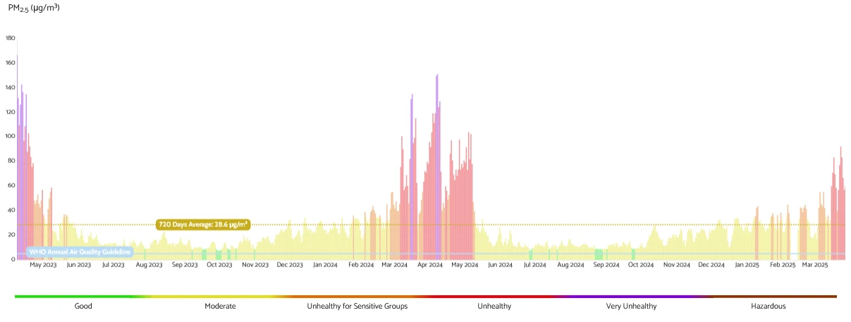

5.3. Seasonal Patterns
Long-term data reveals broader seasonal trends, often tied to weather conditions, agricultural practices, and regional events. For instance, in northern Thailand, particularly Chiang Mai, **air quality deteriorates sharply during the dry season (March–May)** due to widespread **wildfires and agricultural burning** — a period commonly referred to as the “**wildfire season**.” This seasonal phenomenon leads to prolonged periods of high PM2.5, often pushing air quality concentrations to unhealthy or hazardous levels.
Seasonal changes of air quality in Chiang Mai. “Wildfire season” is around March, April, May.

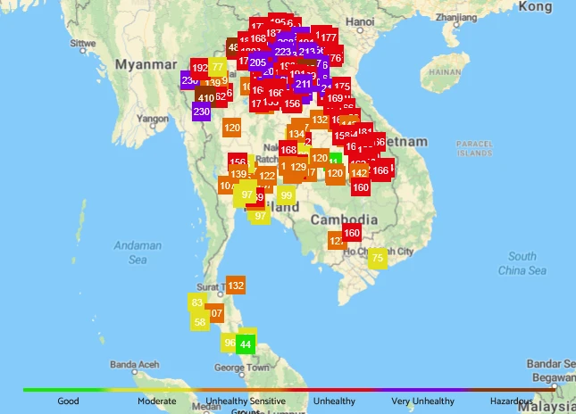

6.1. Pollution Hotspots & Emission Sources
Some areas consistently show higher pollutant levels due to specific activities or geographic features. For instance, **industrial zones** often record elevated levels of air pollution due to emissions from manufacturing, power generation, or processing plants.
Wildfires in the north of Thailand affect the whole country
