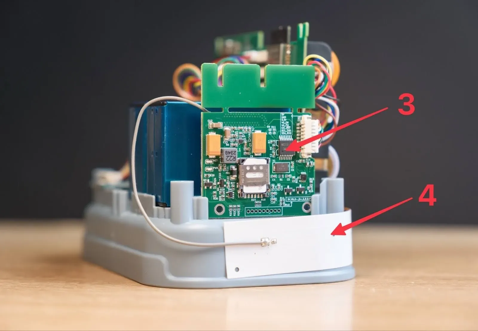

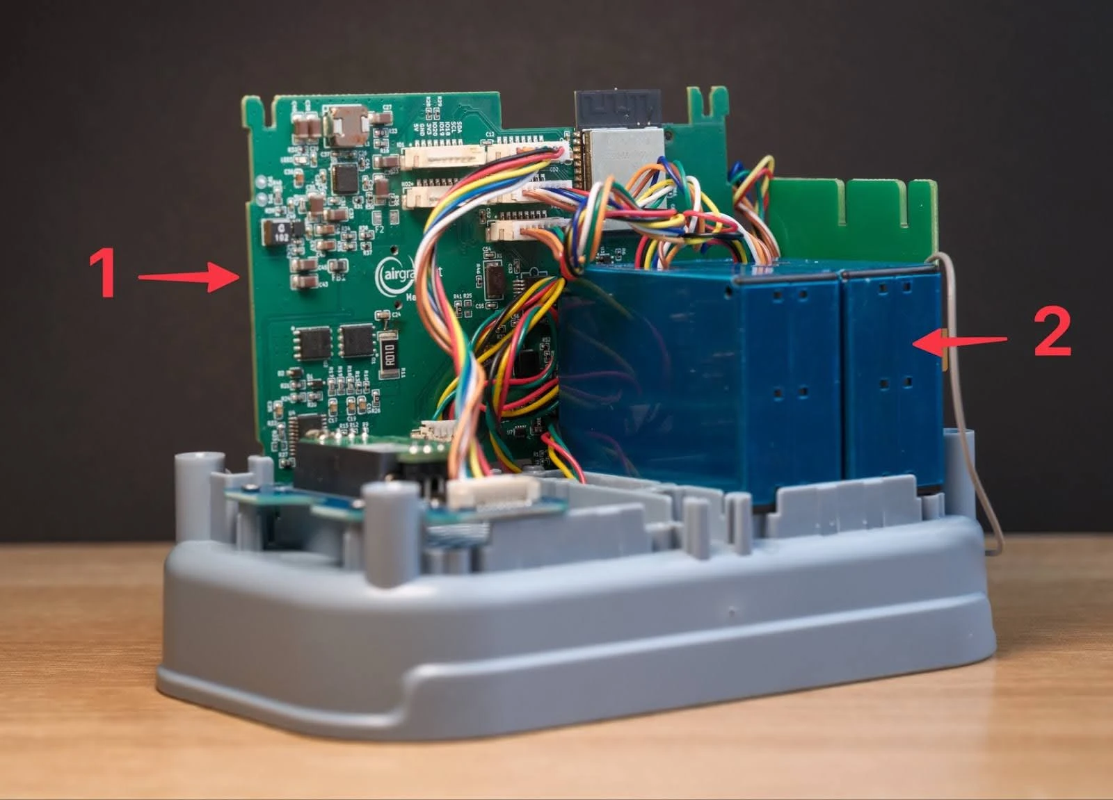

  1. Mainboard (the main PCB of the device with the USB port and connectors to the sensors).
  2. PMS5003T particulate matter sensor (a large, blue box that is connected to the mainboard). This is the most likely component to need replacement as it has moving parts (a fan) inside.
  3. Cellular card (this contains the SIM card that can be changed)
  4. Cellular antenna

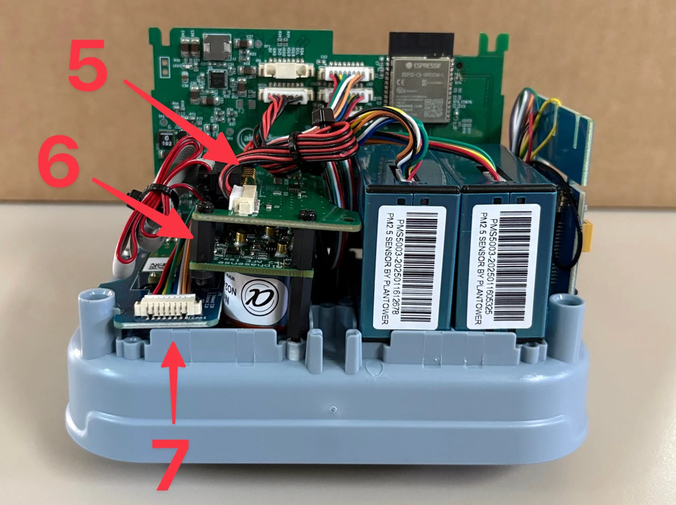

  5. Alphasense NO2 module (this is only found on the O-M-1PPSTON model, not the O-M-1PPST model)
  6. Alphasense O3 module (this is only found on the O-M-1PPSTON model, not the O-M-1PPST model)
  7. SenseAir S8 CO2 sensor (a sensor that sits next to the PMS5003T and is mounted on its own board. It is connected to the mainboard via a ribbon cable).

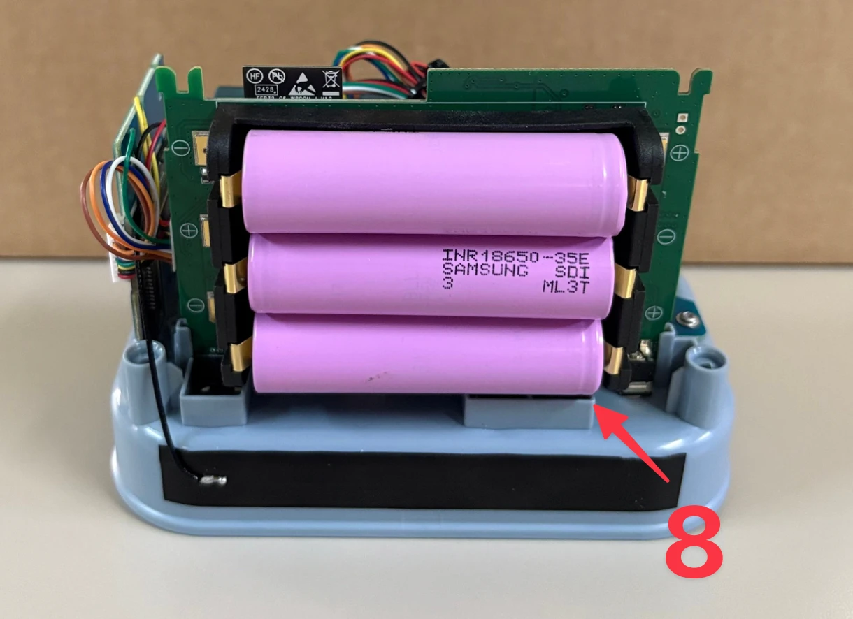

  8. Battery cells (18650 batteries)

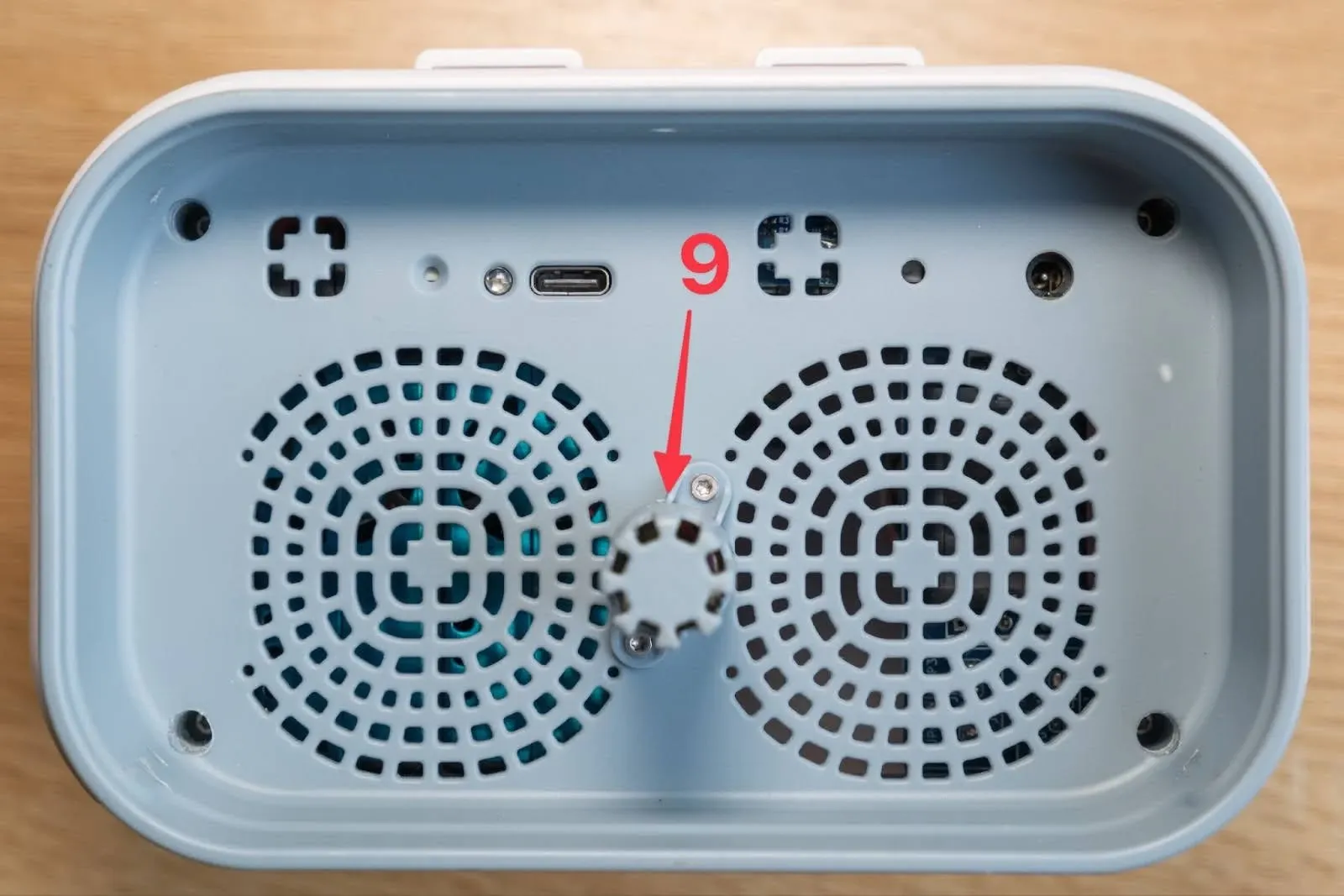

  9. SGP40 VOC sensor

components 1 2
components 3 4
components 5 6 7
component 8
component 9
Any of these components can be removed and replaced if there is an issue. Replacement is as easy as unscrewing the faulty component and replacing the new part in the same way. However, there are a few considerations to keep in mind:
